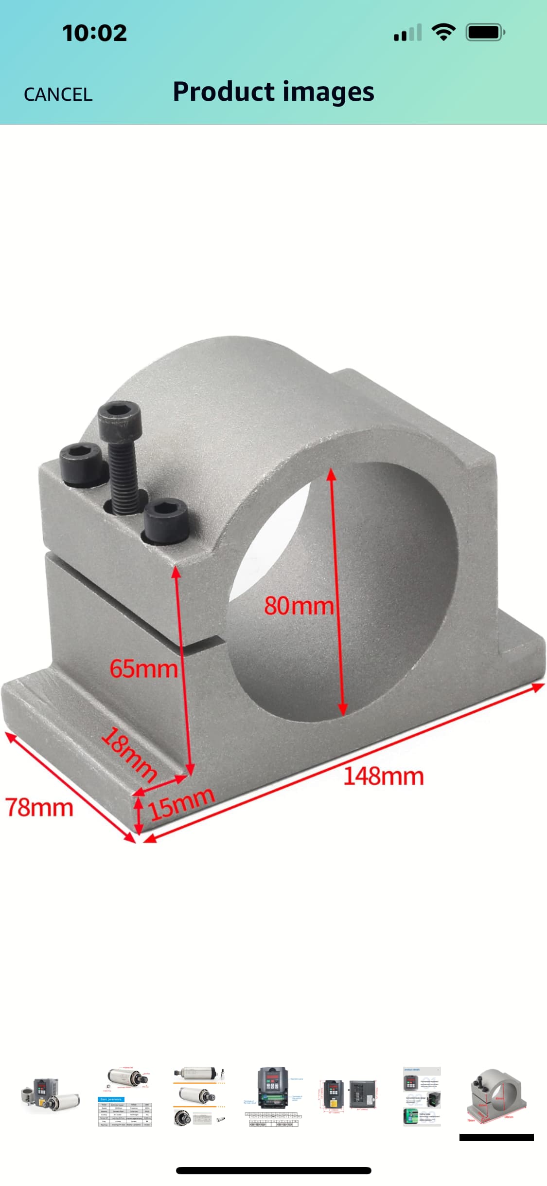

I have ordered a 2.2kw spindle for my Foreman. The kit comes with the spindle, VFD, Cable and 80mm mount. The mount doesn’t look like it will work on my machine. Do I need to order the one from Onefinity?
 ![IMG_3627.PNG](https://us1.discourse-cdn.com/flex022/uploads/onefinitycnc/original/3X/c/e/ce09abb1dec5eedcefa7b1f7a50c2599a3c4e543.jpeg)
 ![IMG_3628.PNG](https://us1.discourse-cdn.com/flex022/uploads/onefinitycnc/original/3X/a/d/adef360b3d3c853c2763d64141c26fba8a2a677d.jpeg)
**Post date:** [November 24, 2023, 3:20pm UTC](https://forum.onefinitycnc.com/t/80mm-spindle-need-to-order/23522/6 "2023-11-24T15:20:28Z")
Yes you will. That mount will not fit.
