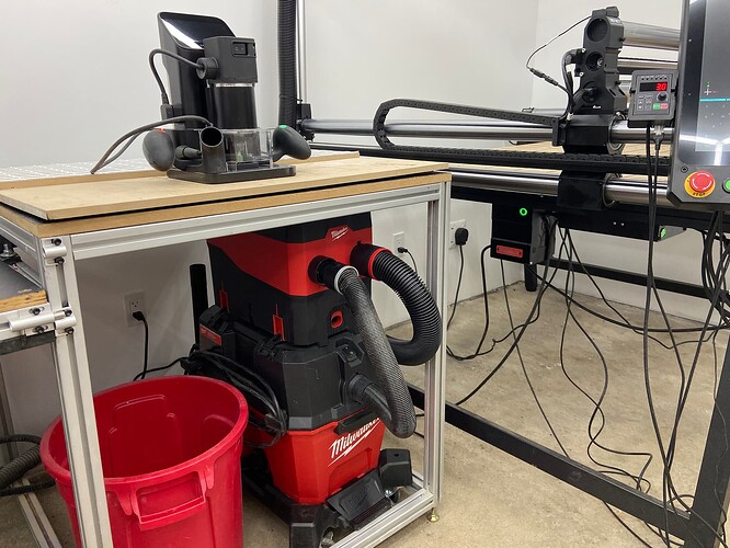

I setup a hose boom today on my Elite Foreman.
I ordered a 16’ 2.5" hose for my Milwaukee 6.5hp vacuum with the Milwaukee packout debris separator and it works beautifully.
I just used 1" aluminum tubing with a 90 degree electrical conduit elbow. I plan to paint it black this weekend. The pole was mounted into the Rowdy Roman mount that I 3D printed myself.
