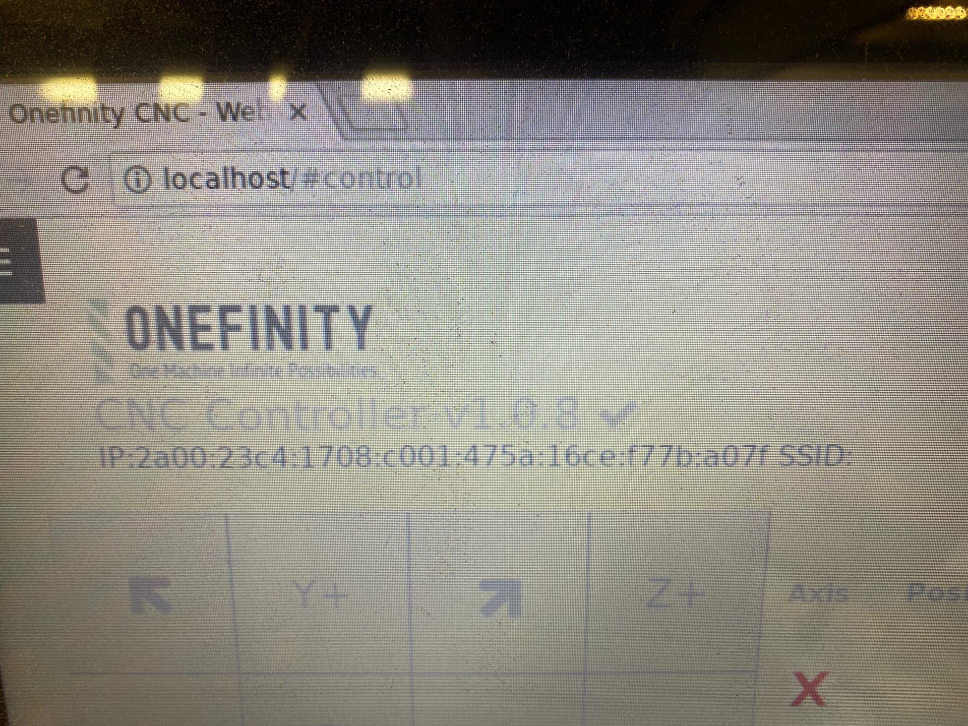

**Post date:** [November 27, 2021, 5:51pm UTC](https://forum.onefinitycnc.com/t/another-wifi-post-but-slightly-different/7744/8 "2021-11-27T17:51:48Z")
Hi All
Right i have given up with WIFI, and during the black fridays deal got a good deal on a wifi extender with network cable out.
set it all up today and all was going fine, onefinity got IP address i could see the machine on my router but i cannot get to the front end.
I can SSH to it from my PC and i can ping my PC, Google, and my router. from my PC I can ping the 1F machine.
but when i go to the web page either using IP address or onefinity.local (and make sure its only HTTP) its just spins around and around.
this is the ifconfig from 1F
 ![image](https://us1.discourse-cdn.com/flex022/uploads/onefinitycnc/original/3X/e/0/e0ab943ab406e9ef7c78fde82fb78c255113a1e5.png).
now the strange thing is that on the onefinity it shows the IPV6 address not the IPV4.
im fairly tech savy but i dont want to go poking around and disabling IPV6 if there is another solution.
so throwing it out there any help much appreciated.
also my ARP table on my PC did have multiple entries for the 1F so i have removed the incorrect entries and now its just the correct one remaining
 ![image](https://us1.discourse-cdn.com/flex022/uploads/onefinitycnc/original/3X/0/8/086e6b715ca6a9b73d80c92f230a2bf9b4bf4731.png)
 ![image](https://us1.discourse-cdn.com/flex022/uploads/onefinitycnc/original/3X/b/7/b7050a7fe9076e7c1ffd94e491cd9626428453bb.jpeg)
**Author:** ![tauras](https://avatars.discourse-cdn.com/v4/letter/t/8c91f0/32.png) [@tauras](https://forum.onefinitycnc.com/u/tauras)\
**Post date:** [February 15, 2024, 6:54pm UTC](https://forum.onefinitycnc.com/t/another-wifi-post-but-slightly-different/7744/9 "2024-02-15T18:54:59Z")
I have similar issues…
I just upgraded to V1.3.1 and noticed that I have an IPv6 address.
How do I get to this address via my PC?
Can I tell the OneFinity to only used IPv4?
