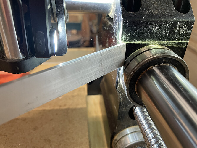

I know this is an older topic but I think I might have something to add… When you square your machine, and get it all clamped in place and you’re ready to screw it down, what happens??? For me, the screw was at an angle and that forced the machine out of square as I drove the screw home. All that time wasted… I know I could have gotten an extension for my drill but I love to create solutions to problems that are much more elaborate than the original problem - especially when it involves using my 1943 Southbend lathe. So I made this tool to drill pilot holes precisely in the center of the the mounting holes.
 ![CC61E4AC-E641-4594-94D1-DF62E5EBC0AF](https://us1.discourse-cdn.com/flex022/uploads/onefinitycnc/original/3X/c/0/c0a1eb61a4636a954b013577f06ee005893692d4.jpeg)
The dimensions perfectly match the counterbored mounting holes _however_… I discovered that _some_ of the mounting holes are actually undersized - they’re not all exactly the same! Very surprising…
 ![IMG_6076.HEIC](https://us1.discourse-cdn.com/flex022/uploads/onefinitycnc/original/3X/0/c/0c23e1d88f48ffbfa6f9e0e1d0189b27c0d1d25c.jpeg)
Even with the inconsistent size in mounting holes, this solved the problem of the screw going in sideways. However, I still haven’t achieved perfection in getting the entire CNC square.

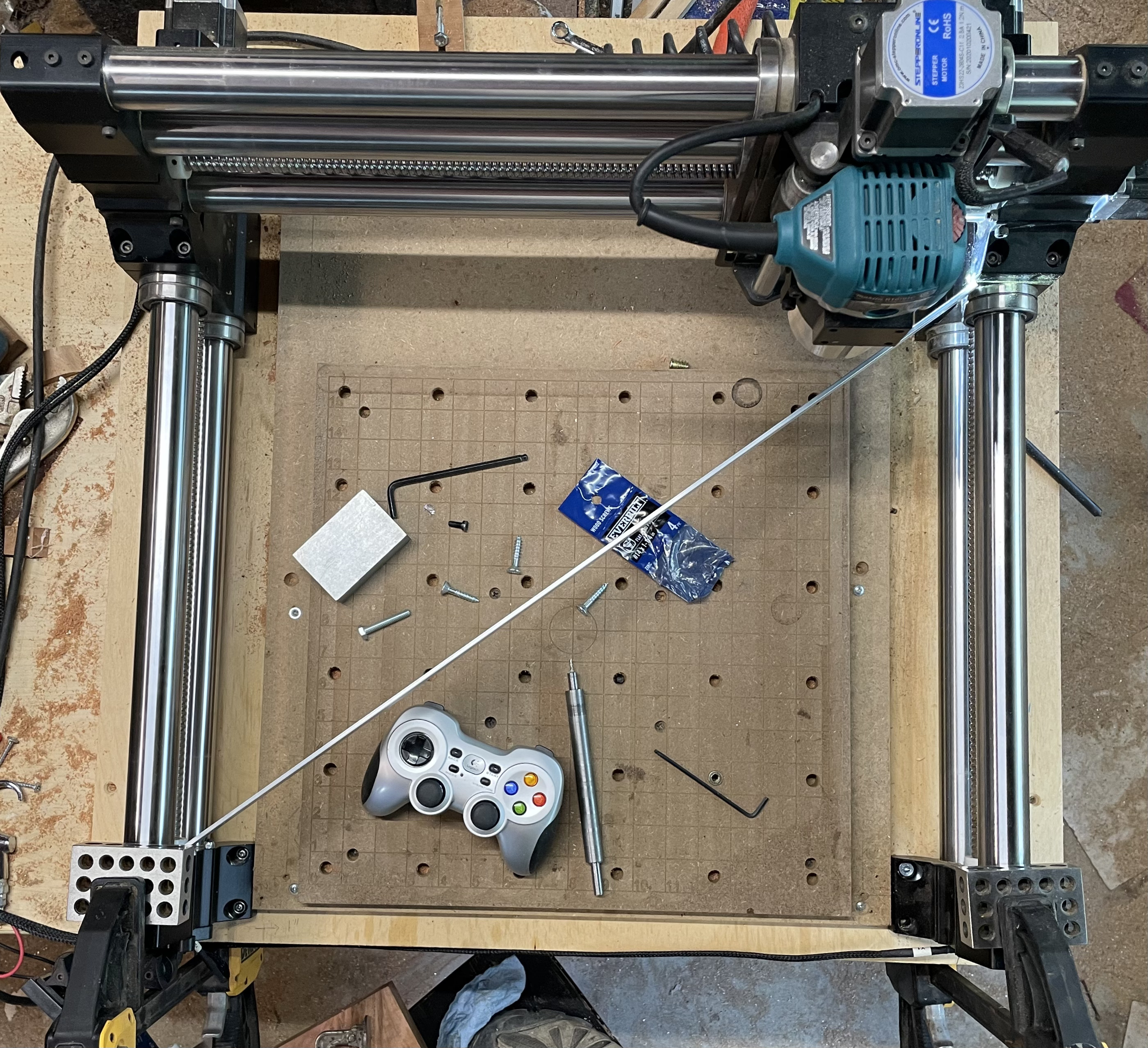

Here is my setup - I used a piece of aluminum stock as my reference and measured the diagonals as shown here.
 ![IMG_6065.HEIC](https://us1.discourse-cdn.com/flex022/uploads/onefinitycnc/original/3X/4/d/4d05b4313b2d8155d3eee98f4caa9cfcd37ac583.jpeg)
Using 123 blocks secured to the top of the frame, I could get consistent positioning of the aluminum bar in the front.
 ![IMG_6079.HEIC](https://us1.discourse-cdn.com/flex022/uploads/onefinitycnc/original/3X/0/8/08aa377beef81c7ea1cb5e3bf215ab78be3e65f0.jpeg)
 ![IMG_6072.HEIC](https://us1.discourse-cdn.com/flex022/uploads/onefinitycnc/original/3X/3/9/399d6e151957c2759cf1ba1a32d60e4f12745415.jpeg)
And I used a feeler gauge in the horizontal seam shown here to ensure the back side of the bar was consistent on both sides.
 ![IMG_6066.HEIC](https://us1.discourse-cdn.com/flex022/uploads/onefinitycnc/original/3X/a/1/a193ed16090038814d1649aa41663d28479ccef8.jpeg)
 ![IMG_6070.HEIC](https://us1.discourse-cdn.com/flex022/uploads/onefinitycnc/original/3X/2/f/2f2653ccc4872af99b8f2e40637997d1f9dbeb3c.jpeg)
Using this technique I managed to get the machine pretty square before driving the screws home however when I ran a test using a 6,8,10 triangle, it was still off by about 1/32" on the hypotenuse…
Going to try again using the aluminum bar down at the feet of the frame instead of the top of the frame but I’m not expecting much better results.
I’m still in search of a better method however (and this is where I think I may have a novel idea based on all I’ve read in this forum) it occurred to me that you might achieve very good results if you had someone with a larger machine than yours, and known to be dead nuts square, mill your mounting board with all the mounting holes pre drilled to the exact dimensions of your machine. This _seems_ like a good idea but I’m looking for holes in my on logic.

Also I would check if the black aluminium extrusion feet are really at the same distance on left and right Y axis before assembling.
**Author:** ![tgunr](https://sea2.discourse-cdn.com/flex022/user_avatar/forum.onefinitycnc.com/tgunr/32/10947_2.png) [@tgunr](https://forum.onefinitycnc.com/u/tgunr)\
**Post date:** [May 7, 2025, 4:03pm UTC](https://forum.onefinitycnc.com/t/before-you-setup-your-woodworker-an-alignment-guide/8919/19 "2025-05-07T16:03:14Z")
Excellent point, I was going nuts trying to get my Journeyman square when I finally went to check the length of the bars. One side as 1mm longer than the other so I always was working with one hypotenuse longer than the other, At least that’s what I’m thinking right now and the idea of using bolts this time rather than screws would take care of getting things out of line when finally mounting,
