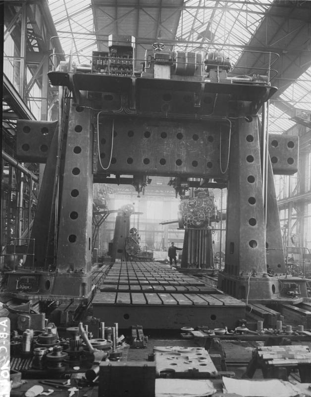

Gantry:
A gantry rather means the entire X axis and its two feet running on top of the Y carriages, as a gantry is defined as…
an overhead bridge-like structure supporting equipment such as a crane, signals, or cameras.
– Source: Gantry – Wikipedia
A framework of steel bars resting on side supports to bridge over or around something.
– Source: Gantry – Wiktionary
In the CNC field, there exist types with different arrangements of the axes. One is the gantry-type cnc, which is defined as having the X axis as a bridge that runs on two Y axes, which usually makes necesary two Y motors. The X carriage runs on the X axis and holds the Z assembly.
– Source: Kief, Hans B., Roschiwal, Helmut A., and Schwarz, Karsten: CNC-Handbuch, 31., überarbeitete Auflage 2020, Carl Hanser Verlag, München
Image: The description of a gantry-type CNC machine in a German textbook on CNC machinery (please don’t be confused by the fact they use X for Y and vice-versa, and that they have an additional W axis with which you can lower and higher the entire X axis to accomodate different workpiece heights.)
Bundesarchiv, Bild 102-10412 / CC-BY-SA 3.0, CC BY-SA 3.0 DE, via Wikimedia Commons
Image:
Gantry milling machine from Schiess Defries
A giant work of German engineering!
A view through a gantry milling machine for machining large workpieces. This giant machine is able to pick up and machine workpieces up to 4.5 m wide and high, as well as 24 m long. This gigantic machine, a product of the Schiess Defries company, is unique in the world.
Date September 1930
Source: Author unknown, Bundesarchiv
