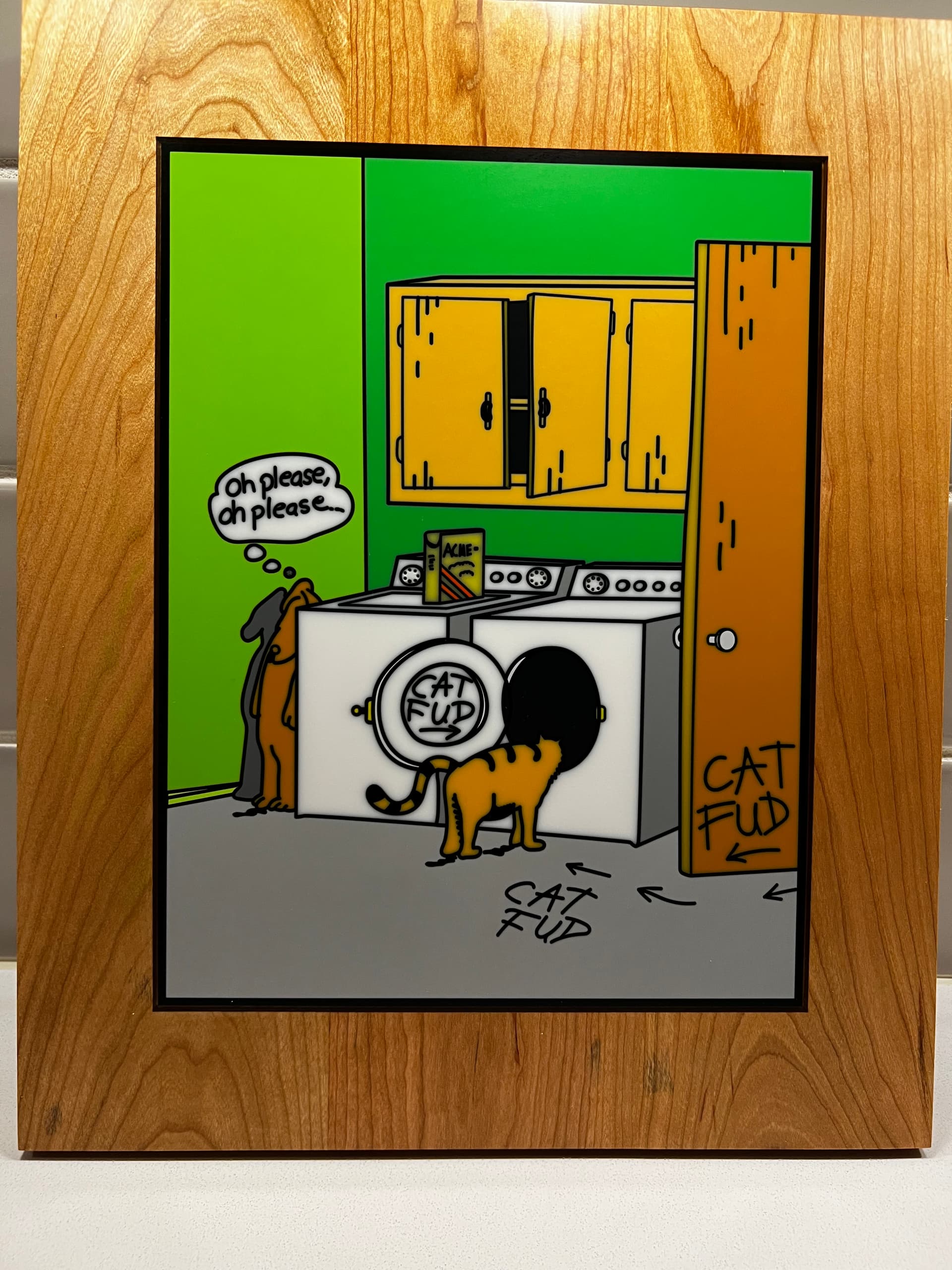

also keep in mind that your test peices are pine, which is probably the least epoxy friendly wood there is! Sealing and a torch will help immensely, not to mention the fact that fire is awesome! Here are some of the pieces I did…

What pigments are you using for those?

I use these [Mixol](https://www.amazon.com/gp/product/B003FHR3V4/ref=ppx_yo_dt_b_search_asin_title?tag=benmyers-20) tints these days, and various brands of mica powder when I need to add some sparkle. Before I invested in the Mixol tints, I used craft acryllic paints which worked well also. The Panther one is acrylic paint, and a great option when getting started as long as you dont use too much (too much will prevent a proper cure). Another advantage to acryllic when getting started is that you can easily find a color you need to match using this kit: [Acrylic Paint Kit](https://www.amazon.com/gp/product/B082HK57QB/ref=ppx_yo_dt_b_search_asin_title?tag=benmyers-20)
