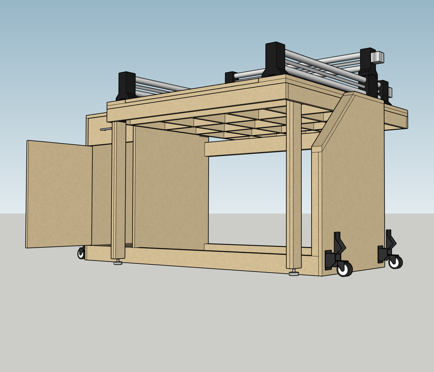

**Author:** ![nduvieilh](https://sea2.discourse-cdn.com/flex022/user_avatar/forum.onefinitycnc.com/nduvieilh/32/351_2.png) [@nduvieilh](https://forum.onefinitycnc.com/u/nduvieilh)\
**Post date:** [September 11, 2020, 7:57pm UTC](https://forum.onefinitycnc.com/t/cnc-platform-table-enclosure/210/16 "2020-09-11T19:57:07Z")
Just finished up my design for a fold down cart too. Planning to work on it some this weekend.
 ![2020-09-11 09_00_34-Window](https://us1.discourse-cdn.com/flex022/uploads/onefinitycnc/original/3X/3/8/3884f57ccd2e9263d9f9aeb40864aa24c9b6903d.jpeg) ![2020-09-11 09_01_28-Window](https://us1.discourse-cdn.com/flex022/uploads/onefinitycnc/original/3X/e/f/efed94ce3653c90a374783ed83edbf68c589ade5.jpeg) ![2020-09-11 09_05_00-Window](https://us1.discourse-cdn.com/flex022/uploads/onefinitycnc/original/3X/a/2/a2f9d00ee415f3fbd7bcc307abe721fec3427c70.jpeg)
Gotta hurry up, machine will be here in a few weeks.
**Author:** ![mkngjoy](https://sea2.discourse-cdn.com/flex022/user_avatar/forum.onefinitycnc.com/mkngjoy/32/225_2.png) [@mkngjoy](https://forum.onefinitycnc.com/u/mkngjoy)\
**Post date:** [September 13, 2020, 7:02am UTC](https://forum.onefinitycnc.com/t/cnc-platform-table-enclosure/210/17 "2020-09-13T07:02:08Z")
Love the idea of these builds!
One possible concern (@Cdavis also mentioned something similar) with the designs here is that the cables to go from the controller box all the way to the far right Y rail are not currently long enough to reach from the cabinet (as shown in the 3d design) when in the “folded” position. That said, the cables should be simple enough to fabricate your own, as long as you get the right connectors. The way the cables are shipped - having the control box on the front-left next to the machine is pretty much the only place it can be installed, or within 6" or so of that location.
I just measured the far-right Y cable on my installed machine, and it’s about ~66" long. in the folded position - you’d need that cable to be more like 126" long ( 48" front edge + 48" left side edge + 30" back to control box) if the control box was mounted on the top of the cabinet. possibly different depending on where you intend to install the control box. The other Y axis cable is ~25-26" for reference, which would also need to be an additional ~70" longer.
**Author:** ![garrett1812](https://avatars.discourse-cdn.com/v4/letter/g/ba9def/32.png) [@garrett1812](https://forum.onefinitycnc.com/u/garrett1812)\
**Post date:** [September 13, 2020, 12:22pm UTC](https://forum.onefinitycnc.com/t/cnc-platform-table-enclosure/210/18 "2020-09-13T12:22:57Z")
If you flip the Y rails around, so the cables attach in the rear, you would need much less cable. Maybe would work with stock cables.
