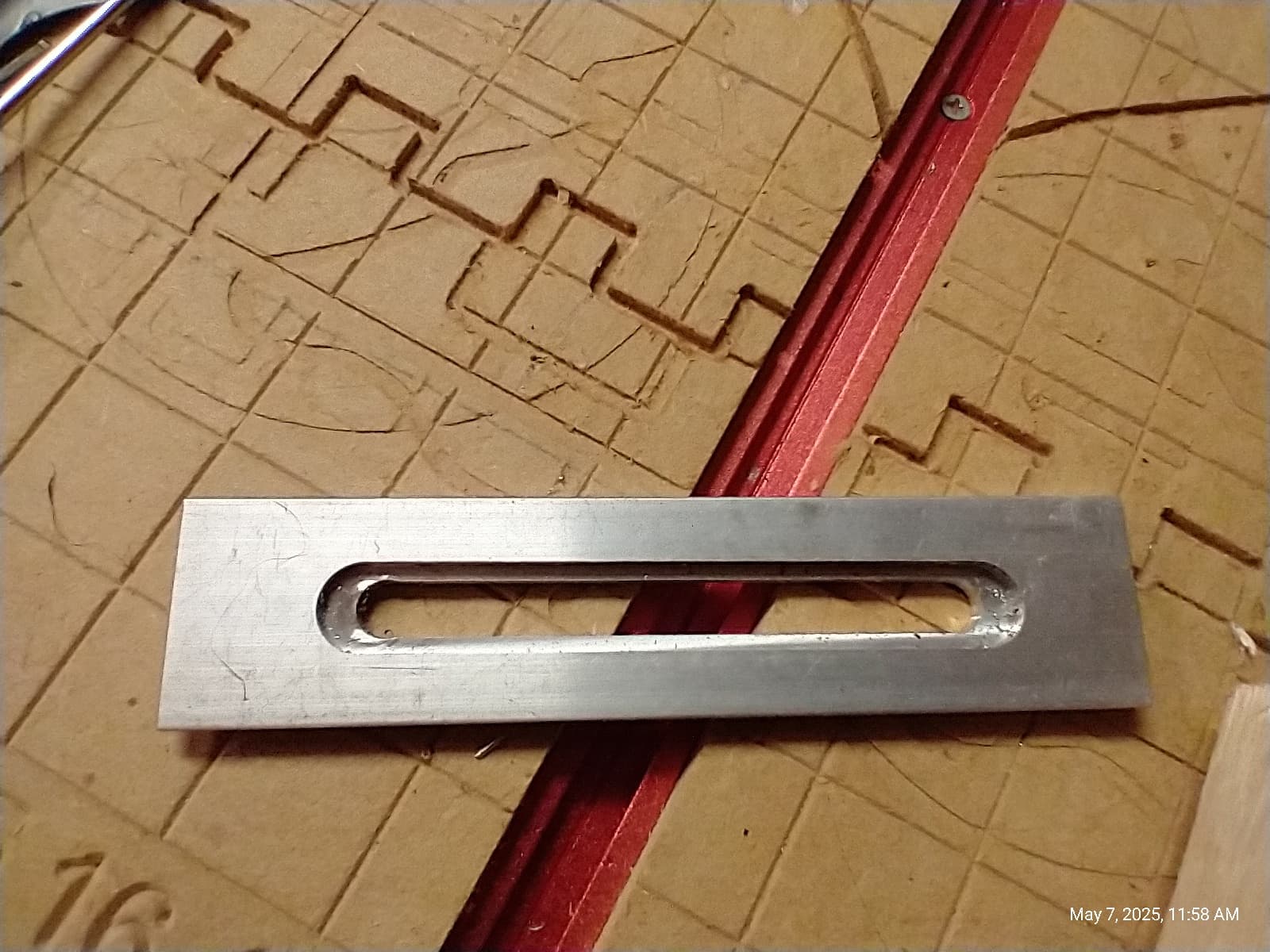

Now that I have had 2 successful launches of smaller pieces I have turned my attention to mechanical fixation. Even the best double sided tape and 2" brad nails were no match for an upcut bit!
Did you machine those aluminum bars on your onefinity? And if so, how did you hold THOSE down? It’s like clamp Inception.
I feel like these are a way better approach than the usual ‘dogleg’ aluminum track clamps. It looks like you have regular tee nuts in the track?..

@HardtailSr Nice clamps. I’m also interested in how you made those. I like the rigidity of aluminum, but also like the forgiveness of plastic.

### Author: ![HardtailSr](https://sea2.discourse-cdn.com/flex022/user_avatar/forum.onefinitycnc.com/hardtailsr/32/35326_2.png) [@HardtailSr](https://forum.onefinitycnc.com/u/HardtailSr)
#### Post date: [May 7, 2025, 2:57pm UTC](https://forum.onefinitycnc.com/t/crash-prevention-built-into-dust-boot/32623/10 "2025-05-07T14:57:17Z")
I did the ends on the onefinity yes but the center slot I did on my mill because I was unsure that the onefinity could handle the gumming up problem but with a 0 flute bit made especially for aluminum it should be fine. As you can see in the pictures I made a holder for the bar and then clamped it to the machine table and so I would be able to just repeat the function over and over. A sort of nest /jig. The trick to keeping the clamps low is twofold. Having the t nuts with a lot of collar (the threaded barrel of the t nut). This helps with the range of clamping and using the proper length of low head screws. I bought several sizes that I keep in separate compartments of a small parts holder and finally at the hind end of the bar, just use a piece of material the same thickness as the workpiece you are carving. Doing it this way the height of the entire clamp assembly is .125 inches about the work. which is far below any z height you would program in your carve. I could take some pictures of each part and post them If anyone is interested. I could make many more of these clamps. if anyone would like them for a modest price. with the hardware included or without. Just let me know.

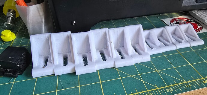

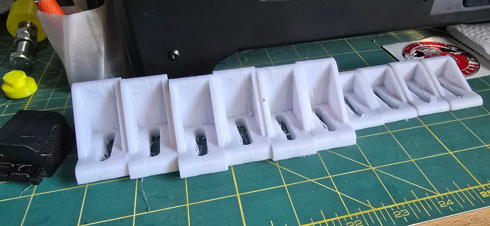

I went with your approach of low head screws pointing down, instead of long ass screws pointing up with knobs on them.
I still need to pick up sume flat bar stock to imitate your clamps, but I did print some toe clamps from the pwn guys that do have amazing down force at the price of zero reach.

### Author: ![mrkrag](https://sea2.discourse-cdn.com/flex022/user_avatar/forum.onefinitycnc.com/mrkrag/32/30927_2.png) [@mrkrag](https://forum.onefinitycnc.com/u/mrkrag)
#### Post date: [May 18, 2025, 11:09am UTC](https://forum.onefinitycnc.com/t/crash-prevention-built-into-dust-boot/32623/19 "2025-05-18T11:09:41Z")
Good call on the thumb ratchet. I was looking through my stuff for a decent hex wrench to dedicate to the clamps, I will copy this idea from you also.
Shorty printed clamps did their first bigger carve yesterday with zero play.
#### Post date: [May 18, 2025, 12:22pm UTC](https://forum.onefinitycnc.com/t/crash-prevention-built-into-dust-boot/32623/20 "2025-05-18T12:22:54Z")
