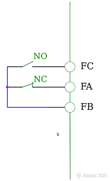

**Post date:** [July 29, 2023, 2:13pm UTC](https://forum.onefinitycnc.com/t/delayed-shutdown-of-the-24v-relay-aftermarket-spindle/21375/43 "2023-07-29T14:13:16Z")
Hey Fred,
> [@Fred11](#):
> or the terminal block does not correspond to the internal wiring
> Why fa/fc/fb and not fa/fb/fc ?
it remains mysterious why the behaviour is reversed so that PD052=02 works. Usually when a load is connected to the “nomally open” output and FB is connected to +24 V, PD052=01 should work and PD052=02 should do the inverse.
But I can only look at the PDf manual:
 ![Huanyang_HY_Series_Manual__Basic_Wiring_Diagram](https://us1.discourse-cdn.com/flex022/uploads/onefinitycnc/original/3X/1/4/14faa11c7d038dfdcd278e1e4eccea0977029f10.png)
You see, the FA/FB/FC symbol is rather cryptic. What it is intended to mean is:
![NO_NC__50pct](https://us1.discourse-cdn.com/flex022/uploads/onefinitycnc/original/3X/d/4/d464b8a7fcfc2eec9b954f888f2bcab4e16acefa.png)
Image 1: These are the standard symbols according to IEC 60617 for “normally open” and “normally closed” switches. So what we seem to see in the Huanyang Basic diagram is:
 ![Huanyang_HY_Series__FA_FB_FC](https://us1.discourse-cdn.com/flex022/uploads/onefinitycnc/original/3X/a/4/a443ce0da7cd7aac59959b49a507a4e7ec3d8214.png)
Image 2: How I understand the symbol in Huanyang’s Basic Diagram above
But who knows, maybe NO and NC are reversed. It seems so – according to the behaviour you report.

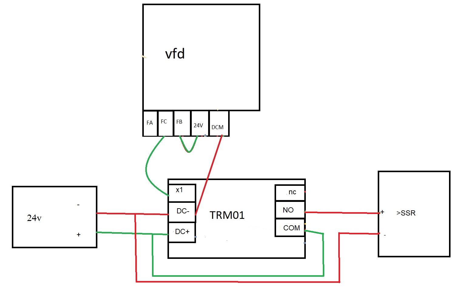

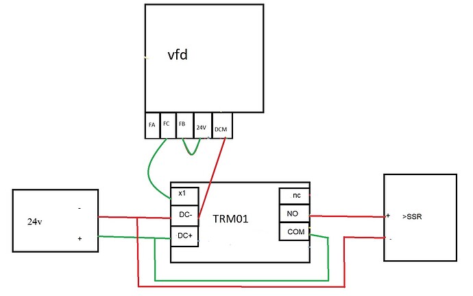

**Post date:** [August 2, 2023, 6:40pm UTC](https://forum.onefinitycnc.com/t/delayed-shutdown-of-the-24v-relay-aftermarket-spindle/21375/53 "2023-08-02T18:40:19Z")
Hi.
Normally the food arrives tomorrow.
That would be the connection?
 ![peut etre](https://us1.discourse-cdn.com/flex022/uploads/onefinitycnc/original/3X/0/5/0511cd838cb4b76c8238ea5bc9def5a8dd09b0d1.jpeg)
**Post date:** [August 2, 2023, 8:47pm UTC](https://forum.onefinitycnc.com/t/delayed-shutdown-of-the-24v-relay-aftermarket-spindle/21375/54 "2023-08-02T20:47:36Z")
Hey Fred,
I used the image that I used previously and modified it:
 ![Fred_Relay_TRM01_24VDC_try1](https://us1.discourse-cdn.com/flex022/uploads/onefinitycnc/original/3X/5/c/5c41181c9e58ac3977b0145cd3697a46aca904cb.jpeg)
(I rotated the TRM01 so that its relay output points to the relay side. If we would be totally correct, the VFD would be on the left and the relays on the right, according to the rule “inputs left, outputs right” 🙂 but it was simpler for me to modify the previous image. I could also make a real circuit diagram, but I have not yet created a symbol for the TRM01 at the moment)
I hope that the X1 input works this way. 🤔
PS: Ah I see your relay wiring is correct, you just flipped the colors! Better follow the conventions: Red should always be used for positive voltage, black for ground/negative.
**Author:** ![Fred11](https://avatars.discourse-cdn.com/v4/letter/f/51bf81/32.png) [@Fred11](https://forum.onefinitycnc.com/u/Fred11)\
**Post date:** [August 2, 2023, 9:25pm UTC](https://forum.onefinitycnc.com/t/delayed-shutdown-of-the-24v-relay-aftermarket-spindle/21375/55 "2023-08-02T21:25:26Z")
Sorry i don’t know the electrical drawing conventions.
On the other hand to be honest I have searched in vain I do not see the difference in the wiring 🤔
**Post date:** [August 2, 2023, 9:36pm UTC](https://forum.onefinitycnc.com/t/delayed-shutdown-of-the-24v-relay-aftermarket-spindle/21375/56 "2023-08-02T21:36:01Z")
yes, you are right. I was just confused because of the red to minus! 🙂
**Post date:** [August 4, 2023, 8:00pm UTC](https://forum.onefinitycnc.com/t/delayed-shutdown-of-the-24v-relay-aftermarket-spindle/21375/57 "2023-08-04T20:00:35Z")
Hi.
It’s ok, everything is working as expected.
Thanks for the help.
