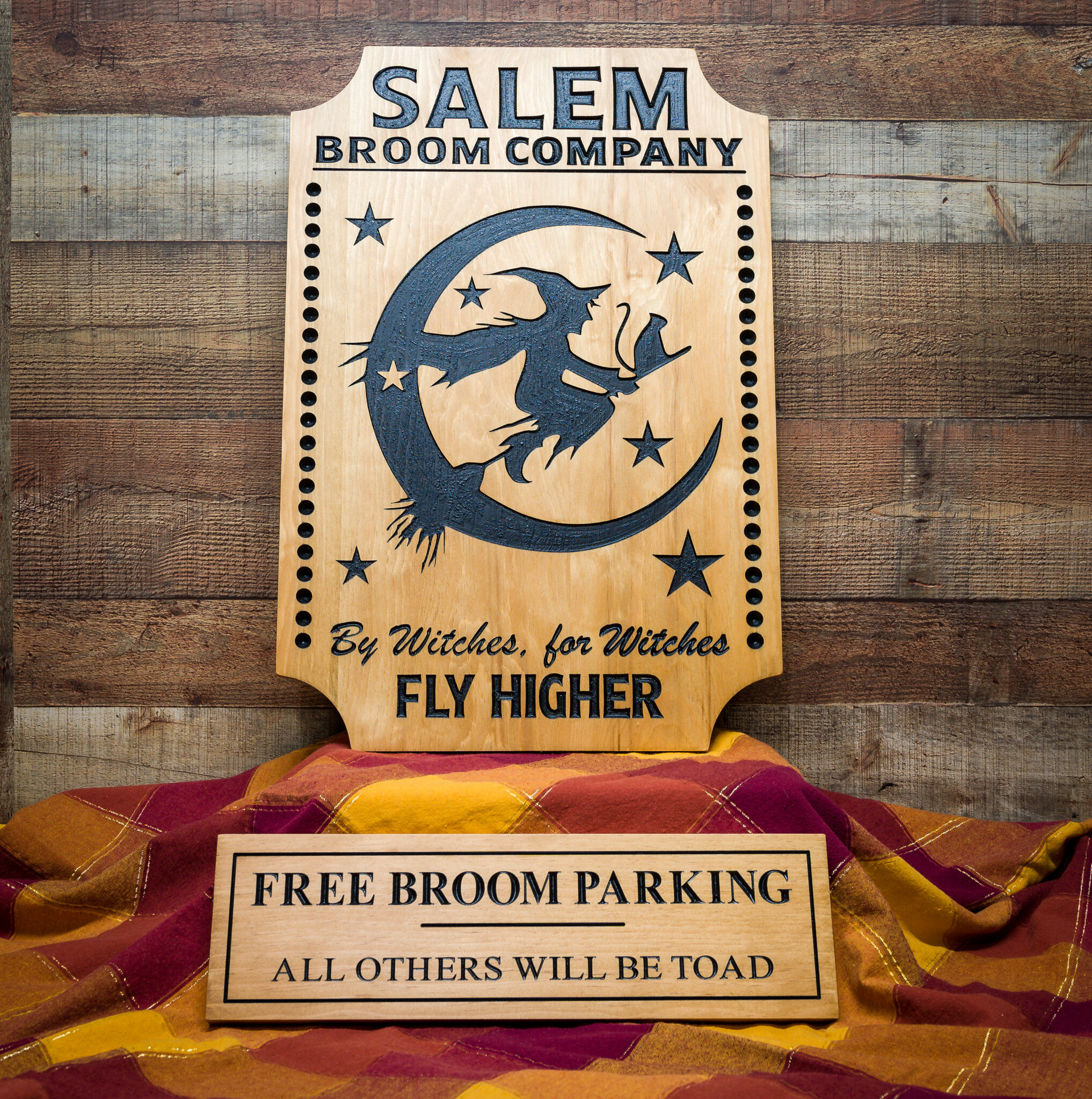

Here is our latest creation. A customer sent us a picture of a sign they wanted to have made and we recreated it using VCarve. This is a double sided sign which will hang outside their house on a post. The smaller sign will hang off the larger sign. This was a fun project and very pleased how it came out on the Onefinity CNC. Need to look at a drum sander to make it easier to ensure the sign if completely flat.

**Post date:** [September 28, 2020, 1:46pm UTC](https://forum.onefinitycnc.com/t/double-sided-halloween-sign/1052/3 "2020-09-28T13:46:12Z")
Very cool! Forgive me if this is a silly question, but did you hand paint the fill on the letters, or do you seal & paint the whole sign black after engraving and then run a finishing pass over the surface to bring back the natural wood?
**Author:** ![CruversWorkshop](https://sea2.discourse-cdn.com/flex022/user_avatar/forum.onefinitycnc.com/cruversworkshop/32/21_2.png) [@CruversWorkshop](https://forum.onefinitycnc.com/u/CruversWorkshop)\
**Post date:** [September 28, 2020, 1:59pm UTC](https://forum.onefinitycnc.com/t/double-sided-halloween-sign/1052/4 "2020-09-28T13:59:36Z")
For this style we carve first, then use some shellac to seal in the carved areas so then when we paint the carved areas black it doesn’t bleed outside the edges. After everything is dry we then sand the entire sign to remove any black paint that is outside the carved areas. Then we do the staining and apply any topcoat the customer might request. This got some water based spar urethane because it will be hung outside.

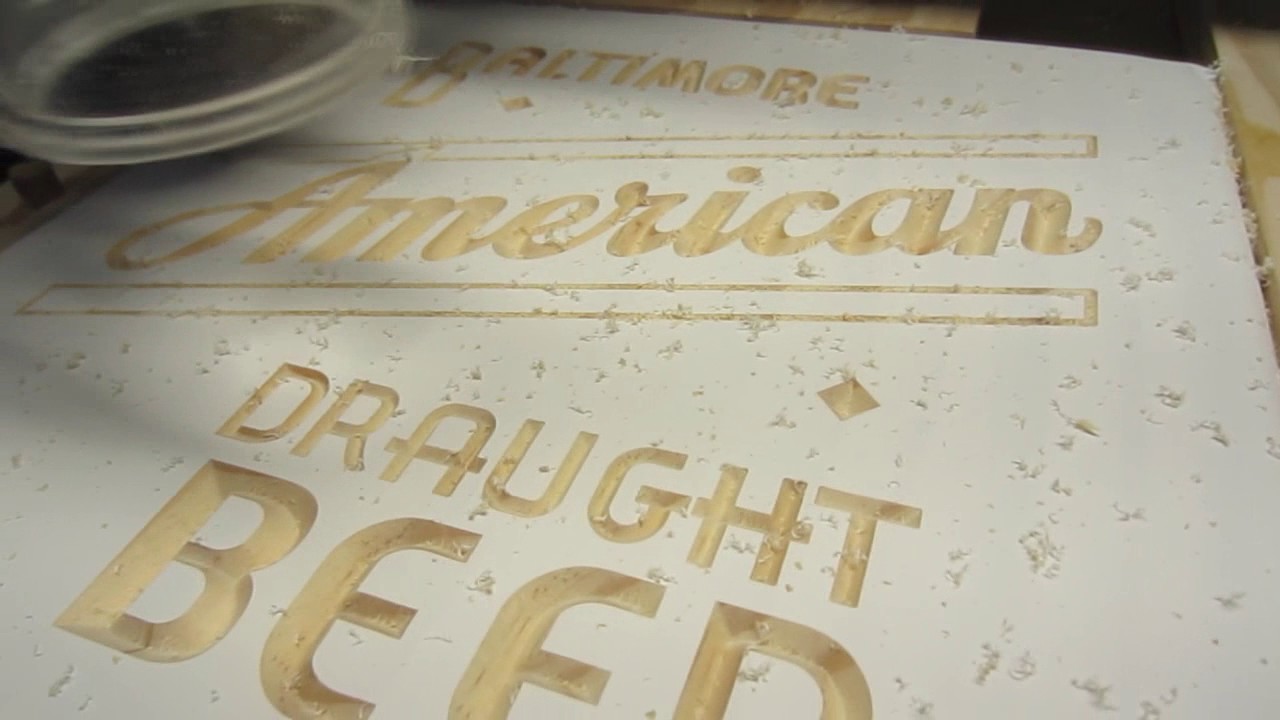

ToolsToday also has a great video for building painted signs using Masking and paint on a CNC. Check it out as it saved a lot of time sanding and also lets you paint multiple colors. @CruversWorkshop might be a good trick for you too!

**Post date:** [July 13, 2024, 1:16am UTC](https://forum.onefinitycnc.com/t/double-sided-halloween-sign/1052/15 "2024-07-13T01:16:16Z")
Thanks for posting this… I just found it now after doing a search for sealing / painting techniques. So just to confirm… the paint never actually touches or penetrates into the wood. It basically sits on top of a layer or two of clear coat and a final coat or two is put over top of the paint? The paint is essentially sandwiched between the clear coats?
**Author:** ![MindOfMcClure](https://sea2.discourse-cdn.com/flex022/user_avatar/forum.onefinitycnc.com/mindofmcclure/32/38_2.png) [@MindOfMcClure](https://forum.onefinitycnc.com/u/MindOfMcClure)\
**Post date:** [July 13, 2024, 3:43am UTC](https://forum.onefinitycnc.com/t/double-sided-halloween-sign/1052/16 "2024-07-13T03:43:18Z")
Hello Trevor, to be honest with you I posted that 4 years ago and I do remember the video but I don’t remember it in depth. That sounds about right but don’t quote me on that. I definitely know the technique works so follow the video and you should be good.
