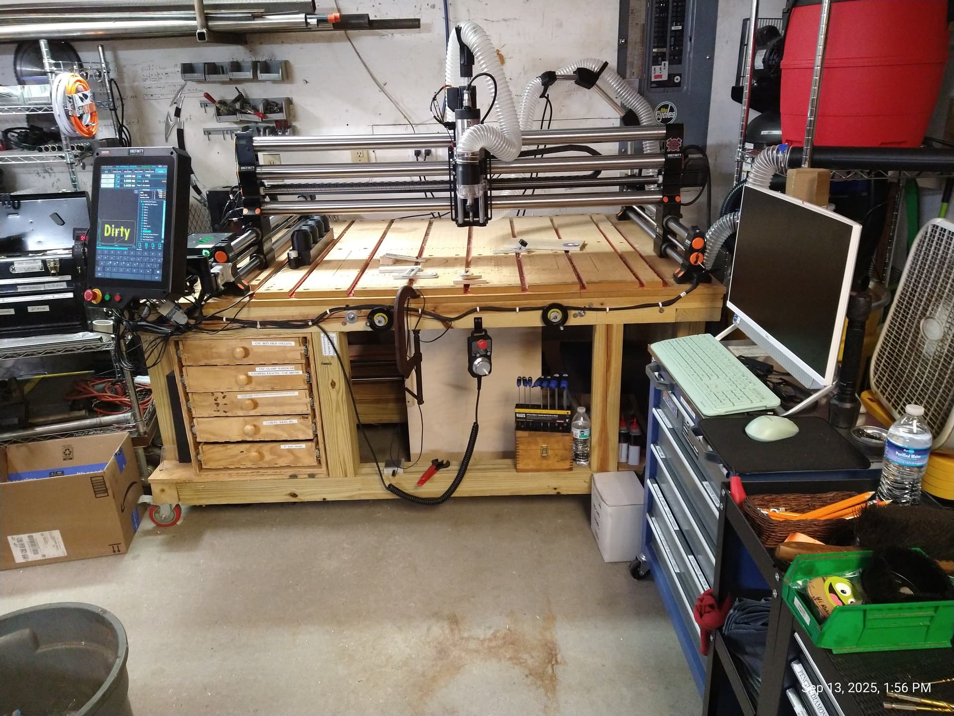

**Post date:** [October 7, 2025, 2:54pm UTC](https://forum.onefinitycnc.com/t/elite-journeyman-table-build/28818/19 "2025-10-07T14:54:09Z")
his is my setup in the garage. the front center of my table has a trap door to do edge dovetails and box joints though i have never actually done any yet, but I can… lol If you would like to see more look up “my table with vertical holding” and there is a lot more detail, and other table configurations as well. Definitely worth a browse. it will give to some ideas for sure.
