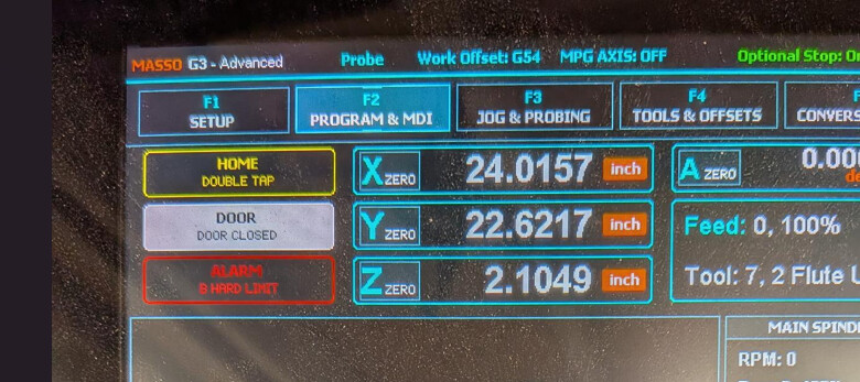

If you take the motor off the B1 rail does the ball screw move freely again?
Also I would suggest posting a picture of the Masso screen to help identify what the 3 boxes are you are talking about. I can guess they are probably the Home and EStop notices that always come up when you first start your machine. If thats so then the bottom of the three will only stop once the ESTOP has been pressed and released and the top will stop once you double press it to home the machine. If pressing and releasing the ESTOP does not stop the bottom of the three from flashing then you definitely have something wrong.

Hey Calvin, I cannot gain access to the locking nuts, on the coupler, by which to allow for motor removal. And that’s due to the seized ball nut. Also, I see no way to post a picture of my Masso’s screen.
1. Yellow box (HOME - Double Tap) constantly flashing - even when double tapping is initiated.
2. White box (DOOR - Door Closed) Steady.
3. Red Box (ALARM - B Hard Limit) constantly flashing, even with activations of the Estop button being pushed in/pulled back out.

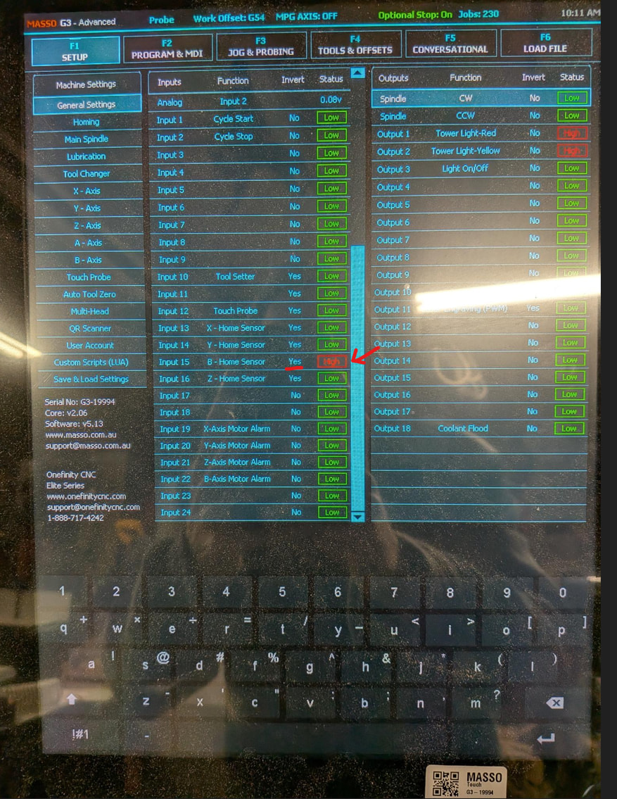

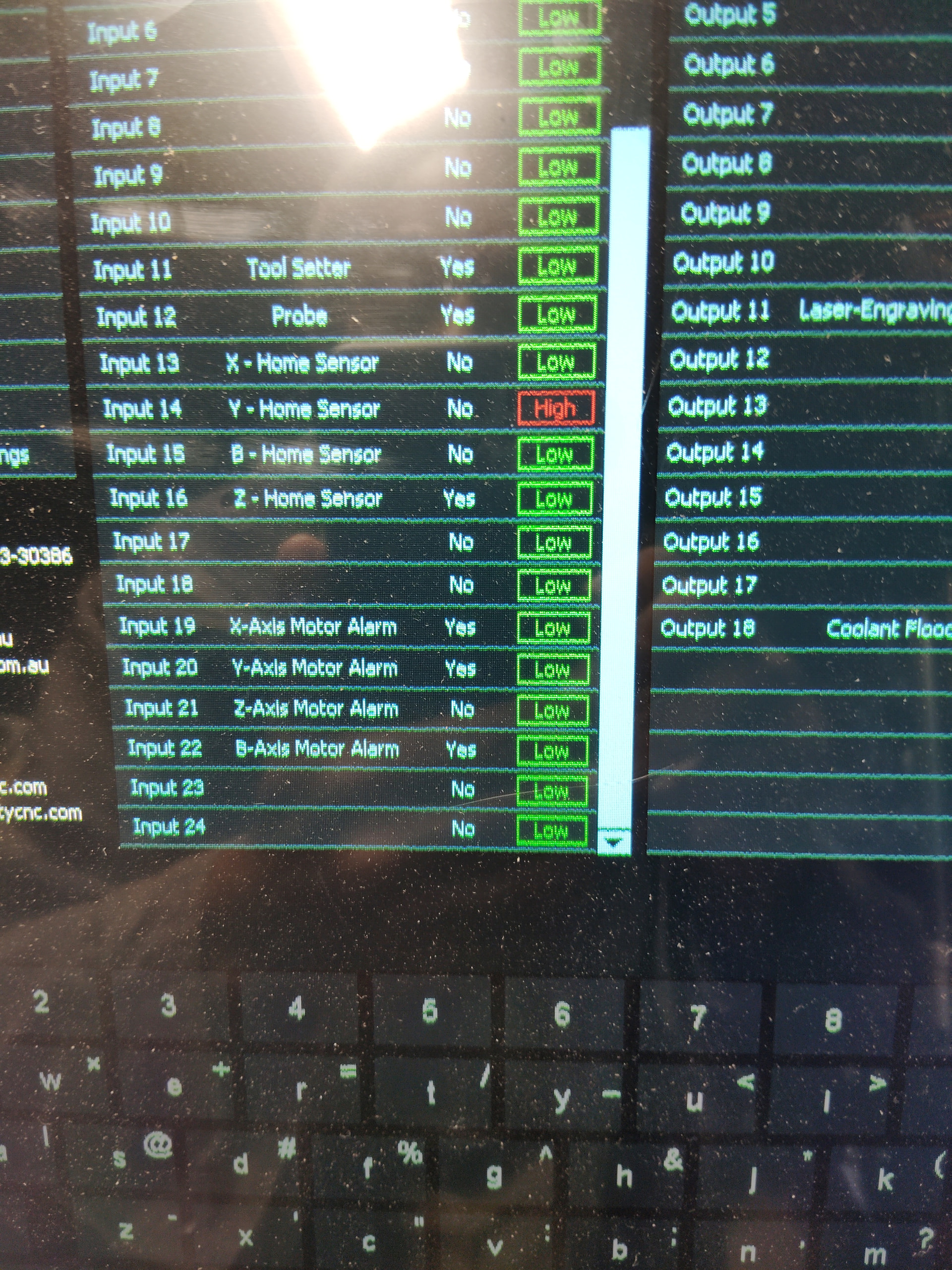

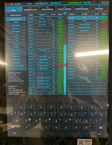

**Post date:** [November 22, 2025, 6:20pm UTC](https://forum.onefinitycnc.com/t/elite-upgrade-problems-help-please/36536/7 "2025-11-22T18:20:29Z")
Home wont stop flashing till you home the machine which requires everything to be up and working first.
The third button showing B hard limit is suggesting that your B axis homing sensor is either tripped or not plugged in. I can recreate that by either unplugging my B homing sensor or tripping it. Attached are photos of the Masso screen. The other possibility is that you have the input inverted on the B sensor possibly.
Of course the sensor isnt going to stop it from spinning freely with the machine off, but its something to start with. I am not sure if you went over this with your support emails and calls.
Remember these photos are with my B homing sensor unplugged trying to recreate your issue. Normally when the homing sensor is plugged in the F1 screen shows “LOW” unless tripped(caused by breaking the sensor beam).
 ![image](https://us1.discourse-cdn.com/flex022/uploads/onefinitycnc/original/3X/c/d/cdc18507b53b529057a49bc00ff4b1218a81b95c.jpeg)
 ![image](https://us1.discourse-cdn.com/flex022/uploads/onefinitycnc/original/3X/6/8/683b1e96b681b97584ec370b65d56ed9808cc180.jpeg)

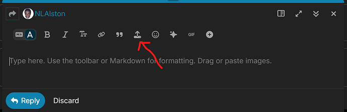

**Post date:** [November 22, 2025, 6:45pm UTC](https://forum.onefinitycnc.com/t/elite-upgrade-problems-help-please/36536/12 "2025-11-22T18:45:16Z")
You can either click the upload button or you just CTRL+C and CTRL+V to copy paste into the message box.
 ![image](https://us1.discourse-cdn.com/flex022/uploads/onefinitycnc/original/3X/d/6/d6f53158fff53af3e8465aa82e89bb63dd66c44b.png)
**Author:** ![NLAlston](https://sea2.discourse-cdn.com/flex022/user_avatar/forum.onefinitycnc.com/nlalston/32/6464_2.png) [@NLAlston](https://forum.onefinitycnc.com/u/NLAlston)\
**Post date:** [November 22, 2025, 6:50pm UTC](https://forum.onefinitycnc.com/t/elite-upgrade-problems-help-please/36536/13 "2025-11-22T18:50:04Z")
I didn’t see an ‘Upload’ button. But figured it had to be there, somewhere 🙂 . Thanks.

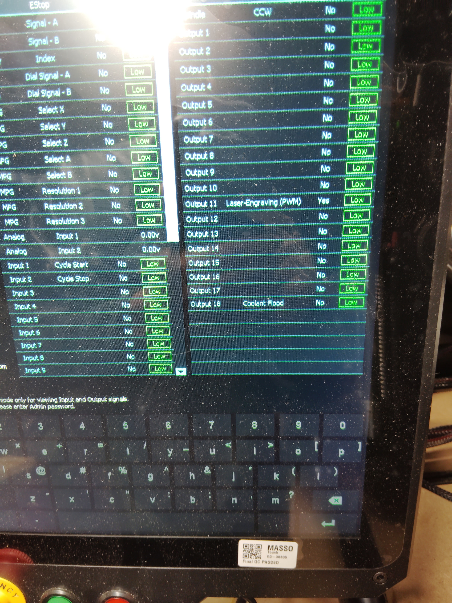

**Post date:** [November 24, 2025, 3:59pm UTC](https://forum.onefinitycnc.com/t/elite-upgrade-problems-help-please/36536/14 "2025-11-24T15:59:07Z")
Hey Calvin, I’m backatcha - AGAIN 🙂.
I apologize for not having gotten back in touch with you, before now. But I have been fighting with my CNC issues, without seeing ANY signs of betterment, as yet. Attached, is a picture of the one Masso Screen. I wonder if what is shown, within it, might reveal something about what the problem is.
 ![My Masso Screen](https://us1.discourse-cdn.com/flex022/uploads/onefinitycnc/original/3X/2/9/293f65faa195d20a669493c6cd32988fac5715c6.jpeg)

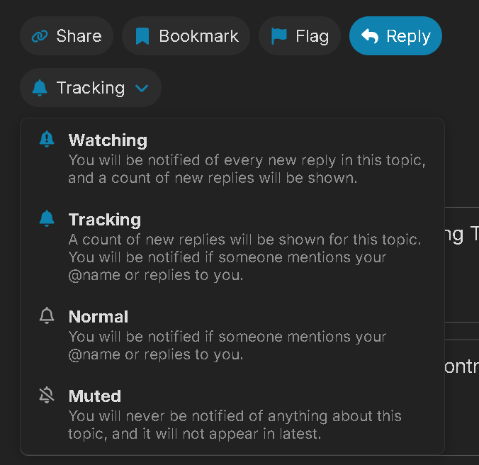

**Post date:** [November 24, 2025, 4:03pm UTC](https://forum.onefinitycnc.com/t/elite-upgrade-problems-help-please/36536/15 "2025-11-24T16:03:15Z")
Also, does this forum allow for replies to automatically give email notifications? I’ve searched for that, but didn’t find it.
**Post date:** [November 24, 2025, 5:05pm UTC](https://forum.onefinitycnc.com/t/elite-upgrade-problems-help-please/36536/16 "2025-11-24T17:05:07Z")
Now you that can post pictures, can you send some more like position of each axis and coupler?
**Post date:** [November 24, 2025, 5:31pm UTC](https://forum.onefinitycnc.com/t/elite-upgrade-problems-help-please/36536/17 "2025-11-24T17:31:22Z")
You need to scroll down on that panel on the left of this image. The sensor inputs are not visible as they are inputs 13-16.

A couple thoughts:
1. Is the carriage sitting at the limit switches?
2. Is the lead screw jammed both powered and turned off?
I had a issue once recently where my elite failed to home and gave me a similar set up, what I did was turn the power off then manually move the axis’s away from the limit switches then it was able to home without issue.
**Author:** ![IncrementalDesigns](https://sea2.discourse-cdn.com/flex022/user_avatar/forum.onefinitycnc.com/incrementaldesigns/32/31328_2.png) [@IncrementalDesigns](https://forum.onefinitycnc.com/u/IncrementalDesigns)\
**Post date:** [November 24, 2025, 11:59pm UTC](https://forum.onefinitycnc.com/t/elite-upgrade-problems-help-please/36536/19 "2025-11-24T23:59:30Z")
Head to your profile and adjust the second setting under email:
 ![image](https://us1.discourse-cdn.com/flex022/uploads/onefinitycnc/original/3X/1/7/17ad9c3889b94ae1e595aa1d8ed09c45bf1e59ea.png)
you can also go to the bottom of the thread and change your tracking setting:
 ![image](https://us1.discourse-cdn.com/flex022/uploads/onefinitycnc/original/3X/d/f/dfe5043c5c64e7e2b5e3782460d5bc9cb0c5c13d.png)
