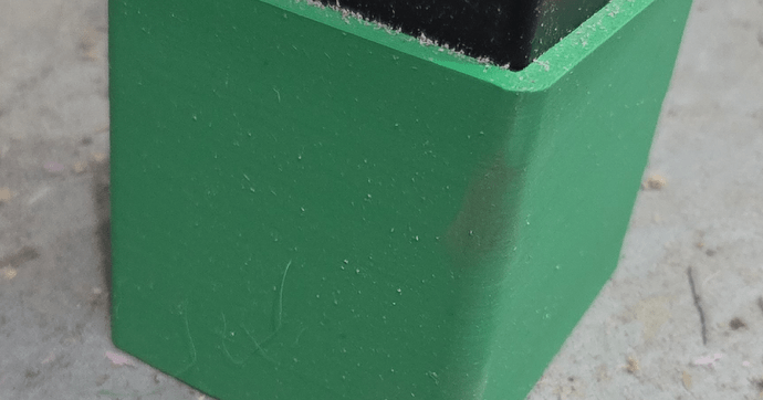

I do epoxy pours on my QCW table with folding legs. I therefore need the table to be perfectly level. In my case I needed to shim two of the four legs of my table. I purchased a QCW Journeyman table back in 2022 so don’t know if these are compatible with newer QCW folding legs.
I have created an OpenSCAD file that generates the STL for a 3D printed foot (shoe?) that snugly fits over the bottom of the foldable leg. In my case I printed them out of PETG and then used a rubber mallet to hammer them in place. I also made permanent marks on my garage floor so that whenever I set up my table, it is roughly in the same place on the floor and therefore level.
You can freely download the file on printables at:
> **[Feet for OneFinity QCW Table Levelling by trepanned | Download free STL model...](https://www.printables.com/model/1414718-feet-for-onefinity-qcw-table-levelling)**
Print and Enjoy.
