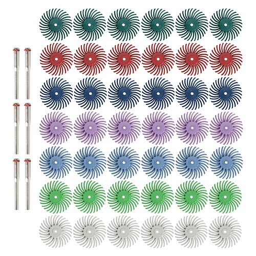

Hi All, I have been carving some 3d Celtic Crosses with pretty good results. About the only thing I am not happy about is finishing them. Obviously they cannot be sanded so to get rid of the hairy stuff I have used steel and brass brushes in a Dremel first then successively smaller burrs and finishing off with abrasive balls. This takes a lot of time without a great finish. Any tips you may have for other methods appreciated. I get different results with different woods, have made Cherry, Maple, Walnut & English Walnut crosses so far with the worst being the English Walnut.
### Author: ![JimHatch](https://sea2.discourse-cdn.com/flex022/user_avatar/forum.onefinitycnc.com/jimhatch/32/3928_2.png) [@JimHatch](https://forum.onefinitycnc.com/u/JimHatch)
#### Post date: [June 19, 2025, 1:10pm UTC](https://forum.onefinitycnc.com/t/finishing-a-3d-carve/33990/3 "2025-06-19T13:10:30Z")

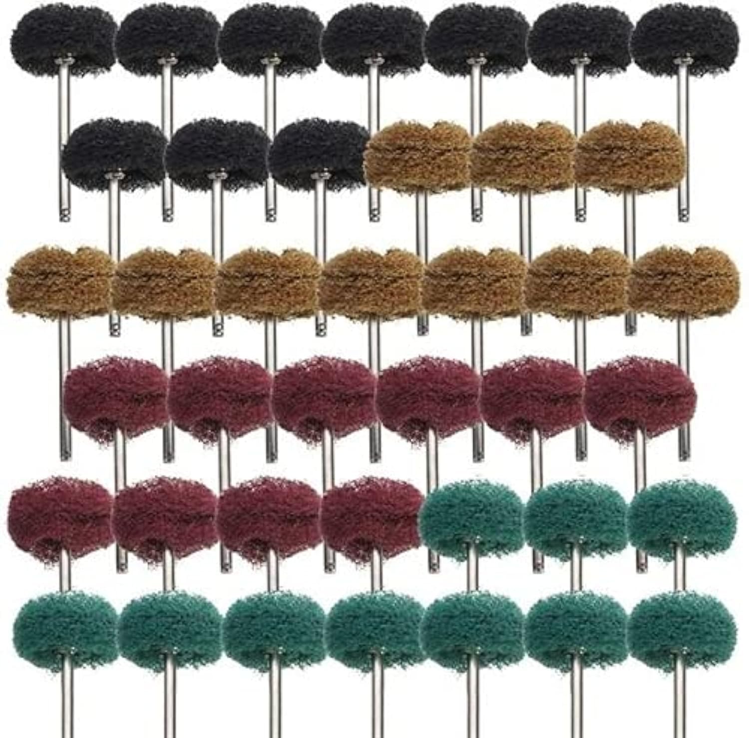

Have you tried sanding mops or the small buffing wheels? Like these:
> **[Amazon.com: Rocaris 40 Pack 1 inch Abrasive Wheel Buffing Polishing Wheel Set...](https://www.amazon.com/Rocaris-Abrasive-Buffing-Polishing-Rotary/dp/B0CHS343NH?tag=benmyers-20)**
> Buy Rocaris 40 Pack 1 inch Abrasive Wheel Buffing Polishing Wheel Set for Rotary Tool - 25mm…: Buffing Wheels - Amazon.com ✓ FREE DELIVERY possible on eligible purchases
### Author: ![tschrag](https://avatars.discourse-cdn.com/v4/letter/t/82dd89/32.png) [@tschrag](https://forum.onefinitycnc.com/u/tschrag)
#### Post date: [June 25, 2025, 7:21pm UTC](https://forum.onefinitycnc.com/t/finishing-a-3d-carve/33990/5 "2025-06-25T19:21:36Z")

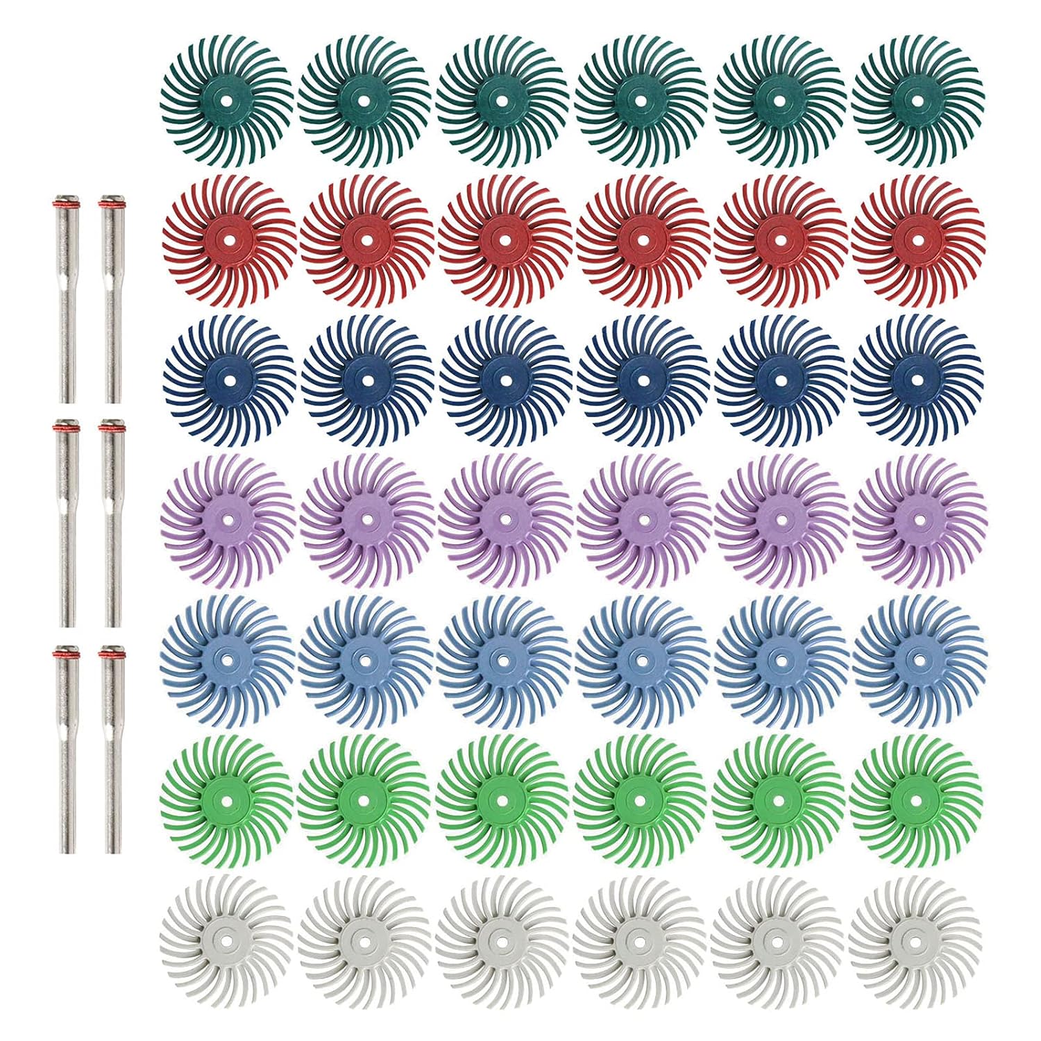

I use these for the tight spots, in addition to the buffing wheels that Jim mentioned. They work great for detailed relief work.
> **[Amazon.com: 42pcs 1 Inch Radial Bristle Disc Kit with 3mm Shank for Rotary...](https://www.amazon.com/Radial-Bristle-Abrasive-Jewelry-Polishing/dp/B07W4NQC8Z?tag=benmyers-20)**
> Buy 42pcs 1 Inch Radial Bristle Disc Kit with 3mm Shank for Rotary Tools,Detail Abrasive Wheel for Jewelry Wood Metal Polishing, Bristle Wheel with Grit 80-2500: Bristle Discs - Amazon.com ✓ FREE DELIVERY possible on eligible purchases
