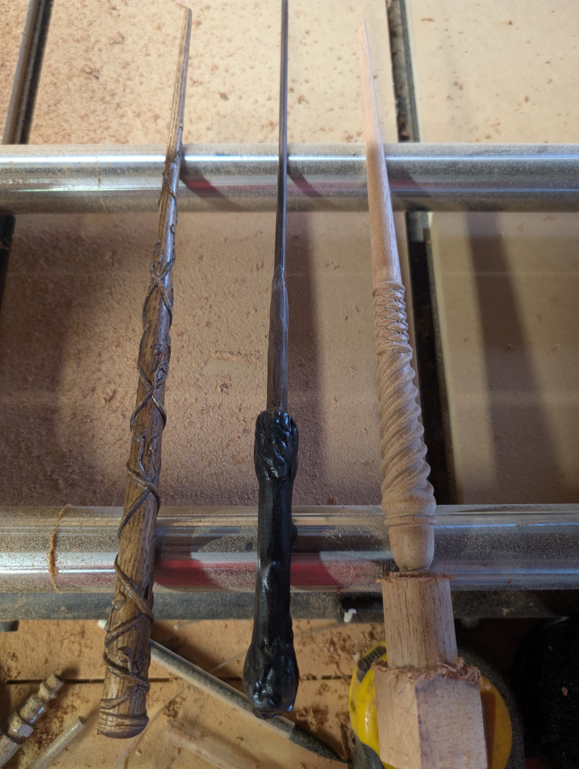

**Post date:** [July 24, 2025, 3:35pm UTC](https://forum.onefinitycnc.com/t/first-carve-on-the-revolution-4th-axis-rotary/34288/4 "2025-07-24T15:35:58Z")
![PXL_20250714_222730931](https://us1.discourse-cdn.com/flex022/uploads/onefinitycnc/original/3X/c/f/cf2d638c689d54647572b61cfe5f972dada987db.jpeg)
It took a lot of work to get it working correctly for me, but the results have been really good now that a lot of the bugs have been worked out. Thanks to onefinity for all of the quick help getting me back up and running!

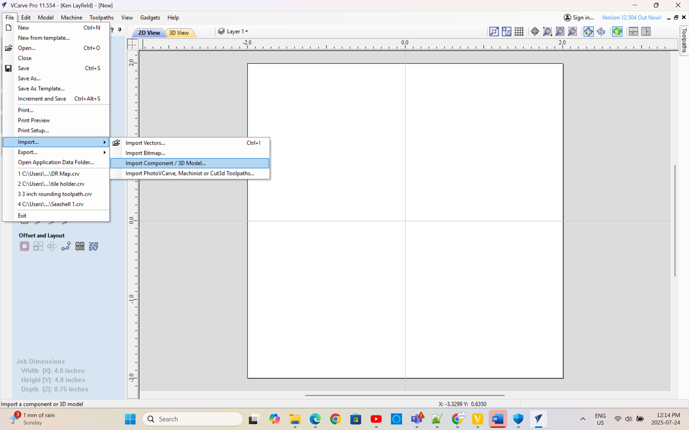

**Post date:** [July 24, 2025, 4:12pm UTC](https://forum.onefinitycnc.com/t/first-carve-on-the-revolution-4th-axis-rotary/34288/6 "2025-07-24T16:12:59Z")
ok i have tried this a few times .I downloaded the file and then tried to open it using vcarve pro the computer then gives me a blue notice that this app can not run on this computer. how do I import the file to vcarve pro?
**Post date:** [July 24, 2025, 4:14pm UTC](https://forum.onefinitycnc.com/t/first-carve-on-the-revolution-4th-axis-rotary/34288/7 "2025-07-24T16:14:34Z")
ok so what are those pointy things you made? also where do i find files for the rotary carvings?
**Post date:** [July 24, 2025, 4:15pm UTC](https://forum.onefinitycnc.com/t/first-carve-on-the-revolution-4th-axis-rotary/34288/8 "2025-07-24T16:15:14Z")
![image](https://us1.discourse-cdn.com/flex022/uploads/onefinitycnc/original/3X/b/3/b3903e267f449bb3c96f8ac85e5a5f2ed3ce1a6b.jpeg)
**Post date:** [July 24, 2025, 4:19pm UTC](https://forum.onefinitycnc.com/t/first-carve-on-the-revolution-4th-axis-rotary/34288/9 "2025-07-24T16:19:12Z")
Thanks, Ken but I have 12.504 and the import component is grayed out. now I am confused as I thought I had the latest and greatest lol. ok I figured that out I had to close the job setup screen so now it is not grayed out, but it still would not import it. in fact, it does not even show up as available when I click on download file. I know I am doing something wrong, but it has been almost a year since I have used this program. I was recovering from a bypass and then sold my old machine and got the new journeyman elite and then waited for all the parts n’ pieces so I m a bit rusty shall we say?
**Author:** ![Seamartin00](https://avatars.discourse-cdn.com/v4/letter/s/ed655f/32.png) [@Seamartin00](https://forum.onefinitycnc.com/u/Seamartin00)\
**Post date:** [July 24, 2025, 4:27pm UTC](https://forum.onefinitycnc.com/t/first-carve-on-the-revolution-4th-axis-rotary/34288/10 "2025-07-24T16:27:46Z")
Harry Potter wands. Any stl file used for 3d printing can be handled in vectric, just import it and you’re good to go
**Post date:** [July 24, 2025, 4:31pm UTC](https://forum.onefinitycnc.com/t/first-carve-on-the-revolution-4th-axis-rotary/34288/12 "2025-07-24T16:31:10Z")
![vcarve12_en-pic~3](https://us1.discourse-cdn.com/flex022/uploads/onefinitycnc/original/3X/6/1/61d4e4143aae83a6dd9f28fe8d7301efd2ef7678.jpeg)
To import a 3d file, a crv is a save file, so don’t import it, just open it like you would any other saved project.
**Post date:** [July 24, 2025, 4:33pm UTC](https://forum.onefinitycnc.com/t/first-carve-on-the-revolution-4th-axis-rotary/34288/13 "2025-07-24T16:33:33Z")
what program opens a crv file I do not have aspire and it seems like that is what you need to pen this sort of file
**Post date:** [July 24, 2025, 4:44pm UTC](https://forum.onefinitycnc.com/t/first-carve-on-the-revolution-4th-axis-rotary/34288/14 "2025-07-24T16:44:28Z")
You need the same version of the vectric software that made it (VCarve, VCarve pro, aspire)
**Post date:** [July 27, 2025, 7:32pm UTC](https://forum.onefinitycnc.com/t/first-carve-on-the-revolution-4th-axis-rotary/34288/15 "2025-07-27T19:32:07Z")
I cannot attempt spending another 1300 dollars on the upgrade to aspire. I just spent a grand on refurbishing my SB9A lathe. My wife is understanding but even she has limits. I like being married to her. Maybe later in the year lol.
**Post date:** [July 27, 2025, 8:56pm UTC](https://forum.onefinitycnc.com/t/first-carve-on-the-revolution-4th-axis-rotary/34288/16 "2025-07-27T20:56:34Z")
You can use Vcarve Pro to some limited rotary files like spindles and some 3D files.
Limitations are in the toolpath strategies and model adjustments

**Post date:** [July 27, 2025, 9:32pm UTC](https://forum.onefinitycnc.com/t/first-carve-on-the-revolution-4th-axis-rotary/34288/17 "2025-07-27T21:32:59Z")
As far as I know Vcarve Pro has all the same machining capabilities as Aspire including 4-axis rotary cutting. The big difference is in the 3d model abilities. Creating and editing 3d models can only be done in Aspire. Of course you can import a 3d model into Vcarve Pro and then machine it with 4-axis rotary machining.
So if you buy a 3-d model or create one in another software package you can use it on the rotary in Vcarve Pro.
