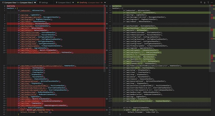

API list from 1F firmware: [https://github.com/OneFinityCNC/onefinity-firmware/blob/2baae7965a96795988ceadf4079aa76a1642040f/src/py/bbctrl/Web.py#L632](https://github.com/OneFinityCNC/onefinity-firmware/blob/2baae7965a96795988ceadf4079aa76a1642040f/src/py/bbctrl/Web.py#L632)
Api list from Buildbotics firmware: [https://github.com/buildbotics/bbctrl-firmware/blob/3db09c84b4c6838bd01bc2ed92f288b3157644fd/src/py/bbctrl/Web.py#L599](https://github.com/buildbotics/bbctrl-firmware/blob/3db09c84b4c6838bd01bc2ed92f288b3157644fd/src/py/bbctrl/Web.py#L599)
it’s seem that Buildbotics have a call “/api/state(/.\*)” but not the 1F.
Is anyone had interact with this API ?
PS: @cyberreefguru love your Youtube Channel, thx for your work.
 ![Capture d'écran 2023-08-20 160922](https://us1.discourse-cdn.com/flex022/uploads/onefinitycnc/original/3X/6/2/62de39d6e00754cc907ed61a4ccb50b8b4ae7af9.jpeg)

I’m probably of limited help here but what I can see is this is a routes file, like what a web client would request off to the backend service. In this case, your web browser would be making a request with that path (a route) in the browser URI. In the parenthesis, it appears that a path is provided here `(/.*)?`. It looks like a regex where the first character match is a `/` (this is what makes me think it’s parsed like a path). The following characters `.*` means a greedy match. So any and all characters after a `/` should match. The `?` usually means that passing a value there is optional (as in, may or may not be provided).
Example. If a uri base looked like this `https://my.awesome.server/`
then the route of `api/state(/.*)?` would look like this in a browser:
`https://my.awesome.server/api/state/spindle`
(where I’m just making up the word spindle).
The question mark means that you ‘might’ technically work like this too:
`https://my.awesome.server/api/state`
Looking at the screenshots, I can only tell you the following:
1. If that code is in the originall BBC codebase and not the 1F, you won’t get a response when putting the route part `/api/state` into the browser’s uri.
2. To really know how this is used, you’ll need to look at the interface file for how the back-end uses this route. Typically there is a description and if needed, you can drill deeper from the interface into the implementation and checkout how the back end is switching on the variable path to return a response.
I’m betting that this method probably switches on quite a few response objects so it will be fun to read.
If by any means you already understood any of this, my apologies. I hope that you’d just let the message stand for others that are curious.
Good luck.

Thanks for your reply, i already understand the route concept and the RegEx, i’m a senior linux dev, but it will be used for other person for sure.
Right now **i found zero docs** on this API so it’s kind of a reverse engineering to found what do what, and sadly the “STATE” route is not available on 1F firmware.
I will continue to try all the API call and see what do what i try to out put a kind of API manual, if any of you have information I really will appreciate
