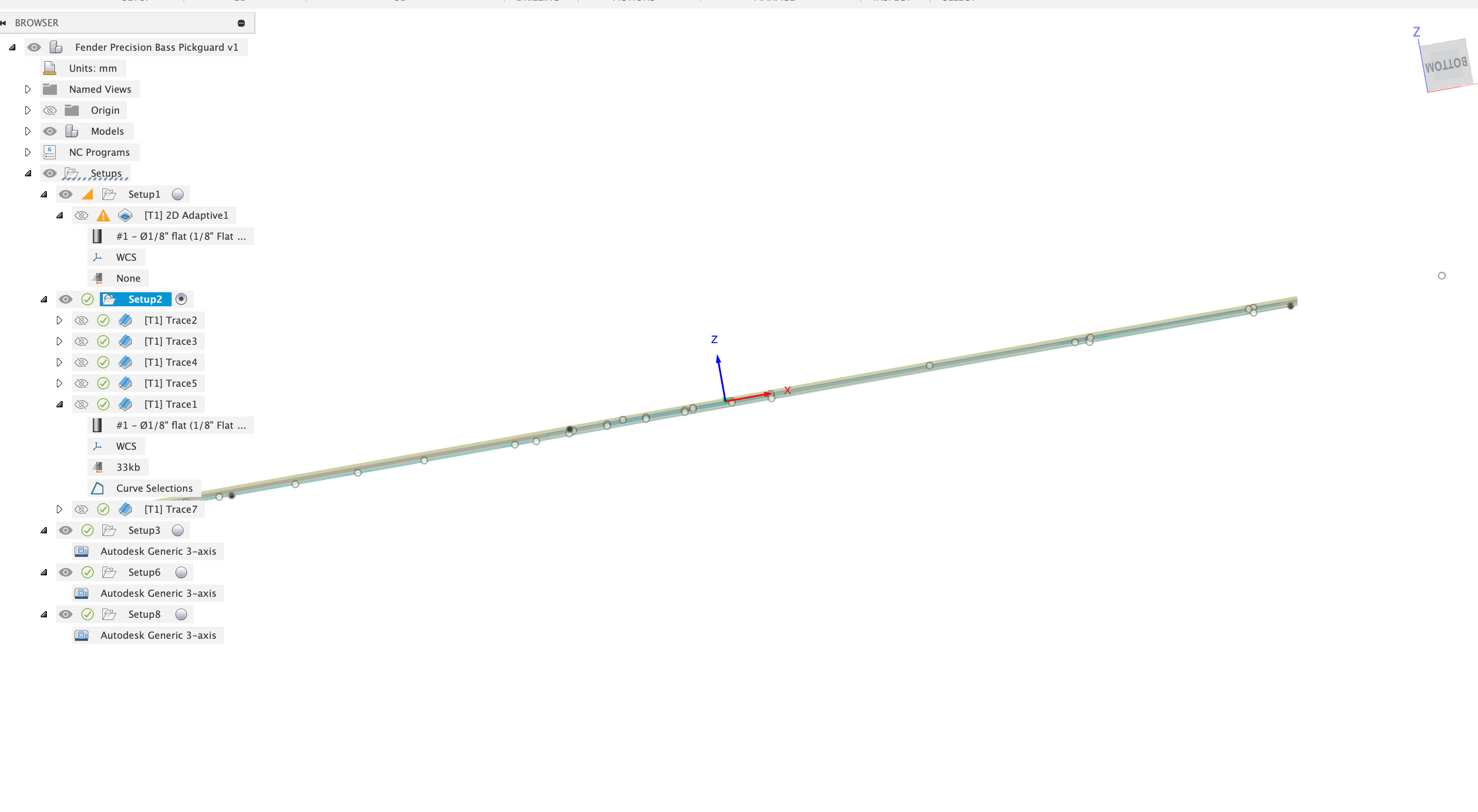

> [@SMWGuitars](#):
> fusion 360 system to use a “generic 2d”
FWIW your screenshot above shows you are using the Generic 3 axis mill.

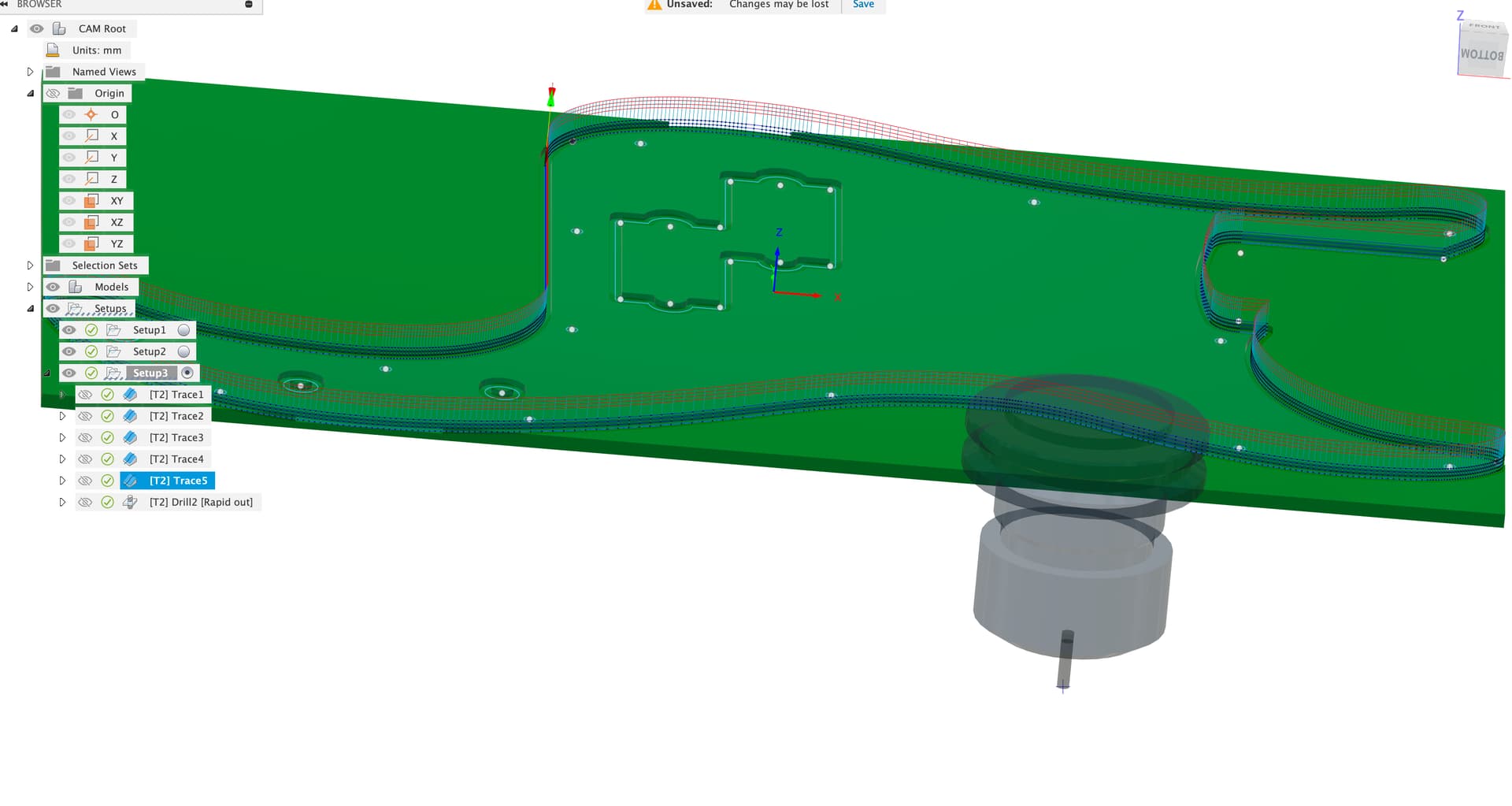

Ok I’ve messed up with the screenshots… heres the one that isn’t working. The one I sent last night was actually something that had not been attempted on the machine… but the NC code it generated did lack all Z commands.

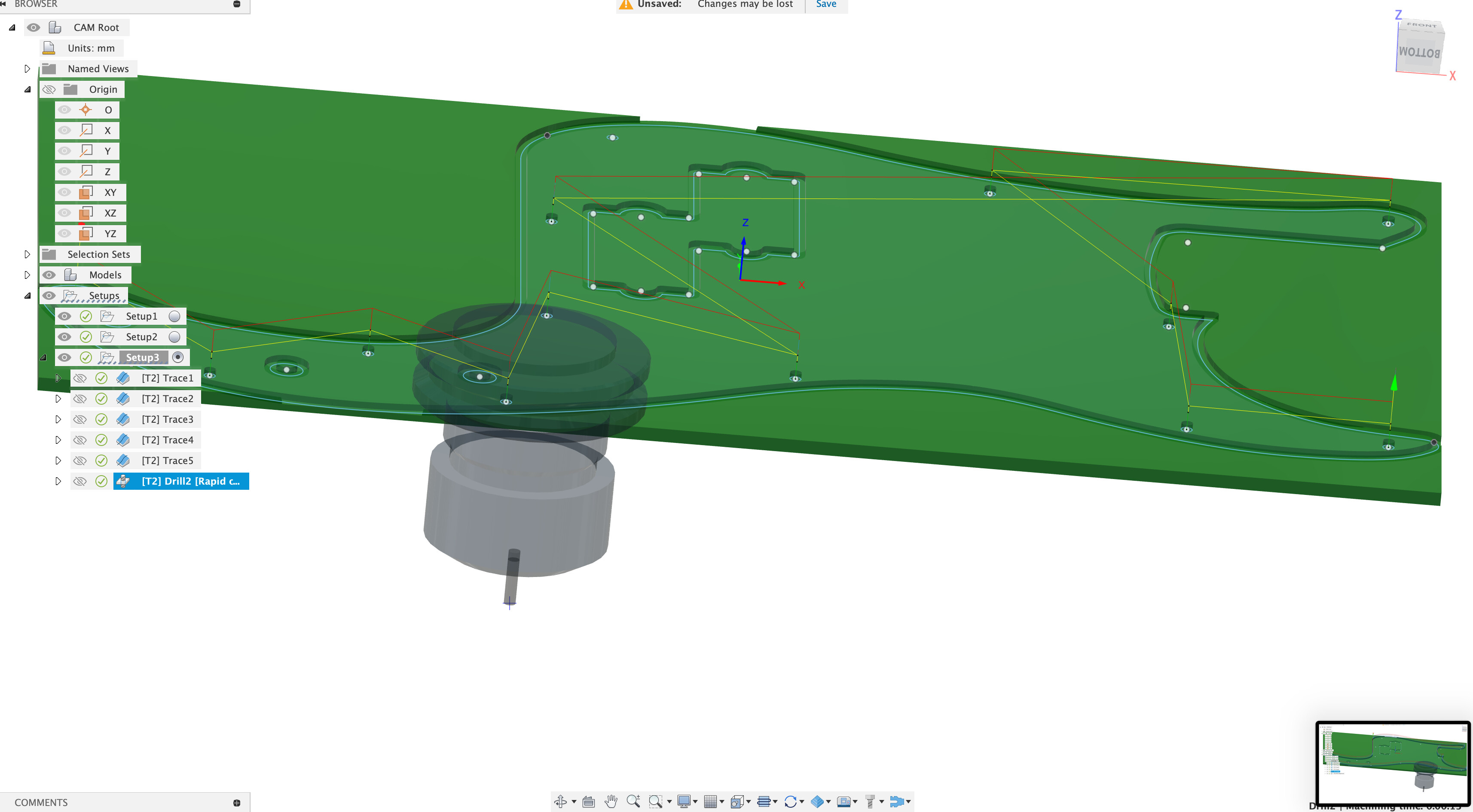

![Screenshot 2024-01-09 at 9.32.48 AM](https://us1.discourse-cdn.com/flex022/uploads/onefinitycnc/original/3X/3/c/3c44232784949c9610675189214521027a22ac8f.jpeg)
 ![Screenshot 2024-01-09 at 9.32.54 AM](https://us1.discourse-cdn.com/flex022/uploads/onefinitycnc/original/3X/c/8/c807249cfc25e23ba870eab525187c66da87054d.jpeg)
**Author:** ![SMWGuitars](https://avatars.discourse-cdn.com/v4/letter/s/0ea827/32.png) [@SMWGuitars](https://forum.onefinitycnc.com/u/SMWGuitars)\
**Post date:** [January 9, 2024, 5:34pm UTC](https://forum.onefinitycnc.com/t/help-an-idiot/24601/26 "2024-01-09T17:34:12Z")
These are from the same guard but the second attempt. Very sorry for confusion.

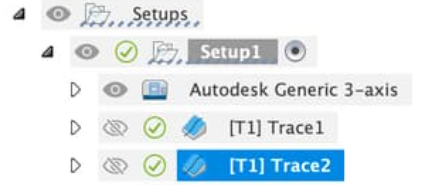

That one actually seems to have a different issue… when doing Post Process this is all I get. ##########
THIS POSTPROCESSOR IS A SAMPLE FOR MACHINE SIMULATION USAGE, IT DOES NOT OUTPUT ANY NC PROGRAM.
For more information on how to update your post processor with machine simulation support please visit:
[https://knowledge.autodesk.com/community/article/356406](https://knowledge.autodesk.com/community/article/356406)
**Author:** ![WaywardWoodworker](https://avatars.discourse-cdn.com/v4/letter/w/e79b87/32.png) [@WaywardWoodworker](https://forum.onefinitycnc.com/u/WaywardWoodworker)\
**Post date:** [January 9, 2024, 5:42pm UTC](https://forum.onefinitycnc.com/t/help-an-idiot/24601/28 "2024-01-09T17:42:44Z")
Check out the link that @Woodworking_Pilot posted about how to update the machine settings to use the Onefinity post processor.

**Post date:** [January 10, 2024, 2:16am UTC](https://forum.onefinitycnc.com/t/help-an-idiot/24601/29 "2024-01-10T02:16:09Z")
Yes I spent some time messing around today and that solved it. But we did it guys. Or you did it. You helped an idiot 😃 Thank you all so much!
