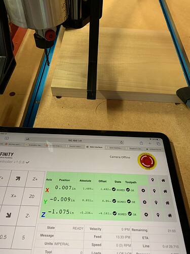

I recently purchased a slightly used x-35 Woodman. I have used successfully used it to cut a few simple projects. I am using Fusion360 for designing and simulated projects appear correct. On my latest project, I start the machine, home it, then zero it on the work piece. Once I load and run the program, the machine moves to the right x/y, but the z goes positive and then appears to set a new zero ca2.5” above the work surface.
Attached are a few photos and the Gcode for reference.
Homed and zeroed
 ![image](https://us1.discourse-cdn.com/flex022/uploads/onefinitycnc/original/2X/3/3d808e63eb0c744320ae164f60c05d7b5d06e40a.jpeg)
New min z after run attempt.
 ![image](https://us1.discourse-cdn.com/flex022/uploads/onefinitycnc/original/3X/2/2/221946a731463410758598966084bf9d90594a40.jpeg)
Visual of the gcode (each tool is a separate file)
 ![image](https://us1.discourse-cdn.com/flex022/uploads/onefinitycnc/original/3X/d/e/de551c043d68aa116d4c37333f0b01c468396706.jpeg)
 ![image](https://us1.discourse-cdn.com/flex022/uploads/onefinitycnc/original/3X/d/d/dd22f470a35796d149fff35adf95147a3e5adc47.jpeg)
Gcode
[Gcode - tool 1](https://1drv.ms/u/s!AtkJbB5YNmVF0jZ2su_elEe1nss7)
Video link at the start of run:
[iCloud](https://share.icloud.com/photos/00qPNVqThYKg5ZM-ykF2DRyHw#Magnolia)
Any suggestions about what I am doing wrong?

akfrozen (Tim) - I think your problem is in your CAM software chain (somewhere).
I looked at the gcode file you provided and it looks like your max Z height is 0.600 (for rapids?), your most typical starting cut height is z=0.200 (e.g. for starting to pocket the center feature) and your lowest depth - also the bottom of all your features - is z= negative 0.11"
In other words, if you set the zero to the top of the spoilboard, your code is telling the machine to cut 0.11" into the spoilboard. Wrong post-processor? Funky z-height offset somewhere in Fusion360?
Incidentally, this is the first couple lines of the gcode - note the last line “ZMIN=-0.11”

**Author:** ![YXYJack](https://avatars.discourse-cdn.com/v4/letter/y/c67d28/32.png) [@YXYJack](https://forum.onefinitycnc.com/u/YXYJack)\
**Post date:** [January 11, 2022, 6:05pm UTC](https://forum.onefinitycnc.com/t/home-zero-load-run-then-z-hops-to-new-zero/9094/10 "2022-01-11T18:05:38Z")
hi Milank - I see your point.
There a couple of funky other things (besides the gcode) in the OPs post
1. The change in units from metric to imperial. Some users have reported cutting issues when the controller is in metric and the gcode is imperial.
2. If you convert the two Z-value OFFSET values from the two pictures into a common unit, they are the same to within 1/100". That seems too perfect to be coincidental. OFFSET = POSITION (ZERO) -Absolute (HOME)
So it seems to me the bit is actually in exactly the same ‘true’ point in Z-space say relative to the spoilboard. If that’s true either the POSITION/ZERO value was changed between the two photos or the ABSOLUTE/HOME value was (or both). There are a bunch of different ways for users to change the POSITION/ZERO and ABS positions via the GUI. I think some values can be changed via gcode from CAM. don’t know if there is a way for the machine to do it other than losing steps or false homing.
1. in the second picture, the Z ABS value - normally defined relative to HOME - is -5.23" which is virtually the max travel of the Z-axis. But the machine doesn’t appear bottomed out on Z-travel (still lots of height left in the guide rods). The machine is also not complaining the loaded file will exceed the Z soft limit - even though the Z would need to lower another maybe 1”+ to reach the workpiece. This implies to me the ABS (HOME) Z is not reflecting a ‘real’ value.
I’d reboot the controller and watch the OPs homing and zeroing process really closely. Unfortunately the provided video comes up as ‘you don’t have permission’
