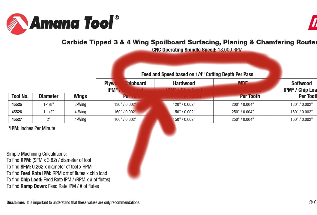

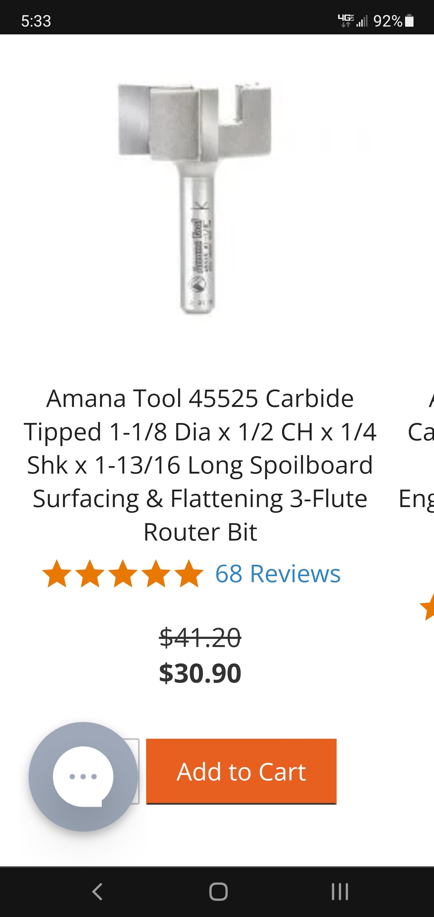

**Author:** ![wsj-productions](https://sea2.discourse-cdn.com/flex022/user_avatar/forum.onefinitycnc.com/wsj-productions/32/2903_2.png) [@wsj-productions](https://forum.onefinitycnc.com/u/wsj-productions)\
**Post date:** [October 19, 2021, 12:39am UTC](https://forum.onefinitycnc.com/t/how-long-does-it-take/8080/17 "2021-10-19T00:39:27Z")
How are you guys getting that depth of cut? I use this bit, run it at 120ipm 18000rpm only .01doc
I cannot find anything on depth of cut for this.
I do 60% step over for surfacing

**Author:** ![ConvenientWoodwork](https://sea2.discourse-cdn.com/flex022/user_avatar/forum.onefinitycnc.com/convenientwoodwork/32/22558_2.png) [@ConvenientWoodwork](https://forum.onefinitycnc.com/u/ConvenientWoodwork)\
**Post date:** [October 19, 2021, 12:59am UTC](https://forum.onefinitycnc.com/t/how-long-does-it-take/8080/18 "2021-10-19T00:59:16Z")
Theoretically you can cut as deep as your cutting edges, but in practice that rarely works out cleanly.
With a surfacing bit I’d not go deeper than 1/4" simply because my intuition says not to (sorry that’s not very helpful), however I have no problem running 3/4"+ deep with a 1/4" end mill.
As long as your chipload is appropriate based on feeds and speeds depth of cut is up to you!

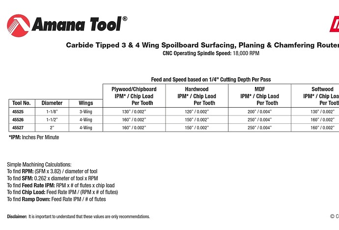

**Post date:** [October 19, 2021, 1:07am UTC](https://forum.onefinitycnc.com/t/how-long-does-it-take/8080/19 "2021-10-19T01:07:02Z")
And there it is… This whole time… Thanks.
