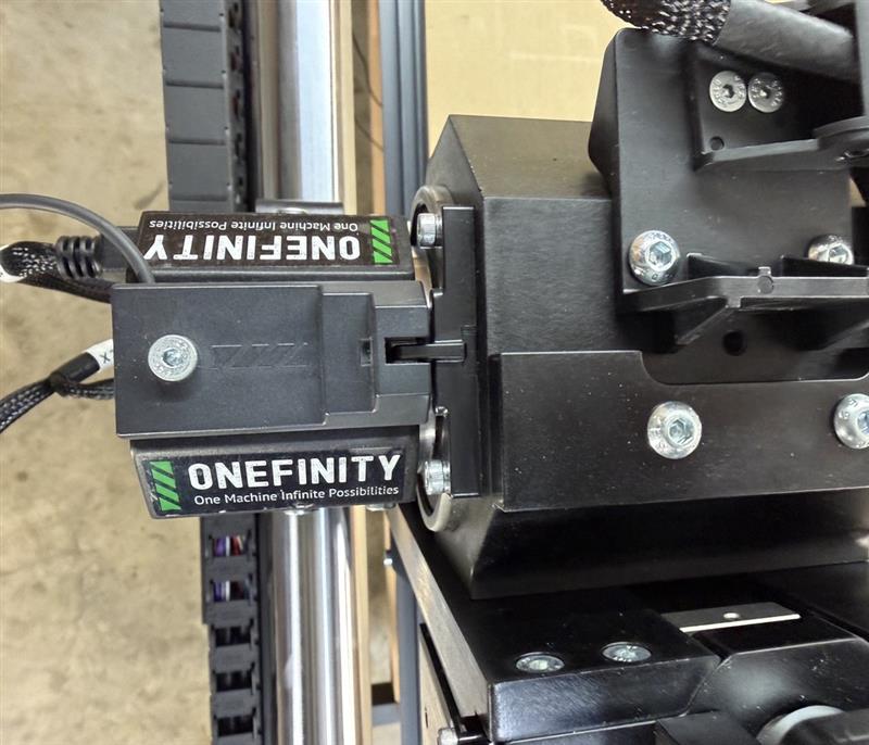

If you are experiencing homing issues, you may have a defective homing sensor.
This is a method to test their functionality.
1. If your machine is on, ensure you power off the machine first.
2. Ensure each axis (x,y,b,z) are 3 inches or so away from the homing sensor (you may push them away physically with machine off).
3. Power up the machine.
4. DO NOT HOME.

8. Take a allen key and ‘break the light beam’ like so (this sample is showing the y axis, but the rest are similar):
 ![a](https://us1.discourse-cdn.com/flex022/uploads/onefinitycnc/original/3X/b/3/b3db69428e92bbd5080c4a8540a10166c670e533.gif)
9. While in the Diagnostic page, observe the corresponding ‘axis home sensor’. It should change from Orange/OPEN to Green/CLOSED and visa versa every time you break the beam, like so:
 ![Sensor Test Redline Small](https://us1.discourse-cdn.com/flex022/uploads/onefinitycnc/original/3X/8/3/83ddf6261eacb9d04ce5ef02b934738d46fb98b9.gif)
10. Repeat the process to test for all homing sensors.
11. If the status does not change, the sensor is most likely bad and needs to be replaced. Contact [support@onefinitycnc.com](mailto:support@onefinitycnc.com) for further assistance.
