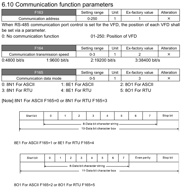

Hey Jason,
I just read the [User Manual](https://www.omc-stepperonline.com/download/VFD%20manual%20datasheet.pdf) you posted above for [OMC-Stepperonline V70 VFD](https://www.omc-stepperonline.com/stepperonline-cnc-vfd-075kw-1hp-7a-110v-variable-frequency-drive-motor-inverter-for-spindle-motor-speed-control?search=vfd). It seems a little bit as if the Huanyang VFD (and the Huanyang manual) was a more simple clone or counterfeit of this VFD. It is true as you said that the most settings have identical numbers (“PDxxx” on the Huanyang instead of “Fxxx” on the OMC V70), but the OMC V70 has much more capabilities and a good manual. It is also capable of [Vector Control](https://en.wikipedia.org/wiki/Vector_control_(motor)).
The OMC V70 Manual covers models from .75 kW up to 7.5 kW but on the [OMC Website](https://www.omc-stepperonline.com/variable-frequency-drive/) there is only the .75 kW model. Did they stop their production?
Anyway, the ModBus RS-485 settings F163, F164, and F165 are the same as on the Huanyang the settings PD163, PD164, and PD165:

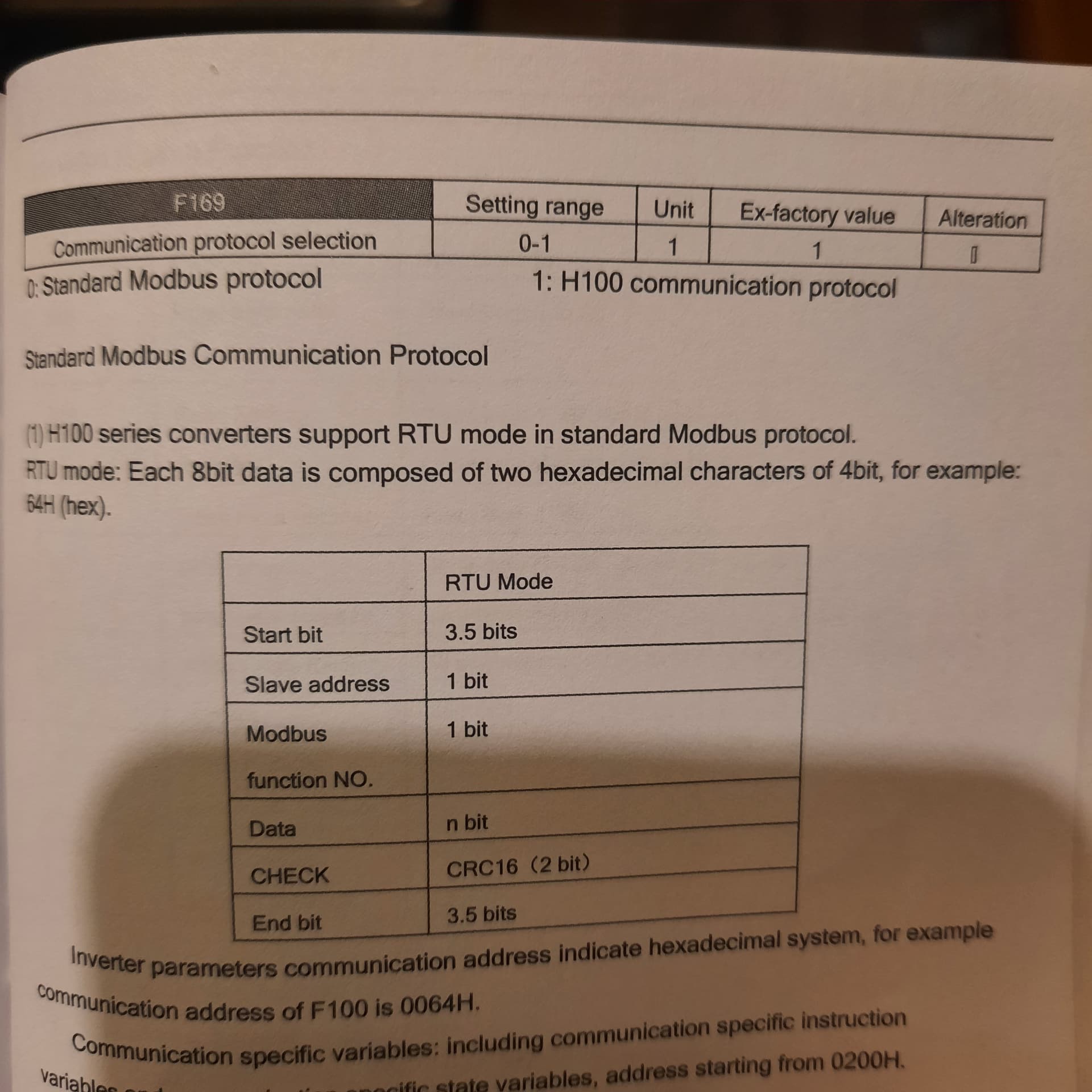

**However this setting, F169** , does not exist on the Huanyang:
![OMC_V70 __P067__ Communications_Settings_2](https://us1.discourse-cdn.com/flex022/uploads/onefinitycnc/original/3X/5/a/5a7e8c8694f52df0417199951e95e1c876f7ed87.png)
Did you set it to “0”?

Mmm that’s a setting I did not realise may need modifying from default, mine is not the stepperonline badged version, my manual is virtually the same just the names are different on branding…H100 vs V70 as per the manual I referenced, I can’t find the manual online for my one but I read it could be a more updated HY.
 ![20211107_160329](https://us1.discourse-cdn.com/flex022/uploads/onefinitycnc/original/2X/c/c3ed3af3e1f987ae2a5051018ac94d0fc4c28a72.jpeg)
I will give that a try shortly, good spot.

It was actually already set to standard mode, I tried both settings to no avail. I may carry on with the setting up and run the spindle manually for now, keen to get a wasteboard down and do some test pieces.
