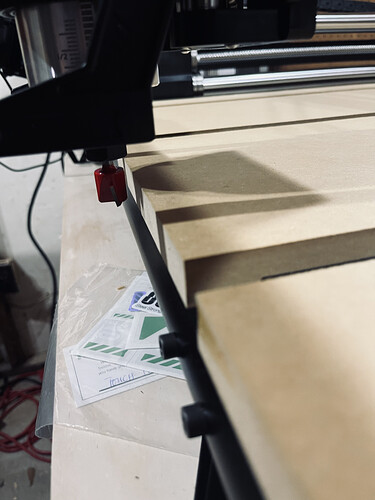

I got my woodworker set up with my QCW and was preparing to do a surface toolpath, I homed it, but as I zeroed my x and y axis at the center of the wasteboards (at the halfway points of the overall dimensions of the QCW board surface: 20 3/4" and 17 11/16"), and the y axis errored that the toolpath would put it over the limits. I ran the y axis front to back, and I noticed that when the router is full forward, it is actually about a half inch past the board surface. Is this normal?

Hey Gil,
> [@gilbee](#):
I already gave you the answer here:
> [@QCW - Any reason to not have surface under it same dimensions?](https://forum.onefinitycnc.com/t/qcw-any-reason-to-not-have-surface-under-it-same-dimensions/25279/2):
> I wonder that you haven’t found the answers with the search function, as this was discussed thourougly and is asked (and answered) frequently.
> > [@Size of physical table actually needed](https://forum.onefinitycnc.com/t/size-of-physical-table-actually-needed/18864/3):
> > See also [dust boot overhang (front](https://forum.onefinitycnc.com/t/the-table-basic/3787/99) and [rear](https://forum.onefinitycnc.com/t/the-table-basic/3787/103)),
> **The QCW frame is not where the workarea of the machine is.** While at the front you have the milling motor (router or spindle) and also the dust boot **protruding the QCW frame beyond the front edge of the frame** , where there is no wasteboard but only air, there is a portion at the rear of the QCW frame **that the bit will never be able to access.** You can make your wasteboard slats much shorter in the rear for this reason. You will not be able to surface this region when you want to surface the wasteboard.
> [@gilbee](#):
This means that you have a g-code program loaded that would mill outside the workspace of the machine (outside the limits). Either you adjust the size of your 3D model so that it fits the workspace of 816 × 816 × 133 mm (165 mm for Z-20), or you set the workpiece zero (by probing or manually setting it) at a position so that the 3D model does not exceed the limits of the machine.
Since your 3D model is 527 cm × 449 cm wide, which is smaller than the X and Y dimensions of the Woodworker machine so should fit, I suggest to assume that you’ve set your zero coordinate on the real workpiece center at the wrong position, as the 3D model seems to exceed the workspace limits (=does not match the real workpiece’s position)
The _workpiece zero_ **you probe or set manually on the real workpiece** has always to be at the same position as the workpiece zero (workpiece “origin”) in your 3D model.

So what you’re saying and what I’m seeing is, by inference, if one uses the qcw provided by onefinity, you don’t actually get 32x32” of cutting area?
With all of the documentation provided for the unit, why would that not be disclosed somewhere in the manuals or specs?
I did read your comment about the dust boot hanging over, but missed that the bit would also be outside the board.
So, with the qcw, what I actually have is 31x32 cutting area, is that right?

As explained above, neither the QCW Frame nor its wasteboard slats are where the machine’s workarea is (=the area between the limits of where the milling motor can mill). You already discovered that. So you got to create a virtual 3D model that corresponds to not more than the **real** workarea (which is 816 × 816 mm on Woodworker, however on the front there is no wasteboard so you would “mill air” there, which does not harm) and then to position it **not in the middle of the QCW frame** (as explained above), but in the middle of the Woodworker’s **real workarea**.
The questions you should ask yourself are:
1. What are the dimensions of your virtual 3D model?
2. Did you probe or set manually _workpiece zero_ so that the 3D model is **inside the limits of the machine’s real workarea** (the limits of where the milling motor can mill) (and not in the middle of the QCW frame, nor in the middle of the area covered with wasteboard slats, which both will not be correct).
Note that you could also make your life easier and use the front top left corner as the workpiece origin. Then you measure the area that is covered with wasteboard slats and create a virtual 3D model of this size, and then you probe the workpiece zero by using the [XYZ touch plate](https://www.onefinitycnc.com/product-page/onefinity-3-axis-touch-probe) on the front top left corner of the leftmost wasteboard slat. This way you avoid the necessity to know how much the real machine’s workarea is shifted in relation to the area covered with wasteboard slats of the QCW Frame (that also depends on whether you have Z-16 or Z-20 Z assembly, 65 mm or 80 mm milling motor, so cannot be known as one general value).
Since with this method you include the area that is not accessible on the rear, you will still get a limits error, but when you jog your router/spindle to the back and mill a thin line of shallow depth with a V-bit, you can mark a line at the end of the real workarea, and this way you can know how much of the rear region is not accessible and subtract it from the virtual 3D model’s depth dimension, until you get no limits error anymore.
You could also jog around all four sides at their extreme limits, milling a thin line with the v-bit, to see the real workarea of the machine.
You already know, as I explained above, that there is a rather large portion of the area where the t-tracks reach to the rear and that can be covered with the wasteboard slats, that never will be accessible by the milling motor. If your virtual 3D model includes this region in the rear, it’s clear that you get a limits error. You cannot surface or mill in this rear area. That’s a design issue of the QCW Frame and can only be avoided by not using the QCW frame, but building your own machine base instead.

You still have the workarea of 816 × 816 mm (32" × 32"), but when using the QCW Frame, there is a region in the front where there is not wasteboard, but only air.

The exact value of the area that has no wasteboard depends on whether you have Z-16 or Z-20 Z assembly installed, and 65 mm or 80 mm milling motor, so cannot be known as one general value.
You still have the entire accessible workarea like the machine is sold with, but with QCW Frame the wasteboard slats do not reach to the front of the machine’s real workarea. If you manage to have some additional wasteboard there, you could use the entire workarea.

So then my assessment above that I don’t actually have a 32x32 cutting area when using the QCW is seemingly accurate since the QCW will not actually be under the full 32x32 cutting area of the unit for the non-elite models, and even for the elite models part of that 32x32 space would potentially be taken up by the tool setter. Is this documented anywhere in the presales materials where I could have found out this fact before purchasing the configuration that I ultimately chose? If not, this seems like a misstep, not sure if it’s a misstep of marketing or design…
**Post date:** [February 17, 2024, 1:04am UTC](https://forum.onefinitycnc.com/t/is-this-normal-router-at-home-on-y-axis-in-front-of-wasteboard/25321/16 "2024-02-17T01:04:22Z")
Hey Gil,
it is not the design of the Onefinity CNC machine that makes a region of the workarea unusable, it’s the QCW Frame. Its wasteboard slats and T-tracks cover an area that is not identical with the machine’s workarea.
Before the QCW Frame was offered, the machine came – and still comes – without a machine base, you got to provide one yourself, and if you follow the advices regarding [space to reserve around the machine](https://forum.onefinitycnc.com/t/1st-post-size-matters-and-vertical-clamping-for-finger-joints-tenons/18074/3) when building a machine base (most use a table with a tabletop), the entire workarea will be usable.
Regarding the toolsetter, the area that it needs is rather small. You could also imagine a pivoting toolsetter that is out of the way when machining the workpiece. On industrial machines, you loose even more workarea for a tool magazine or an area where a tool revolver magazine is accessible (usually on right rear end of the workarea). Some machines have an X axis that is longer than the usable workarea, just to be able to drive the spindle over a carriage with a tool magazine.
I think what Onefinity sells you is a true 32" × 32" workarea, because usually this means the limits of the axes travel. For a Woodworker model, this is 816 × 816 mm, as shown in the “Limits” sections of MOTORS 0–2.
So I agree that many things should be better documented, in this case it’s the QCW wasteboard and T-tracks area being not identical with the machine’s workarea.
