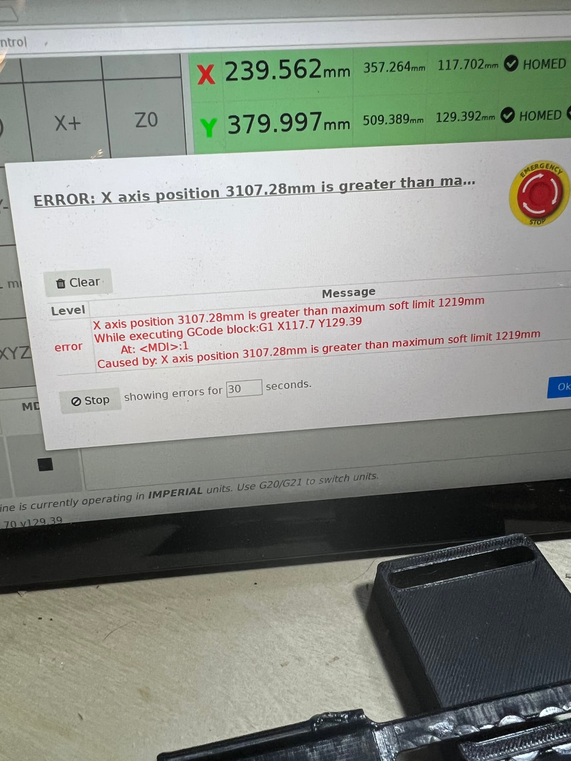

So I decided to give it a try tonight. unfortunately it didn’t work.
I first moved the router to a different section of the board and tried to get it to go home with the g01 command. It gave me an error so I shortened it from 117.103 to 117.10. Same with Y. This time nothing at all happened. No movement or error.
Later on in the evening we had a power outage due to storm. Thankfully I was already at my 0,0 so I can run the rest of the job without homing. But just for fun I tried it again and this time got the error below. It doesn’t make sense to me because the x I put in was 117.10 but it recognized it 3107.
Seems like it should be much more straightforward to dial in any spot on the board and go there. Or maybe it is and I’m just doing it wrong.
 ![image (1)](https://us1.discourse-cdn.com/flex022/uploads/onefinitycnc/original/3X/3/8/385dfe4e04f716863fbe7abce2e4bd51f8889e01.jpeg)

Hey Dave,
> [@SanderCreations](#):
what do you want to do? Is this still about [Resetting after a power outage](https://forum.onefinitycnc.com/t/resetting-after-a-power-outage/18841)?
Were you able to follow what I explained in my [reply](https://forum.onefinitycnc.com/t/resetting-after-a-power-outage/18841/3)? What you have to note or screenshot for the case of a power outage is the offsets column. These numbers say where your _workpiece zero_ is in relation to the absolute _machine origin_, so having these data is crucial. The offsets are usually created by probing the workpiece prior to running the program or at the beginning of a new tool pass. On probing, the new coordinate system is activated to have its XYZ zero position exactly where your workpiece zero is in your 3D model.
In case you had a power outage, but noted the offsets, you can enter them with the [G92 (Coordinate system offset)](https://linuxcnc.org/docs/html/gcode/g-code.html#gcode:g92) command. This corresponds to moving the machine to the coordinates that you noted (manually by jogging, or with a G0 command) and then pressing one of the **zero buttons** on the CONTROL page (available for a single axis or for XYZ). This in fact executes a G92 X0 Y0 Z0 command (or G92 _axis_ with only one axis). This is the command to set a new workpiece zero at the position that you moved to. It is also the most important command in every probing routine, as it tells the machine where the workpiece zero is, (or in case of probing after a tool change, how long the new bit is).
If you have the coordinates of the offset colum, I can tell you how to re-enter them after a power outage.

Hi.
Thanks for trying to help. Yes, i am still trying to figure what to do after a power outage. It would also be helpful knowledge when doing a multicolor epoxy inlay like I’m doing now. I have 5 colors and each one takes 1-2 days to cure. It would be nice to not have to keep the machine on and idle for that long but still be able to reliably get back to my zeros for the job. Then, i could do other projects but still get back to zero for the next color/layer.
My offsets are the same as my 0,0. Though i still don’t think I understand how to use the g0 or g92 commands.
 ![image](https://us1.discourse-cdn.com/flex022/uploads/onefinitycnc/original/3X/9/a/9a1b5315ffeb89ddd6bc74fbeab86115920546a6.jpeg)
**Post date:** [March 13, 2023, 5:39pm UTC](https://forum.onefinitycnc.com/t/keeping-zero-position/14115/46 "2023-03-13T17:39:23Z")
Hey Dave,
noting and restoring the offsets makes only sense if you let the workpiece clamped on the machine bed until the next pass. If you reposition it, you would re-probe instead.
Let’s say you have a workpiece clamped on the machine bed and prior to first pass, you probe XYZ. The result is that you have the offset numbers which in fact designate the _workpiece zero_ in relation to the absolute _machine zero_.
- If you let the machine on until next pass, you avoid homing and you can directly run the next pass, as these values did not change.
- But if you switch the machine off or have a power outage, you got to re-enter these offsets before you can run the same program (or a pass that is based on the same program and workpiece) again.
To enter these values, you use the G92 command and you enter it into the command entry field of the MDI Tab, _but with their sign changed (i.e. the [Additive Inverse](https://en.wikipedia.org/wiki/Additive_inverse))_:
Let’s say according to your image, your offsets for the workpiece were X=117.702, Y=129.392 and Z=-57.41. You re-home the machine, then you enter this into the command entry field of the MDI Tab:
`G92 X-117.702 Y-129.392 Z57.41`
Take care of the signs in front of the numbers, which were changed!
This command activates a new coordinate system, which is the _workpiece coordinate system_, which has its zero exactly where the workpiece zero is in your 3D model.
You can check whether a G92 offset is active by entering:
`(debug, Offset=#5210)`
If the output is 1, then there is a G92 offset active, if it is 0, not. (Don’t forget the parantheses when you use ‘debug’.)
Now to go to the workpiece zero, you enter:
`G0 X0 Y0 Z0`
Magic, eh? 😉
To delete any offset, use
`G92.1`
PS: If you forgot to note the offsets and they were lost due to a power outage, they can be extracted at any time later from the file /var/log/bbctrl.log.

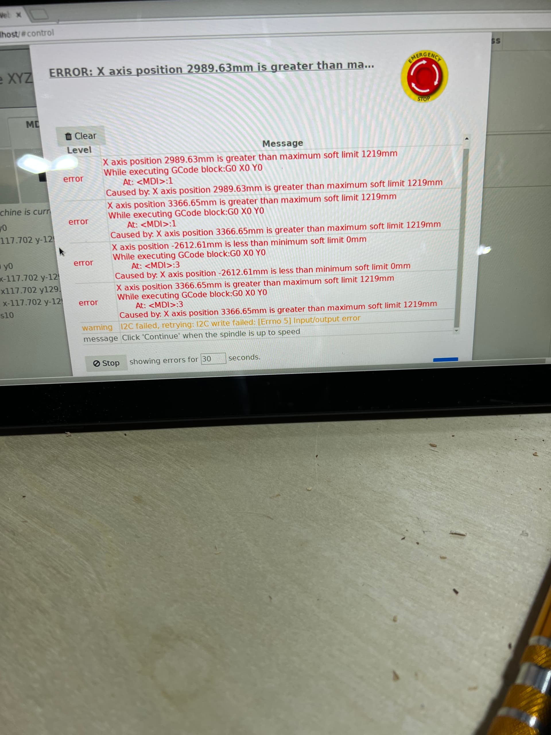

**Author:** ![SanderCreations](https://sea2.discourse-cdn.com/flex022/user_avatar/forum.onefinitycnc.com/sandercreations/32/21310_2.png) [@SanderCreations](https://forum.onefinitycnc.com/u/SanderCreations)\
**Post date:** [March 15, 2023, 5:47am UTC](https://forum.onefinitycnc.com/t/keeping-zero-position/14115/51 "2023-03-15T05:47:28Z")
Thanks for the advice Aiph5u. I did give it a try tonight and unfortunately, still no luck. I put in the offsets as you suggested, with the negative numbers and using the g92 code. Then I used the go code and got the error in the picture below. I tried positive numbers just in case, but still got an error. I also tried to use the debug as you suggest but there is no = sign on the buildbotics screen so couldn’t put that in.
 ![image (1)](https://us1.discourse-cdn.com/flex022/uploads/onefinitycnc/original/3X/8/f/8fd5b41c62dccd9cd6ea26c9dfcf9189159ebb9c.jpeg)

**Post date:** [March 15, 2023, 9:22am UTC](https://forum.onefinitycnc.com/t/keeping-zero-position/14115/54 "2023-03-15T09:22:58Z")
Hey Dave,
what exactly did you do? I’d really like to provide support, but I can not diagnose what happened without the _positions, absolute positions and offsets before_, a step-by-step description of _what you exactly did or entered_, and how the values are _after_ your input.
The values in your error screen photo suggest that we didn’t or don’t have a situation like I described before or that you described, or that you entered something different, or you entered something else earlier that you forgt to mention(!). **Numbers like 2989.63 mm are much too big and I cannot see any reason where you got such values from** (except if you had units set to imperial and entered millimeters!)
I have tested all my suggestions on my controller and it worked perfectly.
Can you provide the details requested above?
**Post date:** [March 15, 2023, 10:13am UTC](https://forum.onefinitycnc.com/t/keeping-zero-position/14115/55 "2023-03-15T10:13:22Z")
Hey Dave,
> > [@349iq2345](#):
**oh man, you really did!** 🙂 You really entered 117.702 mm but you were in _imperial mode_. I just tried to reproduce your numbers. That exactly gave me _“X axis position 2989.63mm is greater than maximum soft limit”_, exactly as in your screen photo. Okay, it’s clear that cannot work, if you mix up units modes ☹
[G20, G21 (Units mode)](https://linuxcnc.org/docs/html/gcode/g-code.html#gcode:g20-g21)
G20 ; Set imperial units mode, use inches for length units.
G21 ; Set metric units mode, use millimeters for length units.
Okay, with making sure to stay with one unit system during one operation, everything should work.
