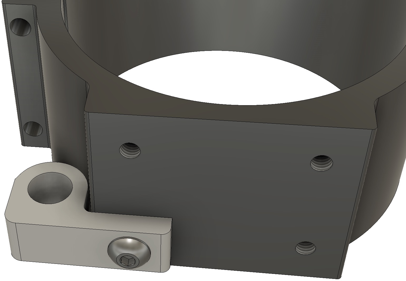

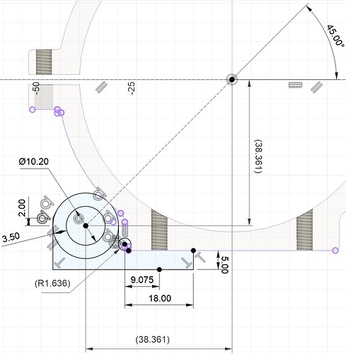

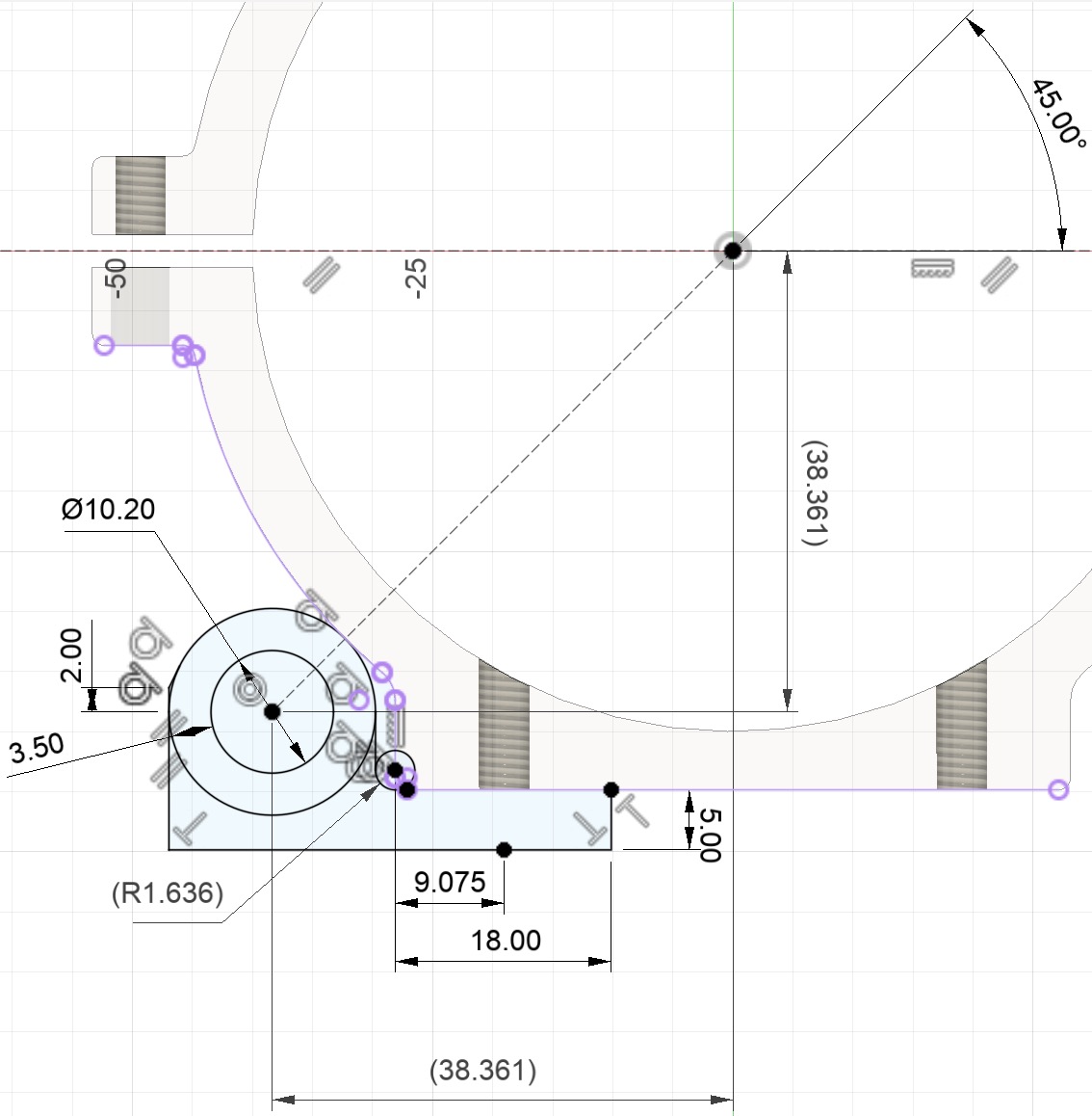

Tom. All heights aren’t hard to accommodate. It takes a few tries adjusting to keep the crosshairs (or spot) stationary as Z is jogged up and down. I was going to cut a more adjustable holder with set screws but the one pictured works well enough.
Here’s the holder modeled in Fusion. It is about as close as possible to the spindle axis and the pointer has equal X and Y offsets from that axis.
