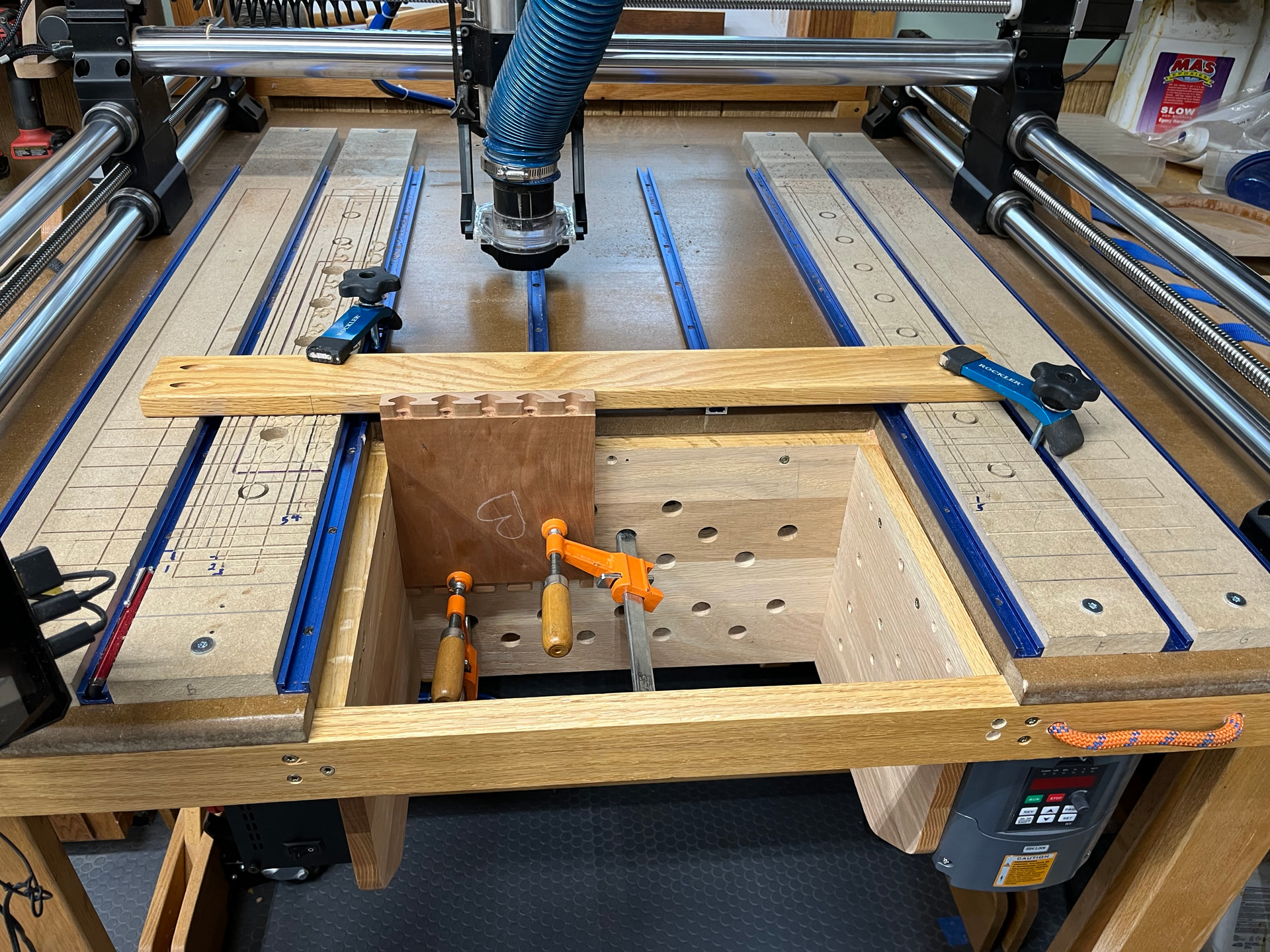

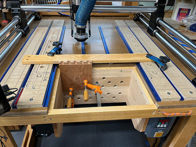

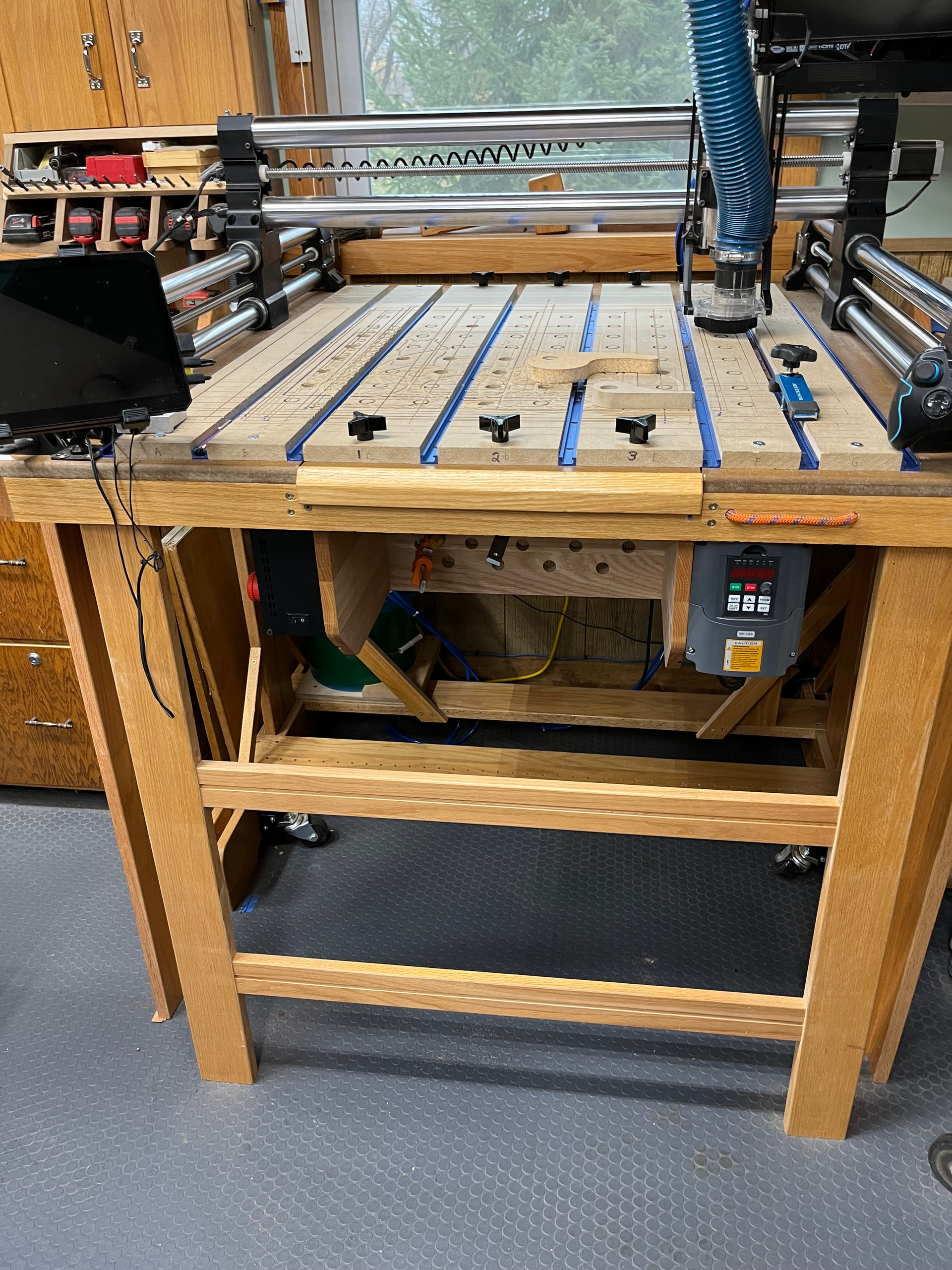

Hi Rick,
I have a woodworker and 4 years ago was excited to build a folding tabletop. I had a bunch of oak from an old library. I should have done more research, but I am very happy with the results. There are some good plans out there.
A. I’m a strong advocate of a vertical hold system. It allows a lot of creativity, especially for unique joints.
B. Photo…just guessed the pivot point (pipe) should be about 2/3 up, this allowed hinge swing legs to fold under or out when setting up. Happy with the stability. ( When folded, If the router/spindle is at the high point, easy to swing, if it is low, strong muscles, or I use sticks to keep it high.
C. I just order the upgrade Redline motors etc. Did I leave enough clearance for the new motors? Time will tell……I have to admit I rarely fold the table up anymore. Plan your setup for future upgrades!
somewhere under this topic are a lot of photos or this and various designs, good luck! Bill
