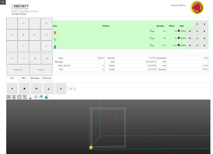

If your XYZ is showing yellow and displaying over or under after you’ve homed (remember, it is normal for the z to show yellow after homing), it mean’s that your cutting area is outside of the limits of what the Onefinity can cut. In this case, the waste board flattening file is larger than the actual cutting area of the machines capabilities.
To correct this, create a new file that is slightly smaller than 32 1/4 (the woodworkers limits) or 16 (the machinists limits). They should all turn green after homing and zeroing.

Here’s a screen shot of when things are correct. The x y and z have been homed AND zeroed. They also have enough room to move from their starting point and can complete the cut.

It’s not a homing issue. UNDER/OVER is a toolpath issue. it means your going to cut (whatever file is currently loaded) out side of the machine boundaries. After setting ZERO for xyz (not homing), if things are correct, they should all go green.
There’s been a lot of (understandable) confusion between successful homing and under/over toolpaths. Our next update will clarify those two things.

over under no fit messages will react to whatever file (and i’d guess in this case the last file) is loaded in the controller.
**Post date:** [October 15, 2020, 11:29pm UTC](https://forum.onefinitycnc.com/t/machine-axis-show-yellow-and-display-over-or-under/903/13 "2020-10-15T23:29:10Z")
you won’t be able to probe in the VERY lower left. There’s a boundary that the machine can reach, and if the probe is out of that boundary it will error. With the smallest bit in the router, jog the machine to the very front left. Anything to the left or front of that bit is ‘out of bounds’ or under.

I’m not probing in lower left limit - I am only homing. Then probing X-Y-Z at the lower left corner of the project piece which is inside of the limits. Am getting the ! Under when I home before probing. Thought you needed to home at lower left limits to orient the machine - is that not the case?
**Post date:** [October 15, 2020, 11:59pm UTC](https://forum.onefinitycnc.com/t/machine-axis-show-yellow-and-display-over-or-under/903/15 "2020-10-15T23:59:56Z")
We’re releasing an update tonight that will make homing and toolpath more clear.

We just released a firmware that should clear up homing and over/under.
[https://forum.onefinitycnc.com/t/firmware-update-1-0-5-10-15-2020-newest-firmware/1234/2](https://forum.onefinitycnc.com/t/firmware-update-1-0-5-10-15-2020-newest-firmware/1234/2)
