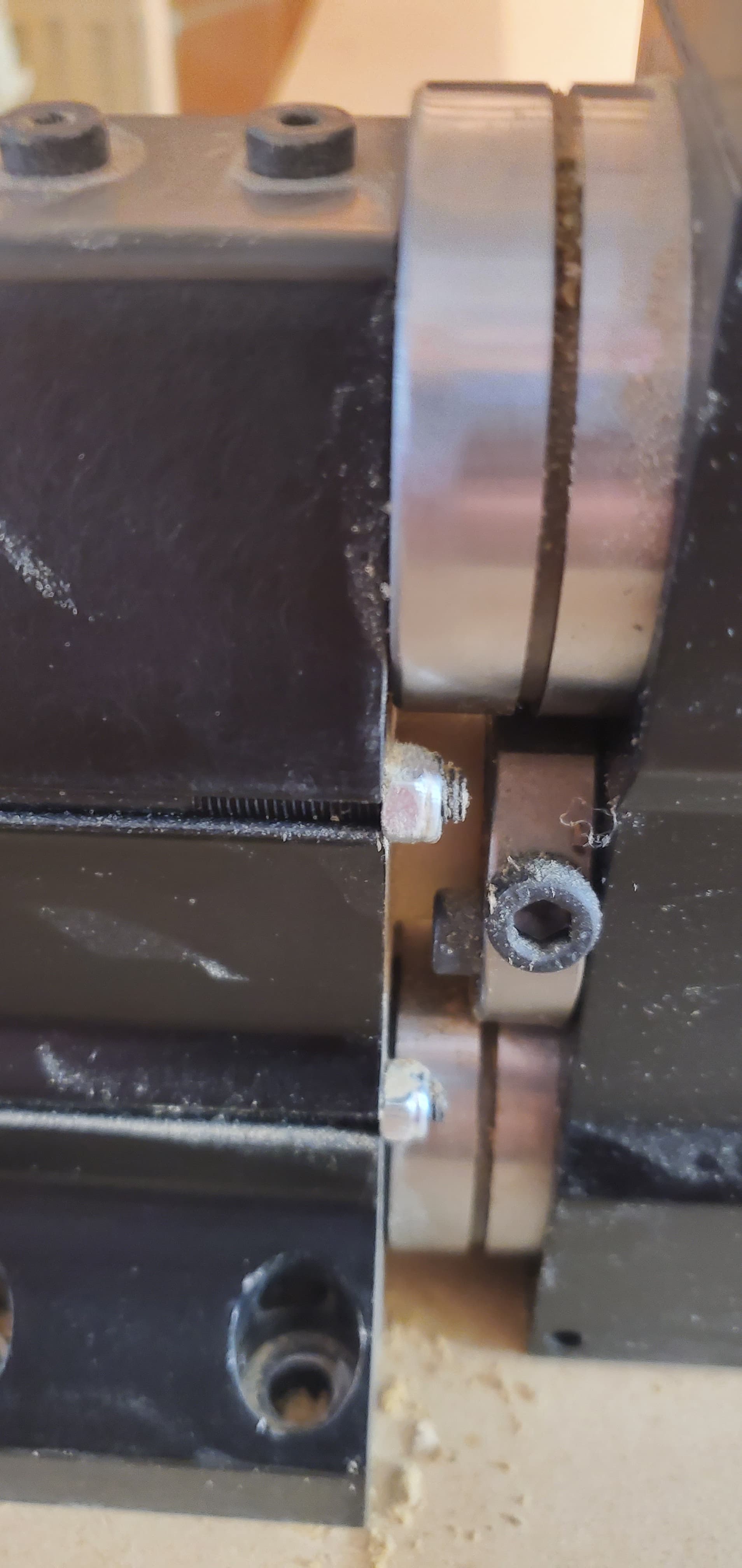

Is this normal? It’s driving me absolutely crazy and I feel like it’s making my larger cuts crooked by 1/16th to 1/8th. I’ve attempted to cut some larger pieces [24x48] and both have came out slightly crooked so that’s why I’ve tried to re assemble and tram my machine. Any tips or reassurance would be helpful! Thanks
 ![20230721_030041](https://us1.discourse-cdn.com/flex022/uploads/onefinitycnc/original/3X/a/f/afe2068cc5034fa5e61939e19005d7ee0507fc2b.jpeg)
 ![20230721_030025](https://us1.discourse-cdn.com/flex022/uploads/onefinitycnc/original/3X/9/c/9cbb7496ac2d17d3a3ff60fc67212ffeb7bd6d16.jpeg)
 ![20230721_030125](https://us1.discourse-cdn.com/flex022/uploads/onefinitycnc/original/3X/2/3/239c22346024d552d94f1b7c276543592fd82dc4.jpeg)
 ![20230721_030122](https://us1.discourse-cdn.com/flex022/uploads/onefinitycnc/original/3X/5/f/5fcffb2597425e88977d72c7d87b952c1e0a2f50.jpeg)

After doing some research and banging my head against the wall for several hours I think I may have fixed this issue by turning off the machine and loosening the bolts on my X Rail and then pulling all the way back flush. I think the bolts on the left side rail were a little over tightened this time around and it was causing the left side to pull back after homing the machine. Prior to this I checked to make sure everything was square and everything checked out. I also watched the stall homing video from onefinity and changed the stall current on my Y axis but that didn’t help with the issue. Now I will be reverting back to the default setting tomorrow and I will check again to see if the issue has been fixed. [crosses fingers] Will follow up if the issue is resolved!!!

Kevin, I’m only seeing 1 screw holding the feet down. Did you only put 2 screws in each one? It appears to be a smallish screw at that. It’s really an important assembly point to have the machine secured down with 4 large screws at each corner. Think about the mass of the gantry when it’s traveling along the Y axis. Now think about all that mass traveling fast, and _immediately_ changing directions of travel. All that inertia is transferred directly to the machine feet. So if they’re not seriously secured, it will cause issues.
**Author:** ![do1nth4ngs](https://sea2.discourse-cdn.com/flex022/user_avatar/forum.onefinitycnc.com/do1nth4ngs/32/24854_2.png) [@do1nth4ngs](https://forum.onefinitycnc.com/u/do1nth4ngs)\
**Post date:** [July 21, 2023, 1:06pm UTC](https://forum.onefinitycnc.com/t/machine-has-a-gap-on-the-back-side-after-third-setup-attempt/21525/5 "2023-07-21T13:06:13Z")
Hey Bill, thanks for the quick reply! No worries, that’s a very valid point and I definitely make sure to always have four screws in each foot. These were the screws that actually come with the machine but the picture probably makes them look a lot smaller from that angle. I started to take the machine apart to realign and square everything once again but I remembered to snap a picture before I went any further. I had surfaced a fresh wasteboard earlier in the day so the machine was quite dusty and in need of some much needed cleaning. I originally was thinking maybe from all the dust with mdf I might’ve had a dust buildup that could’ve been causing an issue with the alignment. I did manage a quick cleaning before setting everything up again to make sure that wasnt an issue and that didnt seem to be q concern. I still need to clean those ball screws now that I think about it and add some 3 in 1 just to keep everything up and running smoothly. I’ve had my Journeyman for about 8 months now and I’m really impressed with the machine but I have been going crazy trying to figure out why it was off on my last few projects. I’ve been trying to pick up some more business and I really need to get this thing dialed in because I almost ruined a few nice pieces of wood in the process. Luckily I was able to salvage most of it and repurpose the large sheets of plywood that come out slightly crooked. Hopefully with my new microjig system for the wasteboard and clamps, plus adding some squaring points and a fence, this will help me keep everything nice and straight if the machine is not out of square. I’ve been using tape and a large grid but I had some doubt with how that would work out long term with some of the large projects I need to produce. Later today we will try to accomplish the wasteboard and post the outcome. Thanks again!

You were spot-on correct in checking for dust build-up on the ends of the bearings, which can and will have a direct impact on repeatable and accurate homing. That said, I always recommend installing hard-stops on the X and Y axis. These will lose you about 1mm of overall travel, but should help ensure more repeatable homing while minimizing the effects or concern of homing against compacted wood dust. I don’t have the link to what I used for this, but I hope @349iq2345 will check in here. Not only is he one of the most intelligent, knowledgeable people I have ever met, he also has bookmarked many commonly referenced topics on the forum.

Hey Kevin,
1. If your machine after homing shows a gap between the linear bearing (the big chrome-plated cylinder that sticks out the Y carriage) and the black **front** foot block on one Y side, but not on the other, l would first check if the distance with which the linear bearing sticks out of the Y carriage towards front _is the same on both sides_ (same on left Y carriage as on right Y carriage).
[![f704eb_79f93b74ee464b4b8e00184c30a45845~mv2](https://us1.discourse-cdn.com/flex022/uploads/onefinitycnc/original/3X/a/1/a12d63b4a157e3f3dd35879b948aeae4a2259f07.jpeg)](https://www.onefinitycnc.com/product-page/35mm-linear-bearing)
_Image 1: One of two linear bearings used in a Y carriage._
They are held with grub screws and it is not impossible that they are not equal.
→ If you finally measure the “gap”, don’t measure this gap, i.e. measure **not** from linear bearing to black front foot block, but from (black) Y carriage block to black front foot block. (by the way, one of the purposes of Bill @Machinist’s homing stops is that on stall homing, it bumps against carriage block and not against linear bearing)
1. Did you already check your machine for **rectangularity** , like → [described here](https://forum.onefinitycnc.com/t/what-do-i-do-first/18349/6)? If you didn’t yet, **please do it now**. If then still there is a different distance between (black) Y carriage block and (black) front foot block on one Y side than on the other, you can do this:

Hey Bill, No offense was taken whatsoever! I do understand that in most cases the machine isn’t at fault but yet its user error from lack of experience, overlooking something by accident, or even frustration. Not to toot my own horn here, one of my best traits in my opinion is my patience and my ability to stick through any adversity with problem solving. Some people do tend to give up easily or become rude, nasty, and flat out unprofessional. If I have a mental breakdown its usually in my own space… :] I might have a few words with myself but, I do not give up or take out my stress on others in online forums. Whenever I just have a bad string of things not working out, I usually step away for a few and give it another go when I’m focused and thinking clearly.
With that being said I truly appreciate, respect, and value you for taking your time to share your knowledge and experience with not only me but others in the community. Thank you for recommending the hard stops!! I purchased a set right after reading your comment. I do tend to seek perfection and that’s the main reason I just couldn’t let the issue slide [no pun intended] until I get this thing dialed in. I’m no professional in the CNC world but I do value solid advice and criticism from others more experienced than myself. The best way to gain knowledge is by making mistakes, solving problems, and learning from it… Taking advice from someone more experienced than myself is a luxury I don’t take for granted. I’m happy to have you both in my corner!
I do believe my issue was user error and I’m hoping I’ve fixed the issue by adjusting the over tightened screws on the left side of the X rail. This side seemed like it was a bit tight compared to the right side so I fit them both just snug in place. This was causing the left side to pull forward slightly after rehoming the machine. My first attempt at setting up the machine I didn’t have the issue in the front but on the backside as stated. After removing the bolt on the X axis, the Y axis slid right back into place with no issues. I turned the machine back on and it was aligning perfectly everytime I homed the machine. Prior to this, I did check for square by measuring diagonally corner to corner, and measuring side to side in the front/back to check for square. Everything measured correctly… Wish me luck that this resolved my issue, and I can get back to making some beautiful projects with this awesome machine!! Thank you for your time Bill and Aiph5u!
