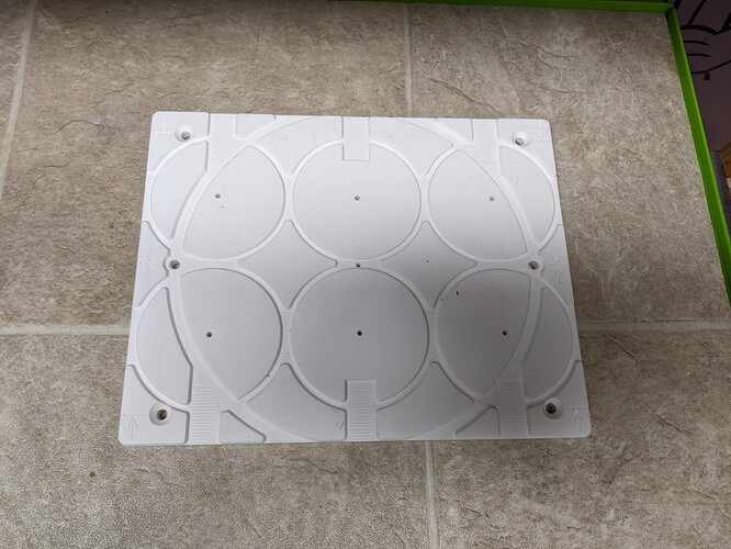

As I was making some elaborate 5 1/2" coasters for someone, each one had a full run-time of about 3 hours (I made 4 of them). I couldn’t stand the thought of that kind of wear & tear (hammering the z axis that long) on my primo precision machine, so I decided to get a “3018” machine to take care of the non-precision stuff like coasters. I got a version sold by mysweety on Amazon. This $318 machine is actually pretty nice. I was impressed with the machine overall, although I haven’t run a job on it yet (just dry-run). It’s obviously no precision/quality match to the Onefinity but my gut impression is that it’s a notch above a base X-Carve, although much smaller than either.
 ![PXL_20220511_133345830](https://us1.discourse-cdn.com/flex022/uploads/onefinitycnc/original/2X/0/017676b62d7716ab1876158f155f55c1a02e1326.jpeg)
 ![PXL_20220511_220642138](https://us1.discourse-cdn.com/flex022/uploads/onefinitycnc/original/3X/c/e/ce754d5397c7ecccca8f92c2a6dead1d33f0ddc8.jpeg)

Hey Matt, I use a couple different types of vinyl flooring. I started out using Smartcore Pro from Lowe’s (1/4" thick with padded back), but since have started using 1/8" self-stick vinyl & backing it with cork backing I got from Amazon. The gun coaster is the one with the tremendous run-time, the others vary. Coasters are very enjoyable to make, and don’t require any finishing other than I spray them with clear polyurethane to bring out the core color. Here’s a few examples of what I’ve made. The gun coaster is 5.5", the Flint coaster is 8", and all others are 3.75". The gun coaster & North Valley coasters are made with the thinner self-stick flooring, all others are from the thicker Smartcore flooring. The job running on the Onefinity is a new coaster fixture for the 3018 that will allow me to run 3.75" or 5.75" coasters. I have other fixtures that allow me to do up to 6 at a time.
 ![PXL_20220512_130151844](https://us1.discourse-cdn.com/flex022/uploads/onefinitycnc/original/2X/f/f0e5c58caa0d39c3648077fe6406de6ddac8c61c.jpeg)
 ![PXL_20220512_131016765](https://us1.discourse-cdn.com/flex022/uploads/onefinitycnc/original/2X/a/a6daa14b66ffe625def01098fcf90420b0f6e6c9.jpeg)
 ![PXL_20220512_130016456](https://us1.discourse-cdn.com/flex022/uploads/onefinitycnc/original/3X/b/7/b758210aced4aa764feba3b8c963c1be6d097426.jpeg)
 ![PXL_20220512_130236309](https://us1.discourse-cdn.com/flex022/uploads/onefinitycnc/original/3X/c/8/c834b03fb2cac53e156662b8cf758e6617275e5a.jpeg)
 ![PXL_20210413_192313947](https://us1.discourse-cdn.com/flex022/uploads/onefinitycnc/original/3X/5/6/56d6a8e287b650284f497776e2e6aa9817401f8e.jpeg)
 ![PXL_20210406_155745529](https://us1.discourse-cdn.com/flex022/uploads/onefinitycnc/original/3X/2/b/2b990c55c83c1e9d251306ac9351ad43b756f350.jpeg)
 ![PXL_20220512_133215338](https://us1.discourse-cdn.com/flex022/uploads/onefinitycnc/original/2X/5/55cea61024bbd8ac2ef749a4dab7d9153eb3426b.jpeg)
 ![PXL_20220511_225328320](https://us1.discourse-cdn.com/flex022/uploads/onefinitycnc/original/2X/8/87bfe5f5c57eed8091a64821372a44b751b2bd16.jpeg)

You’re very welcome, I hope some of that info will be helpful. I use 1/8" bits almost exclusively. On the thicker coasters I use a 1/8" end mill. On the thinner ones I will use smaller ones, especially if it happens to be a cutter I’m using on the face of the coaster. For example, if I’m using a 1/16" bit (as with the North Valley coasters), then I will also cut the outside with the same, then follow up with a chamfer.
If you make a few coasters and decide it’s something you want to do more of, it’s a good idea to make a fixture for them, such as the one pictured with the small machine above. That fixture will do 3 3/4" and 5 3/4" (or larger) coasters. I secure the flooring down with carpet tape. It’s highly desirable (and advised) to not have to cut thru the carpet tape. It makes a mess of the cutter which will require clean up before proceeding with more, and it’s just an all-around messy way to do it. Using these fixtures, I just place a patch of tape in the center to stick the flooring down to. With careful vacuuming before lifting the coasters off the tape, many times you can reuse the tape on the 2nd (and 3rd) batches. The tape tends to stick to the corian fixture plates more so than the coaster backing, so that helps.
Here’s some pics of 3x and 6x coaster fixtures. The flooring I buy is 12" x 24", so I can just squeeze 3 coasters across the 12" width of the flooring (keeping in mind there is a dimensional loss at each edge of the click & lock flooring). Hence the 3.94" spacing for 3.75" coasters, leaving room for the 1/8" end mill between them when cutting out the circles. These fixtures have an additional larger coaster circle cut in the center of each: the 3-place fixture can accommodate a 5 3/4" coaster in the center, and the 6-place fixture can accommodate a 10" table top size coaster in the center.
On the first run of any given batch, I will do the face of the coaster, then cut & chamfer the circles. On the 2nd batch, I will cut the circles, then do the face of the coasters. Just more efficient workflow if I’m doing a bunch of them.
On the thinner self-stick material I try to leave the backing paper in place and still use carpet tape to stick them down. The paper backing many times comes off when removing the coaster, but it has been kept clean for immediately sticking on the (also) self-stick cork backing. The self-stick coaster backing to the self-stick cork backing makes for a good bond that doesn’t come apart. If you have no plans of using the cork backing on the self-stick tiles, you can simply use the self-stick backing to stick the vinyl to the fixture. The self-stick goo cleans off really nicely with Kingsford charcoal lighter (my favorite cheap version of Goo-Gone or similar product).
If you want to get fancy with coasters, you can also inlay them. These coasters were cut from 1/4" corian, then inlaid with 1/8" vinyl flooring. Corian (a.k.a. “hard surface” countertop) is another material that cuts really nice.
 ![20181104_093432](https://us1.discourse-cdn.com/flex022/uploads/onefinitycnc/original/2X/8/8d9dab2313f735717ea094b7320d528e92c0f814.jpeg)
 ![PXL_20220516_211652412](https://us1.discourse-cdn.com/flex022/uploads/onefinitycnc/original/3X/8/e/8ece795eb1c100c00d33a19610b96a624eeea5b2.jpeg)
 ![PXL_20220516_211709358](https://us1.discourse-cdn.com/flex022/uploads/onefinitycnc/original/3X/d/9/d9079b1f8f815e68a9bf556a694e81deaa435d28.jpeg)
 ![PXL_20220516_211738567](https://us1.discourse-cdn.com/flex022/uploads/onefinitycnc/original/3X/6/1/61ddaa161eb06f1ae3957691b374b8d1e0ea830e.jpeg)
