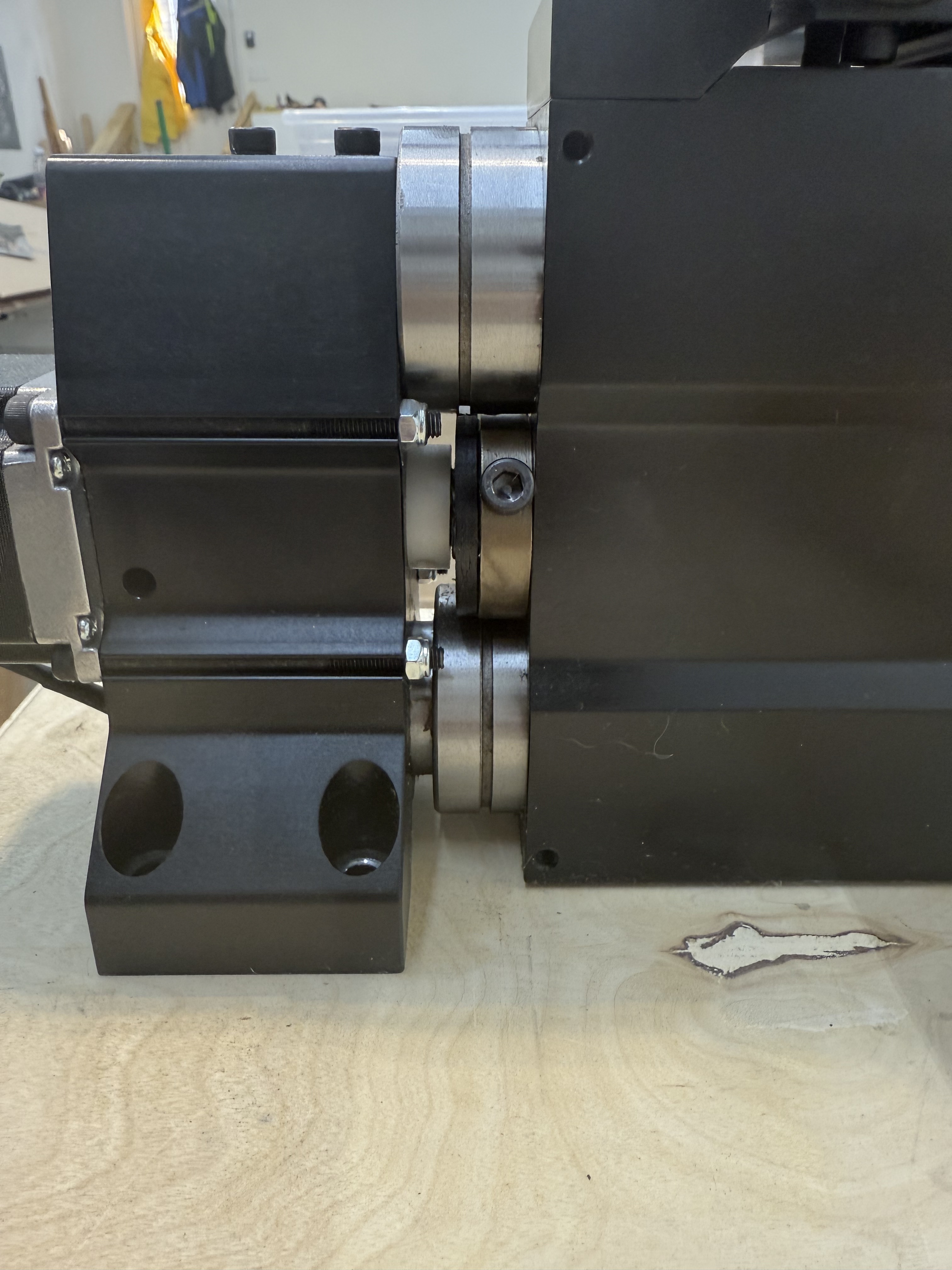

Setting up my Original Woodworker machine after a cross country move (packed in their original boxes). Seems one of the upper Y bearings has slipped such that I can’t align the machine. Is there a way to slide it back into the correct position?

**Post date:** [March 6, 2025, 8:00pm UTC](https://forum.onefinitycnc.com/t/misaligned-bearings-solved-via-faq/31375/2 "2025-03-06T20:00:57Z")
> [@How To Adjust Bearing Stick Out On Rails](https://forum.onefinitycnc.com/t/how-to-adjust-bearing-stick-out-on-rails/9746):
> There may be times you need to adjust bearing stick out on the rail bearings. If you look at the picture below, you’ll see 4 green arrows pointing to holes. These holes have grub screws inside. These grub screws hold the 4 bearings in each gantry block. There are 4 holes and grub screws on either side of the block, for a total of 2 grub screws holding each bearing in place. To adjust each bearing, simply loosen the two corresponding grub screws adjust the stick out of the bearing, and retig…
