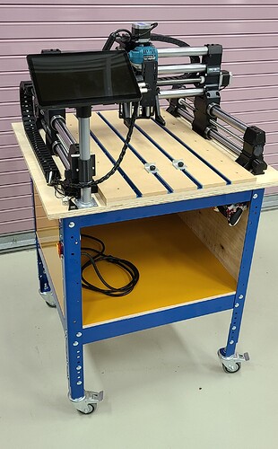

Here is my build, few more things to do then on to the fun. Thanks

@imgona, Very nice. I went with Kreg table as well for my woodworker. Whats the black box on the left (not the power strip)?
**Author:** ![imgona](https://sea2.discourse-cdn.com/flex022/user_avatar/forum.onefinitycnc.com/imgona/32/1691_2.png) [@imgona](https://forum.onefinitycnc.com/u/imgona)\
**Post date:** [June 28, 2021, 7:50am UTC](https://forum.onefinitycnc.com/t/my-1f-machinist-setup/6410/4 "2021-06-28T07:50:46Z")
Bill, it had to be mobile and able to fit through the shop door.
Rocky, the black box is the JTech Laser controller.

Hi, your set up looks great, can I ask if you made the monitor stand yourself or purchased it from somewhere, it’s just what I’m looking for
Thanks in advance
Dave
**Post date:** [June 30, 2021, 11:19am UTC](https://forum.onefinitycnc.com/t/my-1f-machinist-setup/6410/11 "2021-06-30T11:19:38Z")
Dave, I purchase part of it (it’s a short metal table leg), 3D printed a mount for the monitor and a mount for the touch plate. Thanks

Looks very tidy and inviting! One suggestion, it might be a good idea to route the estop closer to where your body will be. Hate to climb inside the box in an emergency. And, the digital estop on the screen isn’t good enough. I wish they would just drop those since they give a false sense of security.
**Post date:** [June 30, 2021, 12:41pm UTC](https://forum.onefinitycnc.com/t/my-1f-machinist-setup/6410/15 "2021-06-30T12:41:22Z")
Thanks Brad, please look at the left side below the monitor. ALL power is routed through the KREG switch. Do appreciate the suggestion.

Can I ask does the E stop switch on the control just cut power to the machine and if so is there a potential to cause any damage to it
I understand the router power is a separate supply.
And if so is there any reason not to extend the e stop to somewhere more suitable if you decide to locate the control box somewhere under the bench top like this example
Regards
Dave
**Author:** ![Hermsen.BJ](https://avatars.discourse-cdn.com/v4/letter/h/779978/32.png) [@Hermsen.BJ](https://forum.onefinitycnc.com/u/Hermsen.BJ)\
**Post date:** [June 30, 2021, 9:29pm UTC](https://forum.onefinitycnc.com/t/my-1f-machinist-setup/6410/17 "2021-06-30T21:29:02Z")
Any time a raspberry pi is powered off abruptly there is risk of corrupting the SD card. That said, the e stop used in cases it should be (actual emergency not just as a power button or convenience stop everything because you get frustrated), a bit of manual effort should that happen (rare) would be acceptable
**Author:** ![Buddy](https://avatars.discourse-cdn.com/v4/letter/b/e5b9ba/32.png) [@Buddy](https://forum.onefinitycnc.com/u/Buddy)\
**Post date:** [June 30, 2021, 10:37pm UTC](https://forum.onefinitycnc.com/t/my-1f-machinist-setup/6410/18 "2021-06-30T22:37:24Z")
Yes, I completely understand that the E stop should only really be used in an emergency and not for convenience, I am pretty sure I will locate my control under the bench top and was thinking of adding a NVR switch to cut the machine (Control) and router power in an emergency in an accessible position,
does anyone see a problem with doing that?
Dave
**Author:** ![braddo](https://avatars.discourse-cdn.com/v4/letter/b/35a633/32.png) [@braddo](https://forum.onefinitycnc.com/u/braddo)\
**Post date:** [June 30, 2021, 11:48pm UTC](https://forum.onefinitycnc.com/t/my-1f-machinist-setup/6410/19 "2021-06-30T23:48:06Z")
Fantastic, I did not see/recognize that switch. Well done!
**Post date:** [July 1, 2021, 7:10am UTC](https://forum.onefinitycnc.com/t/my-1f-machinist-setup/6410/20 "2021-07-01T07:10:57Z")
Dave,
I see no problem with it and agree you would want an E stop is a location you prefer (as that’s what I did with the KREG switch). Happy CNC’ing …
