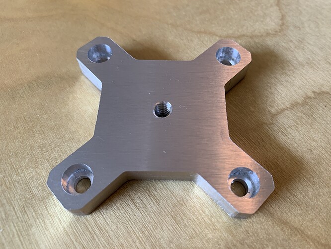

I decided to jump right into aluminum for my first project. The standard display mount was a bit shaky in my opinion, so I machined a new aluminum mount with a 1/4 threaded center to accommodate standard photography mounting hardware. Built this in Adobe Illustrator, created the G Code in Carbide Create, and used an Amana HSS1630 1/8 bit.

**Post date:** [August 22, 2021, 10:26pm UTC](https://forum.onefinitycnc.com/t/my-first-project-new-aluminum-display-mount/6027/12 "2021-08-22T22:26:02Z")
Looks great. Did you tap the 1/4" hole by hand after machining the part?
**Author:** ![Watkins](https://sea2.discourse-cdn.com/flex022/user_avatar/forum.onefinitycnc.com/watkins/32/3188_2.png) [@Watkins](https://forum.onefinitycnc.com/u/Watkins)\
**Post date:** [August 23, 2021, 12:06am UTC](https://forum.onefinitycnc.com/t/my-first-project-new-aluminum-display-mount/6027/13 "2021-08-23T00:06:02Z")
I do not. I haven’t encountered any problems yet, but I keep the ipm and doc modest.
**Post date:** [August 23, 2021, 12:07am UTC](https://forum.onefinitycnc.com/t/my-first-project-new-aluminum-display-mount/6027/14 "2021-08-23T00:07:54Z")
Yep, I Cnc’d the hole and then tapped the threads by hand.
