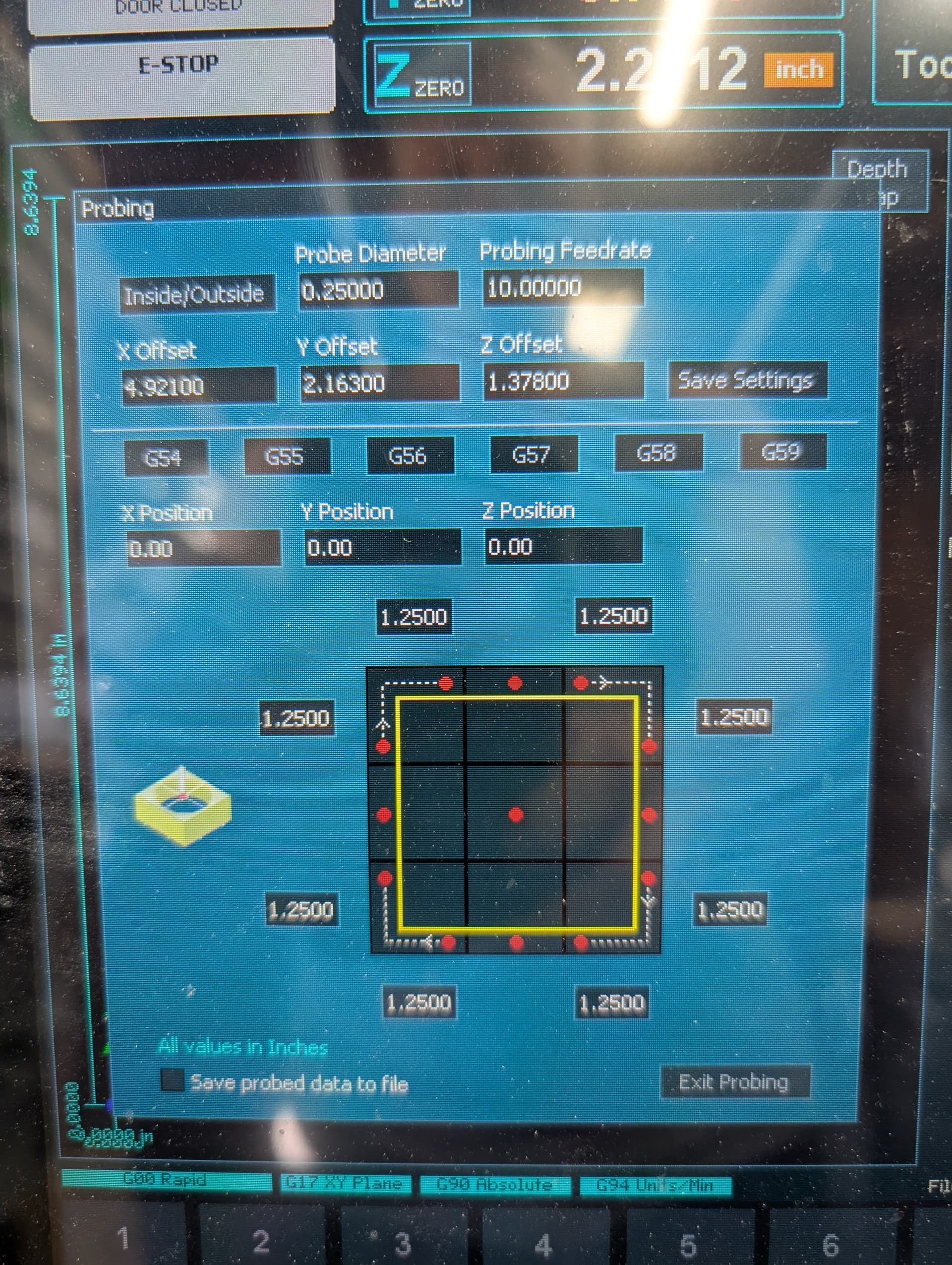

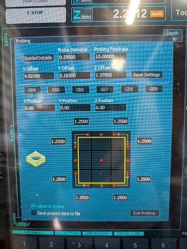

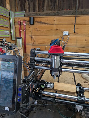

Hi, all. I installed my Revolution today and believe that I have it all set up correctly. I loaded a 3x3" blank into it and want to round it. I’m getting an X soft limit. Wondering if anyone could try to help me one step at a time to keep it simple. My ideal goal would be to round the center of this blank, leaving the ends, especially at the chuck, to avoid the screws.
Here is my CNC setup:

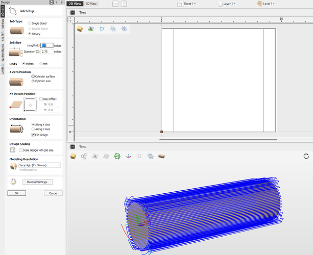

 ![1](https://us1.discourse-cdn.com/flex022/uploads/onefinitycnc/original/3X/4/4/44694825c1db475555e4b3a82f42549f9b43ef82.png)
 ![2](https://us1.discourse-cdn.com/flex022/uploads/onefinitycnc/original/3X/4/4/442276e2f79470d1e598ccf11c71f4f8ae64a4dc.png)

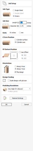

As for the post processor, my first attempt was to update the post processor database and I selected this:
![3](https://us1.discourse-cdn.com/flex022/uploads/onefinitycnc/original/3X/8/8/881bd2f8c4290a5982895f98aefb5611ec70dc6d.png)
And this is my gcode header:

I believe the issue is with your post processor selection. The rotary is oriented along the X axis, BUT… the design you are carving is wrapped around the ‘Y’ axis (onto the A-axis). You need the ‘Y2A’ post processor, not the ‘X2A’. That is probably why you’re getting the alarm.

I changed the PP and I’m getting an X error further into the file.
![image](https://us1.discourse-cdn.com/flex022/uploads/onefinitycnc/original/3X/4/e/4e29a0c94b969a058db73420d82cadbcf4491a18.png)
I found out how to manually move the rotary with G0 A360 and it does work. I read that the Y axis is still active while not running a job.
In preview from the TOP I’d expect this to be horizontal.

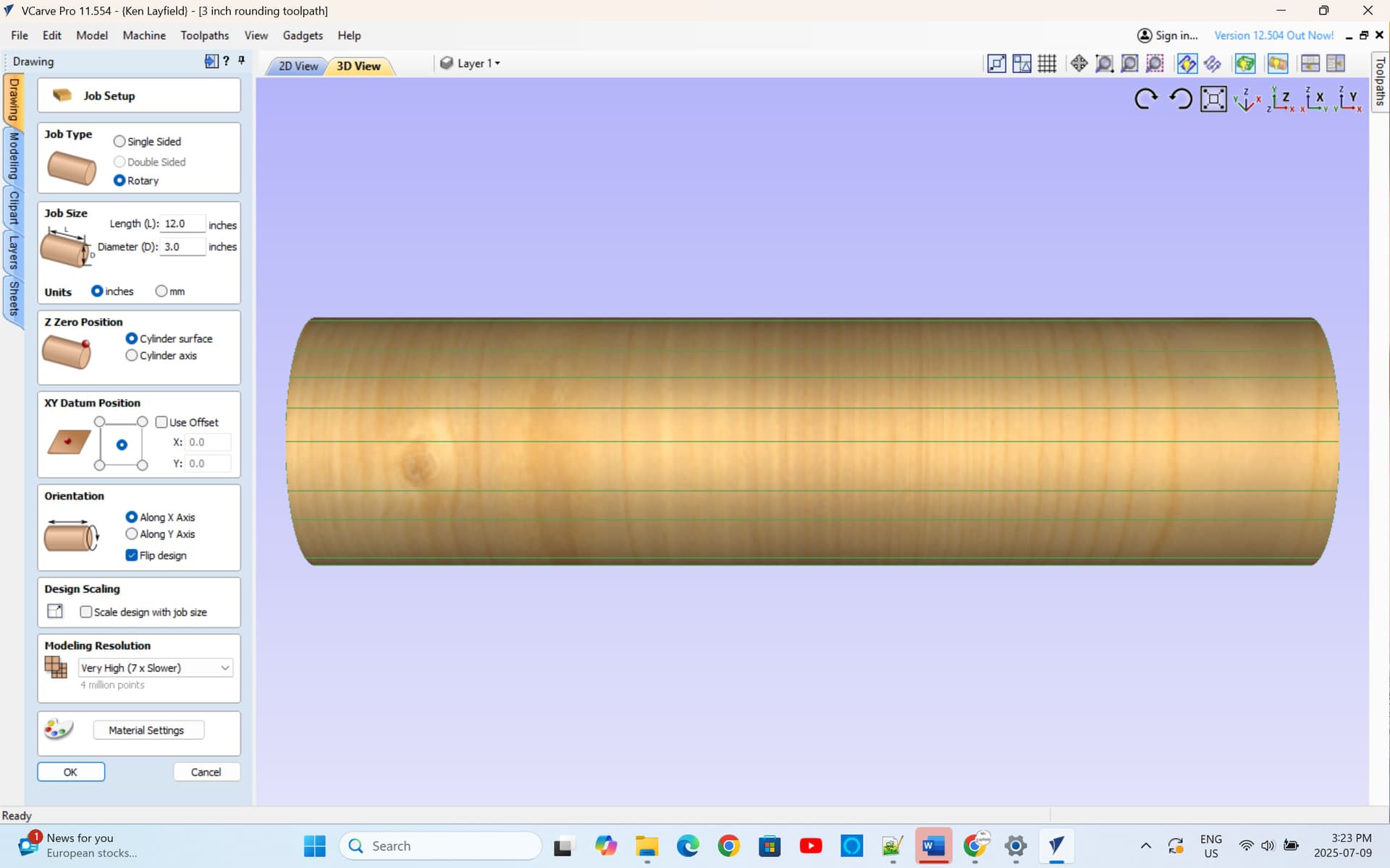

**Post date:** [July 9, 2025, 7:30pm UTC](https://forum.onefinitycnc.com/t/newbie-walk-thru-to-get-my-first-revolution-rounding-job-with-vectric/34299/6 "2025-07-09T19:30:36Z")
![image](https://us1.discourse-cdn.com/flex022/uploads/onefinitycnc/original/3X/c/6/c69ae7b6dc2cef2a732c7eec75cc3a55a146f1a8.jpeg)
So your job setuo in Vcarve should look like this
Job is running in the y direction and on the left hand screen you have selected material surface
When I use my rotary, I manually set the job origin using the control panel jogging feature
Once I have jogged to the centre of the workpiece in X and Y ,I zero out X and Y.
Then I manually set Z zero with a piece of paper and manually jog down Z to the material surface and zero out the Z axis

**Post date:** [July 9, 2025, 7:44pm UTC](https://forum.onefinitycnc.com/t/newbie-walk-thru-to-get-my-first-revolution-rounding-job-with-vectric/34299/8 "2025-07-09T19:44:40Z")
So if you have a square block, setting off to a flat side will result in deep cuts on the corners.
The rounding toolpath in Vcarve allows for that and adjusts the cutting depth. It takes it off in quadrants so don’t be alarmed of its weird movements
To be on the safe side, set up the machine with an endmill installed then take it out before running the program. An “aircut” will allow you time to stop the machine before it does something stupid
