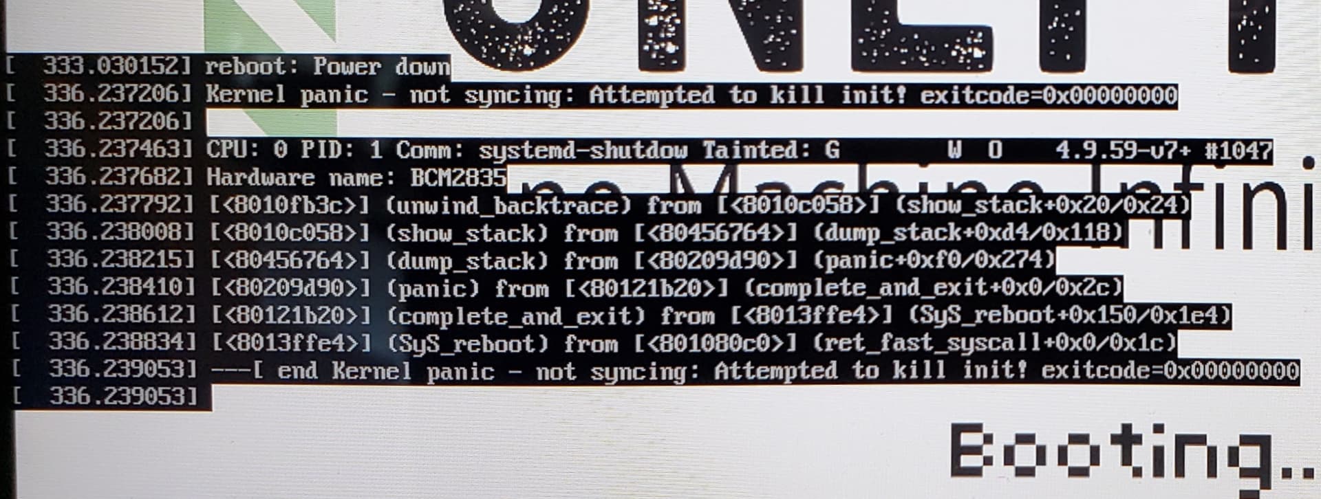

When i click the power off button in the lower left corner of the screen, the device stays on. Ive waited 45 minutes, and no change. The only way I’ve been able to turn it off is unplugging it.

Once the display goes blank you can power off the controller

On the 8" standard issue magedock purchased from onefinity, I go to the flyout menu, click on power symbol at the bottom, then select “Shutdown” to confirm.
The Onefinity logo splashscreen appears with a message “Booting…” with some code.

> [@Proper Shutdown on the Onefinity CNC](https://forum.onefinitycnc.com/t/proper-shutdown-on-the-onefinity-cnc/11658):
> [[Proper Shutdown on the Onefinity CNC] ](https://www.youtube.com/watch?v=009t275sTNE) If the screen does not shut down after powering down and flipping the power switch: There are times when the controller will stay on after flipping the rocker switch to off or, in the case of the led push button switch, it won’t power off the controller. This is a rare phenomenon but does happen from time to time. This is due to the screens independent power back feeding through the usb touch cable plugged into the back of the controller. T…

I just started getting this also. I was having problems thinking it was EMI. When I found out that I couldn’t clear old gcode off of my black box I reflashed the memory card. Seems all of my problems went away but developed this on shutdown. I can reboot but not shut down. I shut it down by using the rocker switch.
**Post date:** [April 29, 2024, 5:51pm UTC](https://forum.onefinitycnc.com/t/onefinity-wont-turn-off/16265/10 "2024-04-29T17:51:36Z")
@allen220 normal for rocker switch bb controllers:
[![](https://us1.discourse-cdn.com/flex022/uploads/onefinitycnc/original/3X/0/f/0fe0d599de257224b14c6d9c6c93203ba78fa1e6.jpeg "Proper Shutdown on the Onefinity CNC") ](https://www.youtube.com/watch?v=009t275sTNE)
