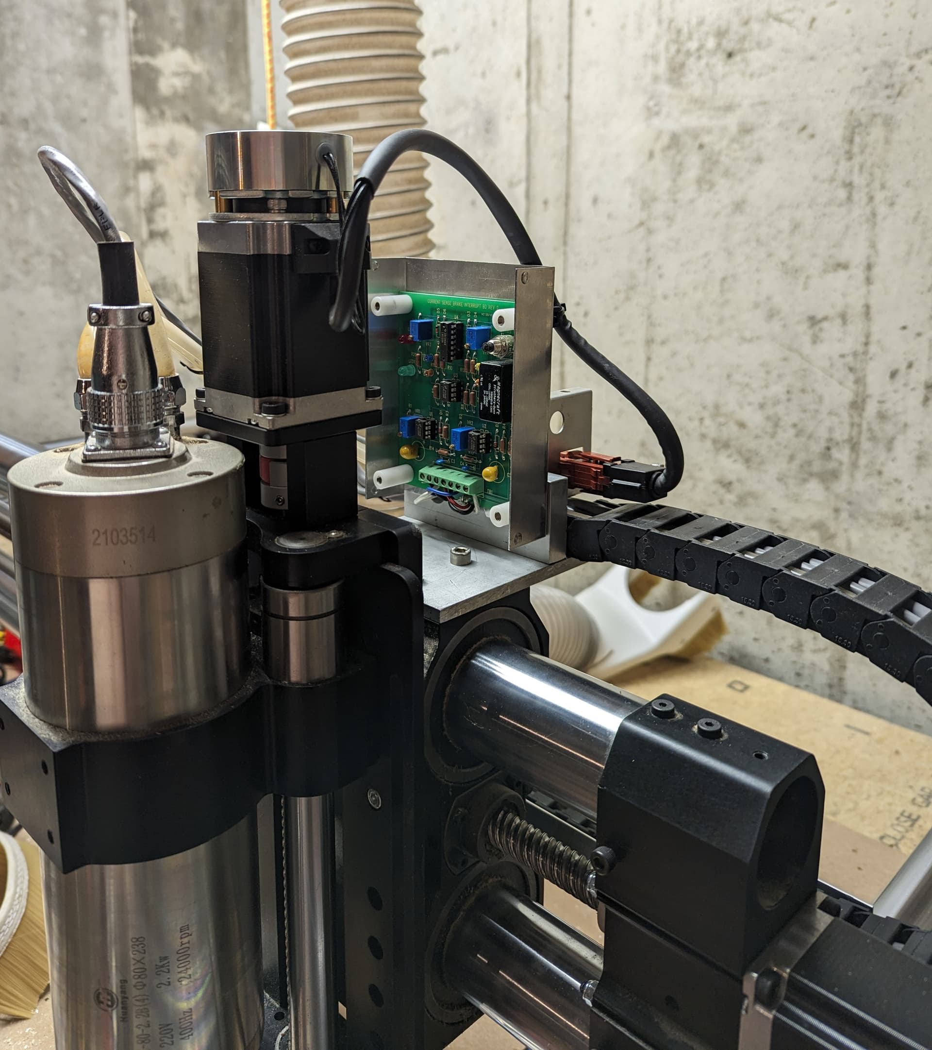

### Author: ![Dr-Al](https://avatars.discourse-cdn.com/v4/letter/d/cc9497/32.png) [@Dr-Al](https://forum.onefinitycnc.com/u/Dr-Al)
#### Post date: [December 30, 2023, 5:31am UTC](https://forum.onefinitycnc.com/t/passive-z-axis-brake-idea-theory-only/24339/6 "2023-12-30T05:31:45Z")
I have a working circuit board that monitors the stepper currents for both an over current and under current condition. I haven been able to truly test it as I’m waiting for my stiffy to show up. I’m also upgrading to drag chains. Just moving it around manually and creating a fault condition it triggers the brake. I designed it for the Buildbotics controller.
 ![brake board](https://us1.discourse-cdn.com/flex022/uploads/onefinitycnc/original/3X/d/1/d1a25e76dc83b83695498b90874f595258a2f797.jpeg)
