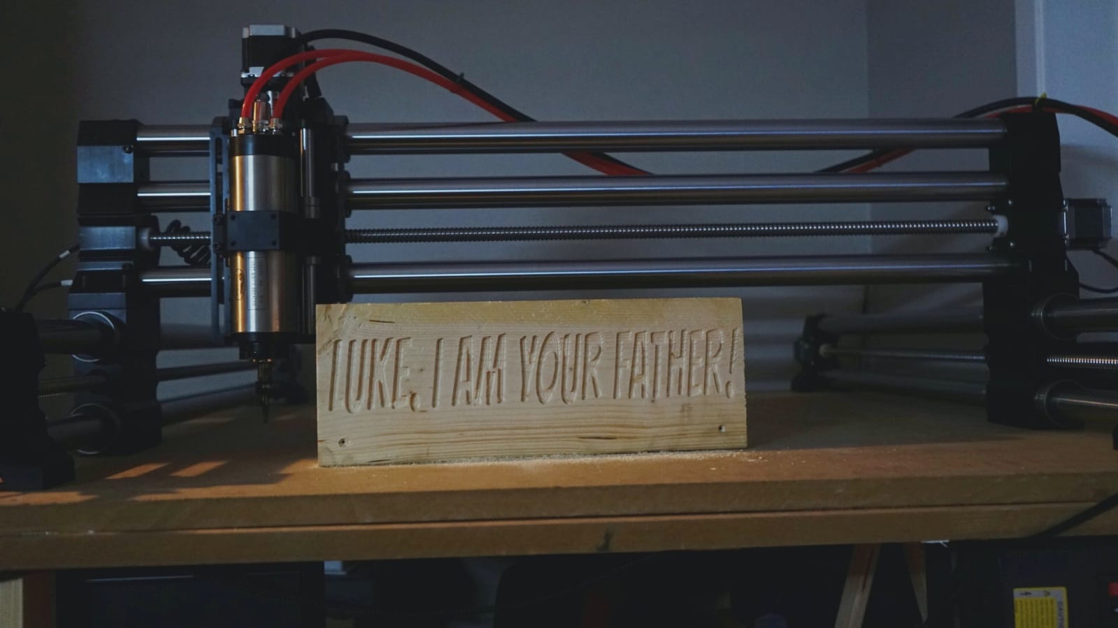

I first used Easel to get a Gcode as fast as possible. This is the result ;

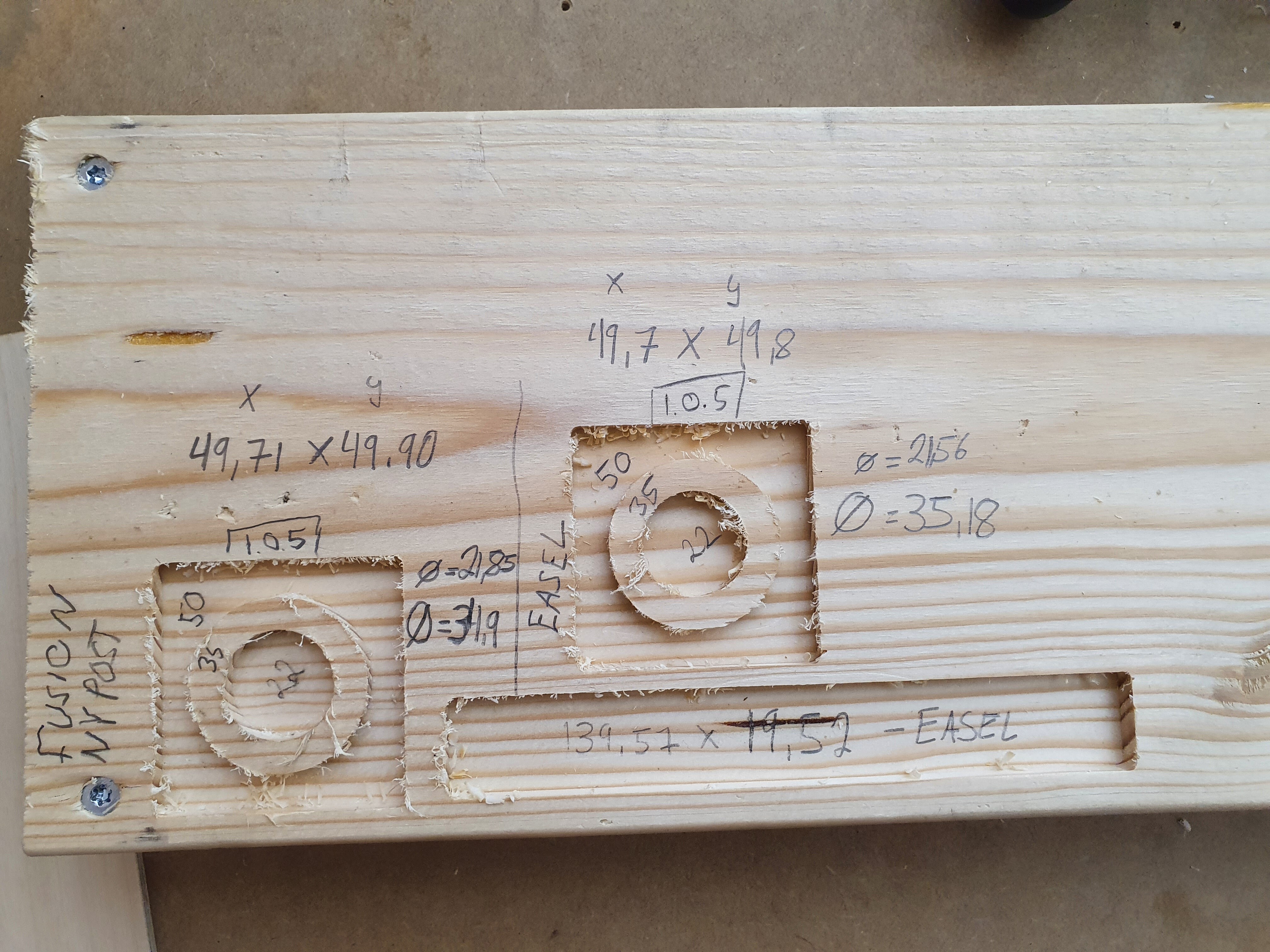

1. My holes are not the correct size.
I tried to fit a 22mm bearing into a pocket, but the pocket is too small. I’m guessing that has to do with fine-tuning of the machine? I have yet to follow this post made by@cyberreefguru
([Profile - cyberreefguru - Onefinity CNC Forum](https://forum.onefinitycnc.com/u/cyberreefguru))
[Testing and tuning OF for accuracy](https://forum.onefinitycnc.com/t/testing-and-tuning-of-for-accuracy/1846)
- noen of the F360 or Easel files made the hole bigg enough(sligthly under)

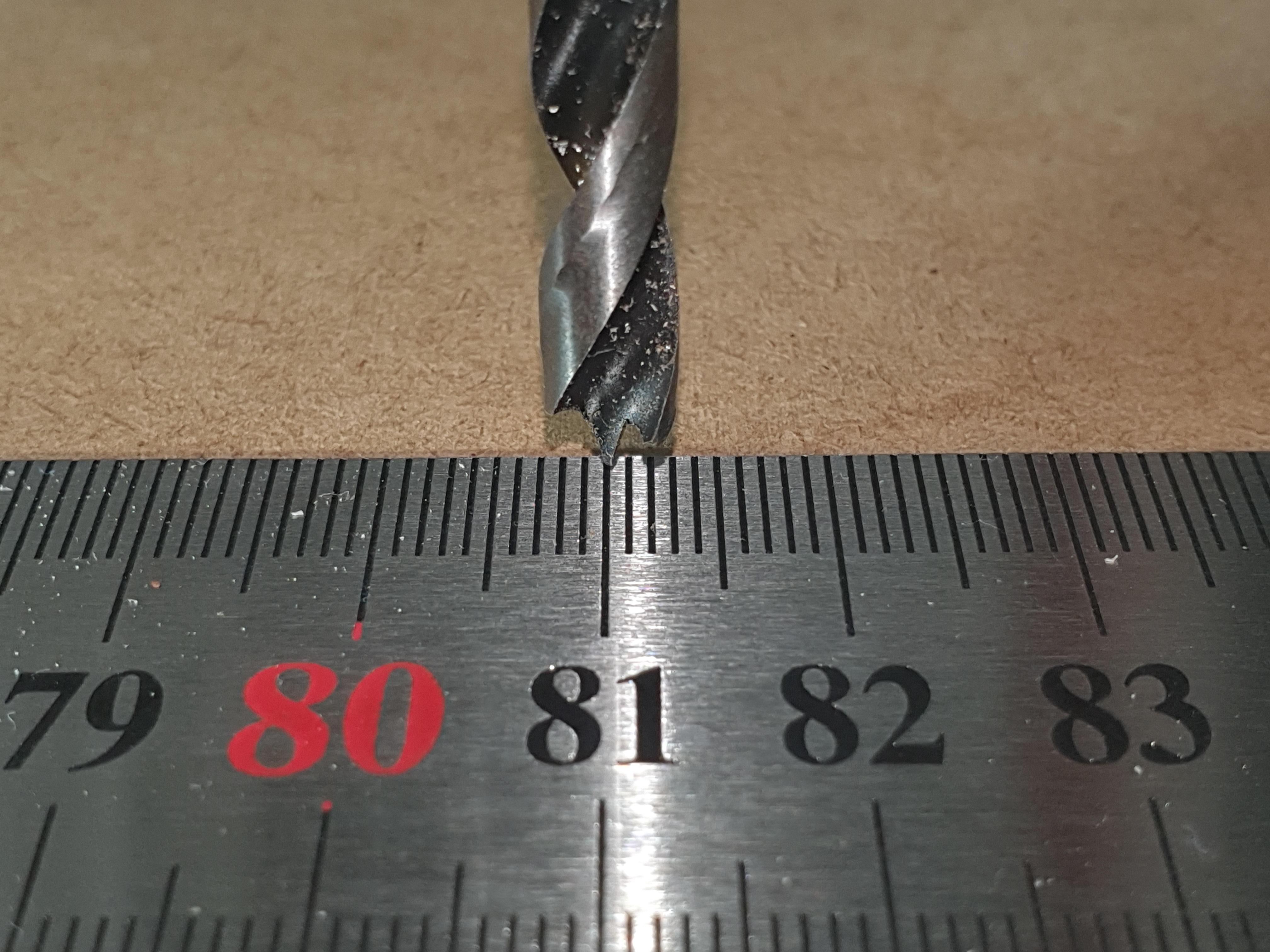

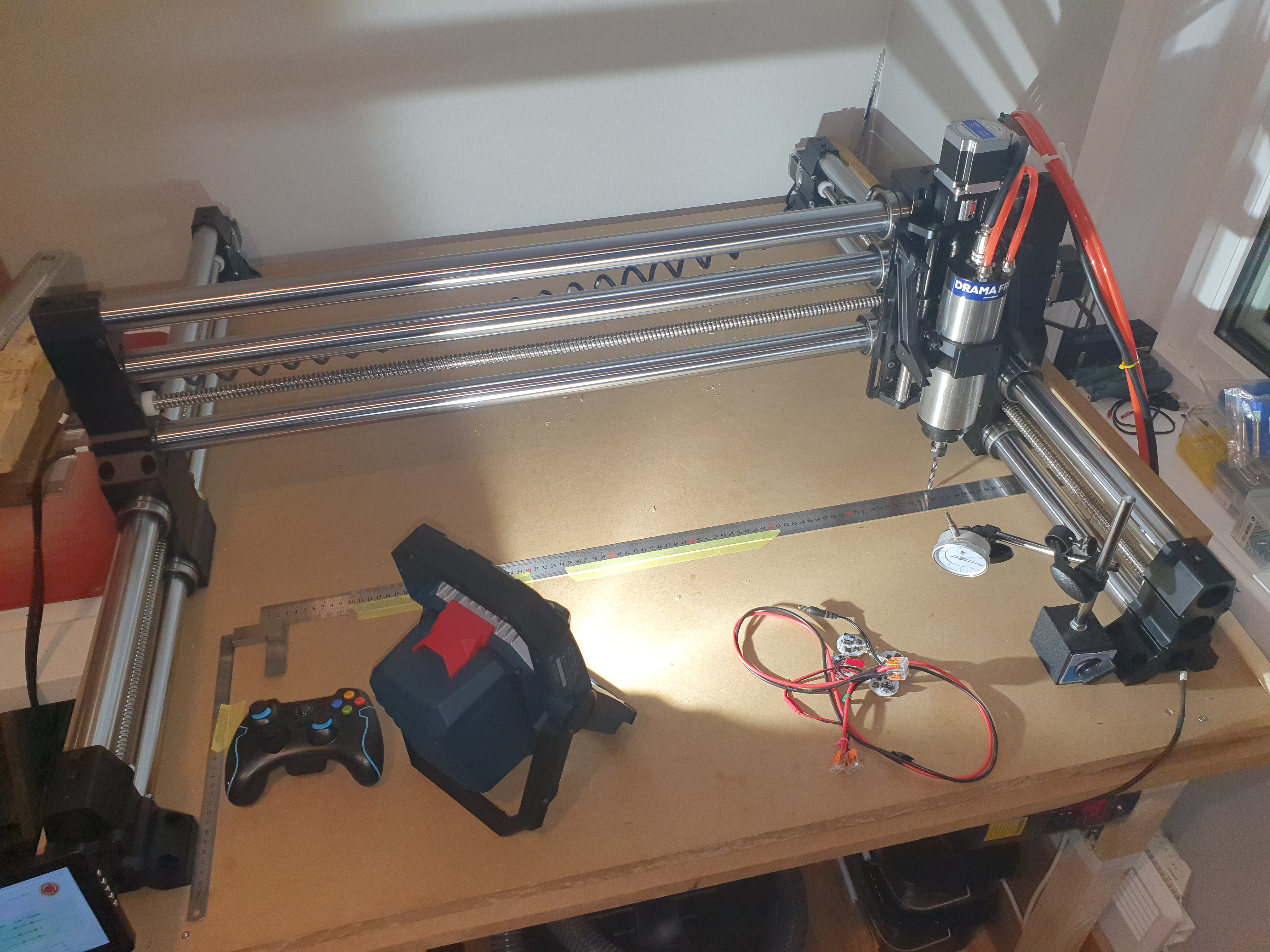

Time for an update;
After spending quite(!!!) some time trying to tune-in the cnc, I’m not sure where to go.
What we have found out so far ;
- When traveling 800mm its off by less ~0.1mm (Neglectable and to small to measure very accurate on the ruler?)
- When making a small square(45mmx45mm), it makes the same amount of error, apx. 0.5mm…
  - Measured in at (
- When making a larger rectangle(20mmx140mm), it makes the same amount of error.
  - Measured in at (
- it does not seem to add up the offset for each cm traveled. (For instance, 1mm error for each 10mm traveled → 100mm traveled = 110mm measured)
Here is a video and some photos. Maybe you see something that would be of importance?
[![](https://us1.discourse-cdn.com/flex022/uploads/onefinitycnc/original/3X/3/2/321eaa3ef246a72e640a8ed9351e80b62f45ce2d.jpeg "OneFinity CNC accuracy issues") ](https://www.youtube.com/watch?v=hT0Cg04yW0Y)
 ![20210122_192328](https://us1.discourse-cdn.com/flex022/uploads/onefinitycnc/original/3X/3/5/355df9f954fd3aa7719976935f1c701b89374055.jpeg) ![20210122_192354](https://us1.discourse-cdn.com/flex022/uploads/onefinitycnc/original/3X/7/d/7d655aa9302454f377dca0a527b9b789448ad4b5.jpeg)

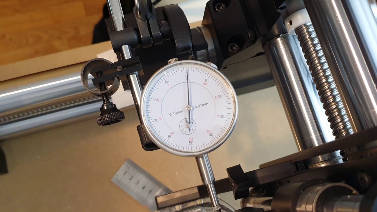

Here you can see the minor offset it makes after traveling 80 cm. (started at 1cm)

Picture of some of the tests. on the left is a F360 with the new post-processor. You can see the designed paramertes in the square. The rectangle is design to be 140mm \* 20mm.
**Author:** ![BNB187](https://avatars.discourse-cdn.com/v4/letter/b/f19dbf/32.png) [@BNB187](https://forum.onefinitycnc.com/u/BNB187)\
**Post date:** [January 22, 2021, 9:22pm UTC](https://forum.onefinitycnc.com/t/post-processor-bugs-fusion360/2731/11 "2021-01-22T21:22:21Z")
The video might be pointing to the problem. That seems like a lot of movement on the dial indicator when you flex the table top. I had some issues with mine initially from not enough rigidity of the table top. The machine could be ‘torquing/winding’ the table on direction change?
In my case it was laziness and I had not put enough screws in securing to bottom MDF. My top is 8020 aluminum frame, braced with I beam to prevent sag, partially torsion boxed, 3/4 MDF on top of that, another layer of 3/4 MDF that is a bit bigger than the footprint of the machine. And a 3/4 spoilboard on top of that.
Once I banged more screws in and got rid of the flex in the top I was good to go. Also, put lags in the feet that went through 2 layers of MDF instead of just 1.

The take flex seems sketchy at best. Have you checked to ensure all the guides/bearings are tight? If you push on the axis is there any slop (likely had to feel at that small of a shift)

Agree on the flexing tabletop!
- Have to sort that out in the future some time…
But with such low feeds the dial indicator should have gone back to zero although the table can flex a bit, or am I wrong?
I had the majority of my body weight on the table when that flex occurred!
