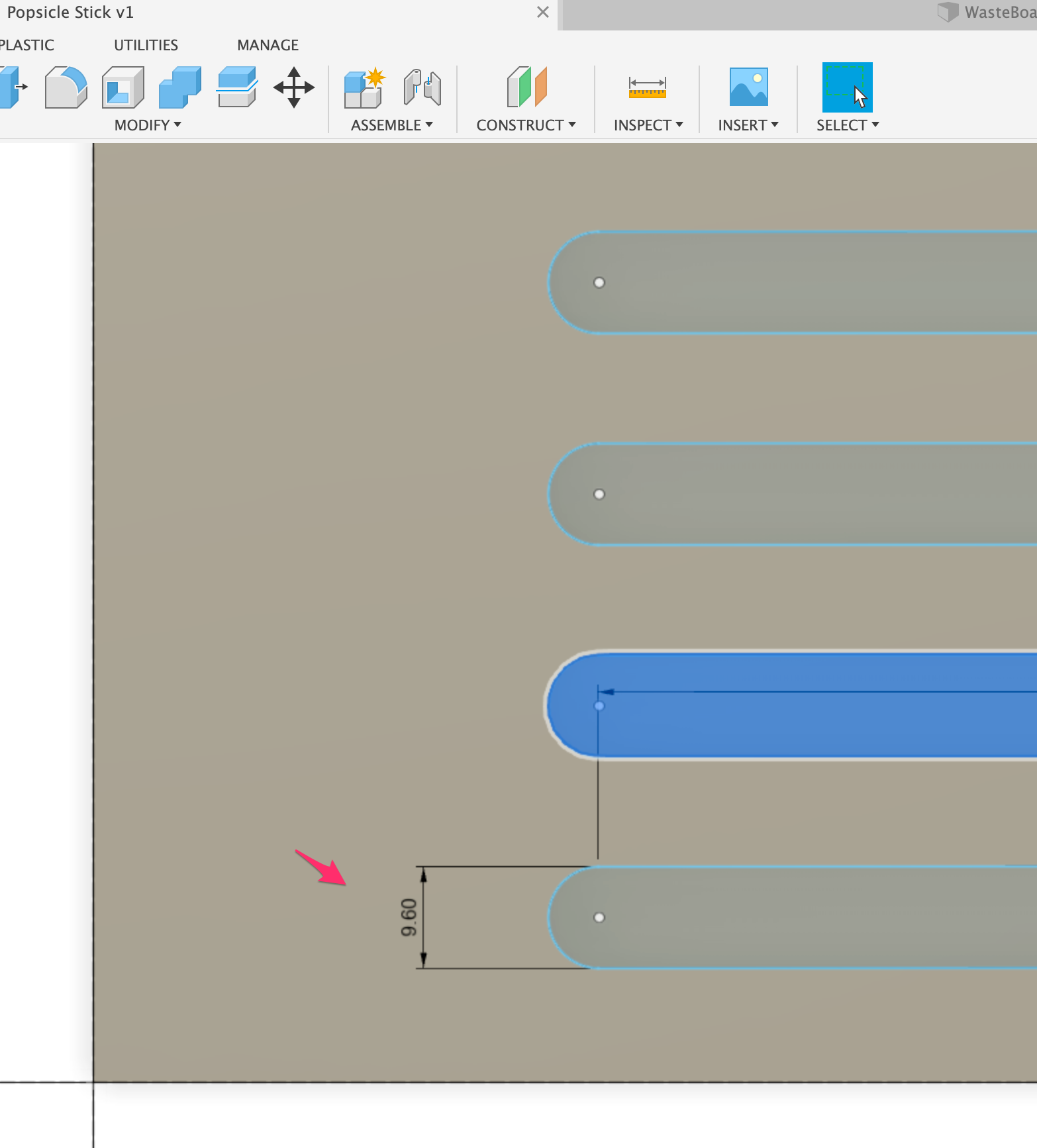

I’m trying to make a JIG so that i can laser popsicle sticks.
I’m using fusion 360.

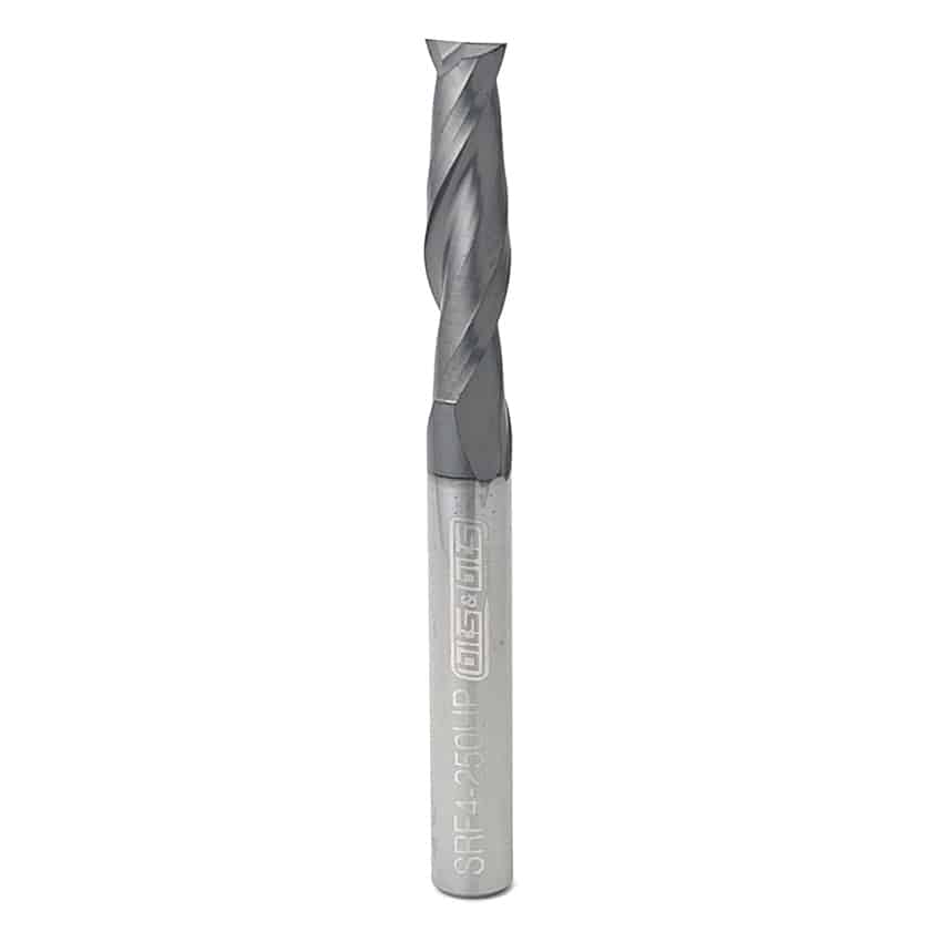

I’m using this bit: (v1.3 of the BitsBits Fusion Tool Library)
> **[\*Astra Coated\* Bits&Bits SRF4-250UP - 1/4" Up-Cut Spiral Bit - BitsBits.com](https://bitsbits.com/product/srf4-250up-cut/)**
> Astra Coated 1/4" Up-Cut Spiral Bit with 1" length of cut. Versatile up-cut spiral bit can be used in any router, CNC, or router table.
This is the latest machine i’m using for Fusion360 / OneFinity
> **[Post Library for Autodesk Fusion 360 | Autodesk Fusion 360](https://cam.autodesk.com/hsmposts?p=onefinity)**
> Autodesk Fusion CAM Solutions
i’m cutting 3/4 MDF.
Here is my file:
[Popsicle Stick v1.f3d](https://forum.onefinitycnc.com/uploads/short-url/3MvfrItE5FtjSzu85bOJYjWLF7I.f3d) (183.0 KB)
The Design calls for a width of 9.6mm
 ![Autodesk_Fusion_360](https://us1.discourse-cdn.com/flex022/uploads/onefinitycnc/original/3X/1/0/10083cf722baac956369cbd0b43f61cb3c9612ec.png)

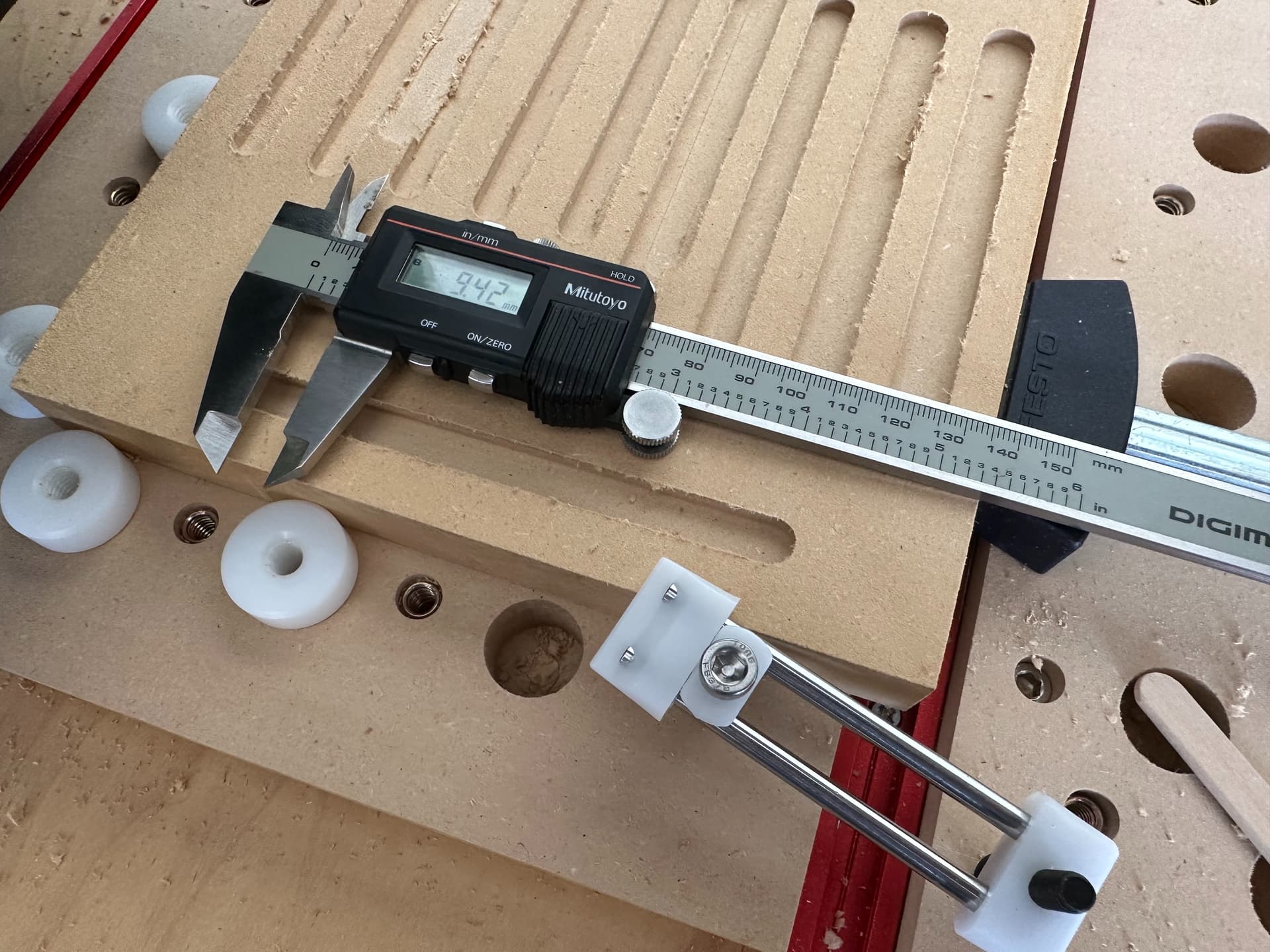

After the CNC cuts it, the width 9.38-9.42mm instead of 9.6mm.
Why is this ~ .2mm off? What setting or tunning in the device should I look at?

I would measure the bit to make sure it is 1/4 inch also make sur it is far enough into the collet. May be deflection.
**Author:** ![markalanevans](https://sea2.discourse-cdn.com/flex022/user_avatar/forum.onefinitycnc.com/markalanevans/32/8212_2.png) [@markalanevans](https://forum.onefinitycnc.com/u/markalanevans)\
**Post date:** [April 17, 2023, 4:39pm UTC](https://forum.onefinitycnc.com/t/precision-off-by-2mm-when-creating-popsicle-stick-jigg/20069/3 "2023-04-17T16:39:30Z")
I just checked and the bit is measureing .24 inches so it’s pretty close and it is installed all the way in.
Any other ideas?
**Author:** ![WaywardWoodworker](https://avatars.discourse-cdn.com/v4/letter/w/e79b87/32.png) [@WaywardWoodworker](https://forum.onefinitycnc.com/u/WaywardWoodworker)\
**Post date:** [April 17, 2023, 4:45pm UTC](https://forum.onefinitycnc.com/t/precision-off-by-2mm-when-creating-popsicle-stick-jigg/20069/4 "2023-04-17T16:45:41Z")
If your error is 0.2mm that is about 0.008" and your bit is 0.240" and not 0.250" that is 0.010" of deviation which is greater than your reported 0.2mm error. The bit is the most likely source of the error. In Fusion you can use the “stock to leave” value with a negative number to correct for the undersized pocket. I use this method to fine tune neck pockets.
**Post date:** [April 17, 2023, 4:53pm UTC](https://forum.onefinitycnc.com/t/precision-off-by-2mm-when-creating-popsicle-stick-jigg/20069/5 "2023-04-17T16:53:42Z")
Well the bit is .2465".
**Post date:** [April 17, 2023, 4:54pm UTC](https://forum.onefinitycnc.com/t/precision-off-by-2mm-when-creating-popsicle-stick-jigg/20069/6 "2023-04-17T16:54:34Z")
Let me do the math there and see about using some negative stock to leave. Thank you!
**Post date:** [April 17, 2023, 5:51pm UTC](https://forum.onefinitycnc.com/t/precision-off-by-2mm-when-creating-popsicle-stick-jigg/20069/7 "2023-04-17T17:51:03Z")
That was it. I just did the diff of the spec vs actual and then i also added in a finishing pass to smooth it.
