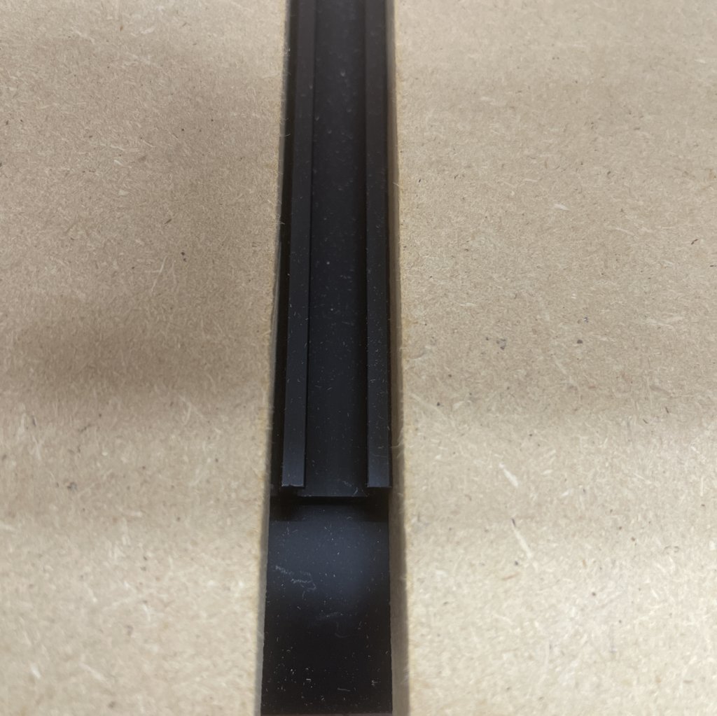

**Author:** ![rmorris1010](https://avatars.discourse-cdn.com/v4/letter/r/b77776/32.png) [@rmorris1010](https://forum.onefinitycnc.com/u/rmorris1010)\
**Post date:** [October 18, 2021, 2:39am UTC](https://forum.onefinitycnc.com/t/qcw-t-track-size/8026/8 "2021-10-18T02:39:04Z")
![T-track](https://us1.discourse-cdn.com/flex022/uploads/onefinitycnc/original/2X/b/b3ed11ccd7c975de26af2d894c8a2aa48e299984.jpeg)
The width of the T-track from the outside edge of one side to the outside edge of the other side is 5/8".

**Author:** ![toothcutter](https://avatars.discourse-cdn.com/v4/letter/t/e274bd/32.png) [@toothcutter](https://forum.onefinitycnc.com/u/toothcutter)\
**Post date:** [December 9, 2021, 8:39pm UTC](https://forum.onefinitycnc.com/t/qcw-t-track-size/8026/12 "2021-12-09T20:39:31Z")
I have a WoodRiver Jig Hardware Kit 149 pieces (from WoodCraft) . I also happen to have a WW QCW, attach from above. The entire kit is comprised only of 1/4" X 20 TPI hardware. There are four different lengths of T-Bolts in the kit; but the length is immaterial to our discussion. _All the T-Bolts fit the T-Track slot of the WW QCW._
I do have Rocklers hold down clamps…somewhere…we have recently moved, so I do not know which box they are in. Rocklers website states the clamp has a 5/16" T-bolt. If the clamps show themselves in a timely fashion, then I’ll let you know if they fit.
**Author:** ![Bob\_D](https://sea2.discourse-cdn.com/flex022/user_avatar/forum.onefinitycnc.com/bob_d/32/4732_2.png) [@Bob\_D](https://forum.onefinitycnc.com/u/Bob_D)\
**Post date:** [December 10, 2021, 12:26am UTC](https://forum.onefinitycnc.com/t/qcw-t-track-size/8026/13 "2021-12-10T00:26:25Z")
A big difference between a 1/4-20 and 5/16-18 screws and also 5/16" T-bolt heads are larger. If this all started with trying to use 5/16 hardware in a t-track made for 1/4-20 then I understand why they did not fit.
There is at least one brand of t-track that will accept both sizes but I don’t remember which, I’d have to research it.
**Post date:** [December 11, 2021, 7:10am UTC](https://forum.onefinitycnc.com/t/qcw-t-track-size/8026/14 "2021-12-11T07:10:02Z")
Found my Rockler hold down clamps. The 5/16" T-bolt flange is too wide for the QCW T-track.
**HOWEVER** , the threaded bolt does fit into the groove. The flange is just slightly too wide. The flange is 13.17mm at its widest point, and the width of the lower groove in the T-track is 12.00mm. Therefore, take about 0.7mm (give or take) off of each side and fine adjust a needed.
Two other alternatives:
1. substitute a 1/4" T-bolt (and washer, knob) into the Rockler clamp
2. modify a few 5/16" T-bolts to use if/as needed in the QCW T-tracks
