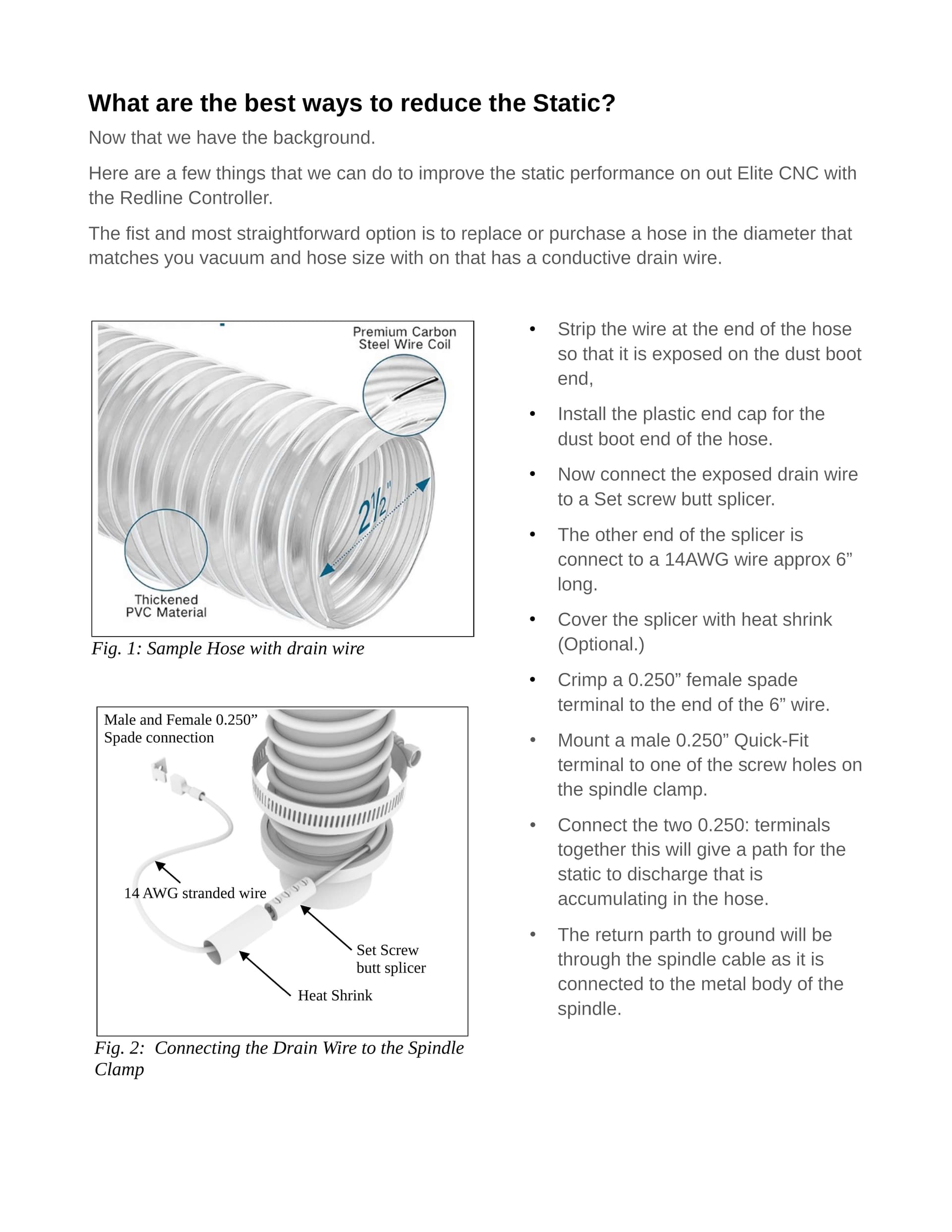

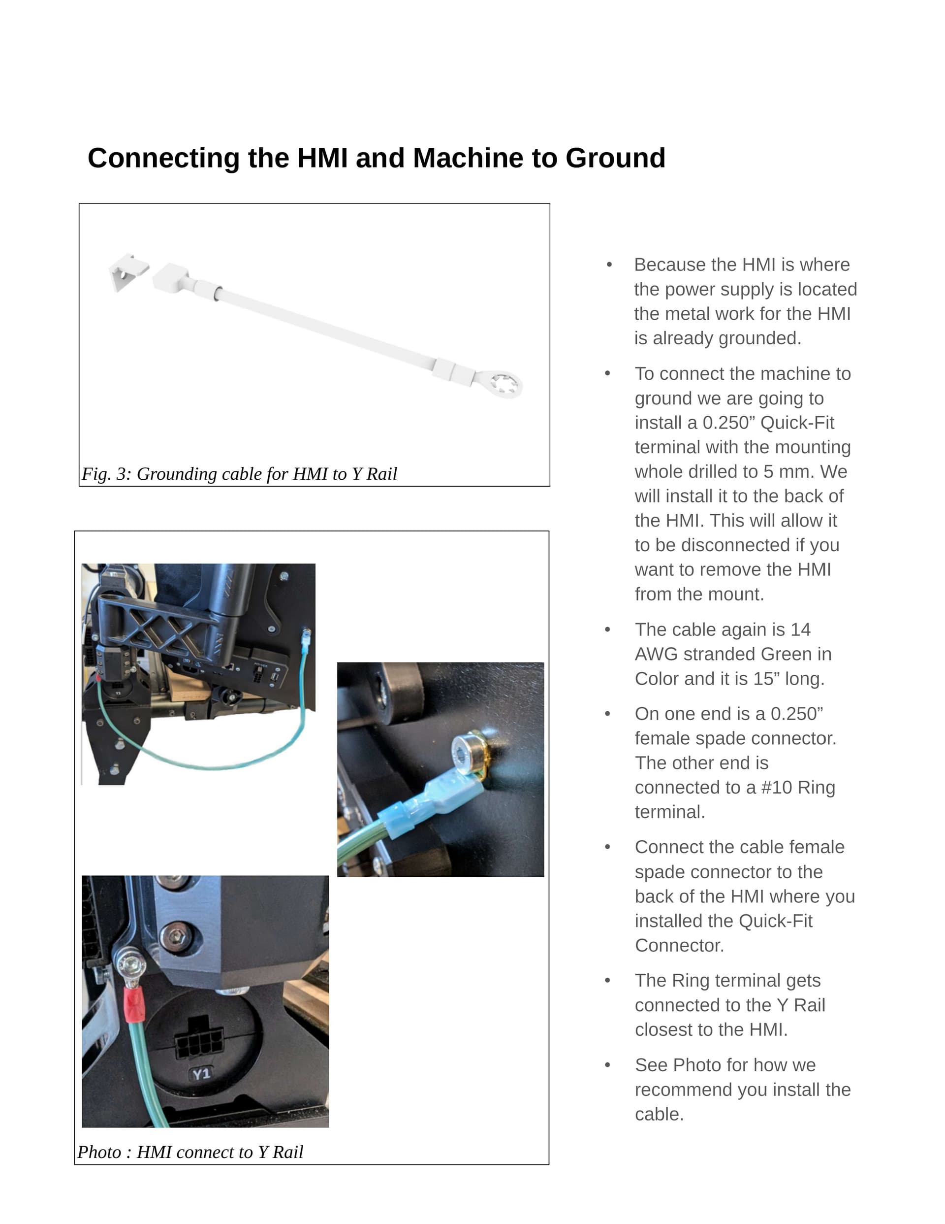

- Has there been any other reports of the controller going black for a few seconds during a carve, then back on? I planed my spoil board and it did this a few times. When it said “Program Complete",” I was unable to click the OK button, and had to restart the whole controller.
We have seen this happen in cases of extreme static discharge. I will let the Redline team comment further. Are you using a vacuum or dust collection system?

I have a dust collection system nearby, and attached via the SuckIt dust shoe. Is there a specific way I should be grounding it to avoid this issue?
Absolutely. Let me check with Redline and OneFinity to see if they have specific recommendations. Otherwise, I can provide some guidance. Back to you shortly.
yes, I had this problem i have a shop vac
**Post date:** [November 11, 2025, 6:22pm UTC](https://forum.onefinitycnc.com/t/redline-controller-observations-questions-bugs/35942/8 "2025-11-11T18:22:04Z")
> [@RTCNC](#):
Any update? With these machines now in the wild and getting setup it is a problem that is looking for a solution (mine is to disconnect the ShopVac from the Suckit dust boot when using MDF as that’s when my Redline controller dies).
**Post date:** [November 11, 2025, 6:27pm UTC](https://forum.onefinitycnc.com/t/redline-controller-observations-questions-bugs/35942/9 "2025-11-11T18:27:40Z")
It’s in the FAQ section.
> [@Redline Controller Grounding FAQ](https://forum.onefinitycnc.com/t/redline-controller-grounding-faq/36045):
> [Redline Grounding instructions v3.pdf](https://forum.onefinitycnc.com/uploads/short-url/5JRD7UIB1zS0Lbx5dCC2VC7rXVQ.pdf) (2.8 MB)
**Post date:** [November 11, 2025, 6:30pm UTC](https://forum.onefinitycnc.com/t/redline-controller-observations-questions-bugs/35942/10 "2025-11-11T18:30:07Z")
Thank you. I hadn’t seen an update in this topic so wasn’t aware you answered it elsewhere.

@JimHatch We are also building out our documentation. Here is an article on static and grounding from the RTCNC manual:
> **[Static & Grounding - RealTime CNC Documenation Hub](https://docs.realtimecnc.com/grounding/)**
**Post date:** [November 22, 2025, 10:41pm UTC](https://forum.onefinitycnc.com/t/redline-controller-observations-questions-bugs/35942/12 "2025-11-22T22:41:54Z")
Thanks. OF did a pretty good write-up on how to set it up with antistatic provisions and where/what to bond with the machine to stop static issues. I got an antistatic hose from Rockler but haven’t done any further MDF surfacing so I’m not sure if my static issues have been solved. But surfacing a 4x4 MDF board is a pretty high intensity sawdust (no chips) scenario so I may not see an issue until I resurface again.
