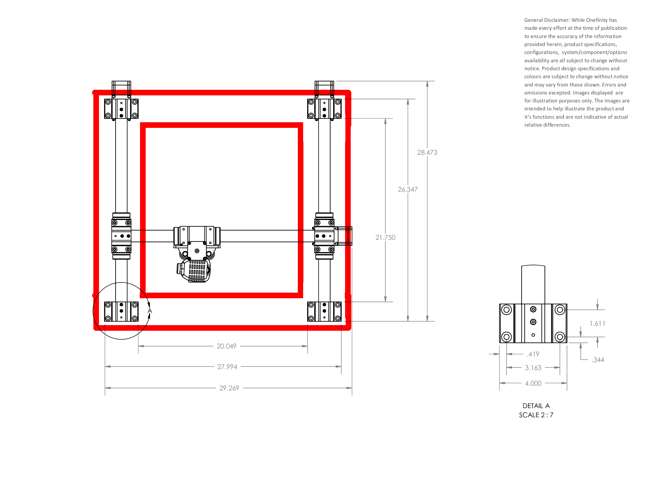

Is anyone aware of alternative mounting designs which allows you to place the CNC on top of the workpiece? I have heard references to this (things like “Place it on your dining room table and make an inlay in the center of it”), but I have not seen how you would do that. I would assume that you need rock solid connections between the two Y rails, and to ensure that they are kept square. Would that keep things solid enough?
What I am talking about is something like this:
 ![d78c7da7027caaf2f5c9fd0a169eb20e0483ada6](https://us1.discourse-cdn.com/flex022/uploads/onefinitycnc/original/2X/c/c193ae7e80ea963b9b844e49924e60bc53d20b66.jpeg)
The red boxes would be 1/4" steel plates or something.
 ![d78c7da7027caaf2f5c9fd0a169eb20e0483ada6_2](https://us1.discourse-cdn.com/flex022/uploads/onefinitycnc/original/3X/5/1/5162ddcb5b79a6fd2d5975f991021bdd7a448e93.jpeg)
Something like this could ensure squareness, too…
If I could figure something like that out, it would really be the best of both worlds. That way I could use the machine on my existing workbench most of the time, but if I needed to use it on something larger I could place it on top. Regardless of if it is for a smaller design in the middle of a large panel (the dining room table example), or if I move it multiple times to panelize a design (obviously I would need some sort of indexing to keep alignment), it would really keep my options open.
Has anyone done something like this before?
**Author:** ![gpkon66](https://avatars.discourse-cdn.com/v4/letter/g/50afbb/32.png) [@gpkon66](https://forum.onefinitycnc.com/u/gpkon66)\
**Post date:** [March 29, 2021, 12:48pm UTC](https://forum.onefinitycnc.com/t/required-table-size/4641/8 "2021-03-29T12:48:04Z")
Check out this thread, he did some interesting mounting with steel plates and aluminum extrusions. No reason why you couldn’t do the same with your spoiler board mounted to the extrusions, and the Machinist mounted to it. The overall weight would be the real concern.
> [@Size for Machinist table](https://forum.onefinitycnc.com/t/size-for-machinist-table/888/7):
> Got the base done today. This design is a redesigned version of the one I used with my x-carve. The steel top is 7 ga. (.179") with 1/4-20 tapped holes on a 2" grid. The frame is 20 x 40 aluminum extrusion, and the whole thing is sitting on 16 rubber isolators.
Interested in seeing what you come up with. Gary
**Author:** ![Machinist](https://sea2.discourse-cdn.com/flex022/user_avatar/forum.onefinitycnc.com/machinist/32/36465_2.png) [@Machinist](https://forum.onefinitycnc.com/u/Machinist)\
**Post date:** [March 29, 2021, 5:07pm UTC](https://forum.onefinitycnc.com/t/required-table-size/4641/9 "2021-03-29T17:07:35Z")
I originally started with a flat one-level table, but farther down in that thread (42), I redesigned the base to have the center part raised up so I wouldn’t have to lower my Z axis. Been extremely happy with this setup!
**Author:** ![TBO](https://avatars.discourse-cdn.com/v4/letter/t/7feea3/32.png) [@TBO](https://forum.onefinitycnc.com/u/TBO)\
**Post date:** [March 29, 2021, 6:28pm UTC](https://forum.onefinitycnc.com/t/required-table-size/4641/10 "2021-03-29T18:28:01Z")
Thanks Bill.
So if I am understanding correctly, the router will not go low enough (without hardware modifications) to cut lower than the level of the feet?
I was hoping that I could physically move the machine to sit on top of larger stock for those times that I needed to work on a larger piece. It sounds like that won’t be possible, though.
**Post date:** [March 29, 2021, 6:31pm UTC](https://forum.onefinitycnc.com/t/required-table-size/4641/11 "2021-03-29T18:31:22Z")
The router would, in fact, go low enough. The thing I didn’t like would have been always working at the very bottom of the z travel.
