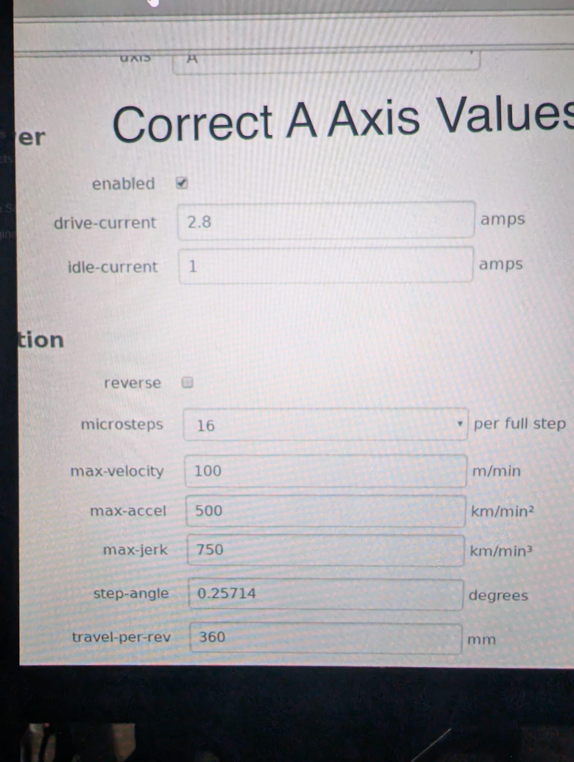

I was hopeful this update would fix some rotary issues, but it appears to have only added some for me. I noticed the settings were different than what a previous post said the settings should be, can anyone confirm what they are supposed to look like on this update? I’ve included my current settings (from a fresh SD card install) and the screen shot provided my onefinity about a month ago.
 ![PXL_20250621_161944018](https://us1.discourse-cdn.com/flex022/uploads/onefinitycnc/original/3X/b/4/b4250678895eae748852bb35af19ea60518f9d2f.jpeg)
 ![PXL_20250519_220034261](https://us1.discourse-cdn.com/flex022/uploads/onefinitycnc/original/3X/3/f/3fbfd4dc7e6e966043b0f5cbac120364943fde3e.jpeg)
**Author:** ![Seamartin00](https://avatars.discourse-cdn.com/v4/letter/s/ed655f/32.png) [@Seamartin00](https://forum.onefinitycnc.com/u/Seamartin00)\
**Post date:** [June 21, 2025, 11:24pm UTC](https://forum.onefinitycnc.com/t/rotary-settings-different-and-not-working-after-update/34068/2 "2025-06-21T23:24:48Z")
At the current speeds it spins waaaay too fast and the cuts don’t happen in the correct locations either
