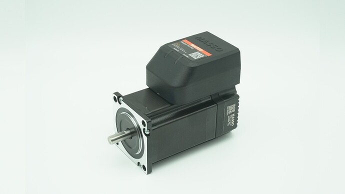

Masso came out with closed loop steppers recently - 2 and 3 Nm versions…
[https://docs.masso.com.au/wiring-and-setup/setup-and-calibration/axis-servo-stepper-examples/masso-stepper](https://docs.masso.com.au/wiring-and-setup/setup-and-calibration/axis-servo-stepper-examples/masso-stepper)
> **[MASSO Closed Loop Stepper Motor](https://www.masso.com.au/product/masso-closed-loop-stepper-motor/)**
> MASSO Closed Loop Stepper Motor for MASSO CNC controller. MASSO Closed Loop Stepper Motors with integerated encoder feedback and control electronics.
… for your interest. I also had looked at ClearPath - would make a very clean instal - plug and play - but you pay for that I suppose. Good tuning software as well from what I have seen/read online.
