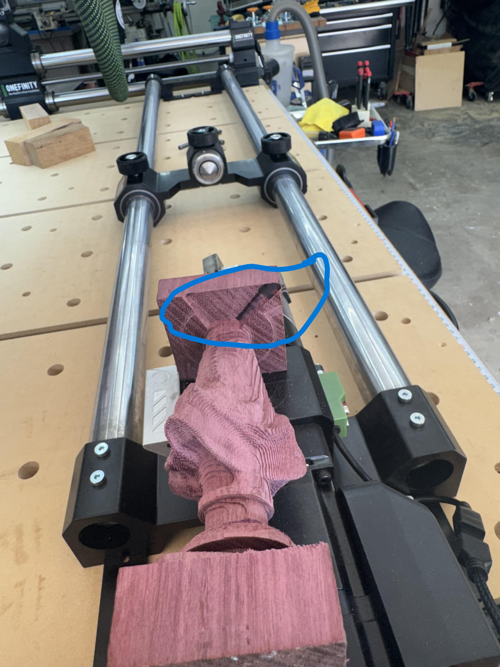

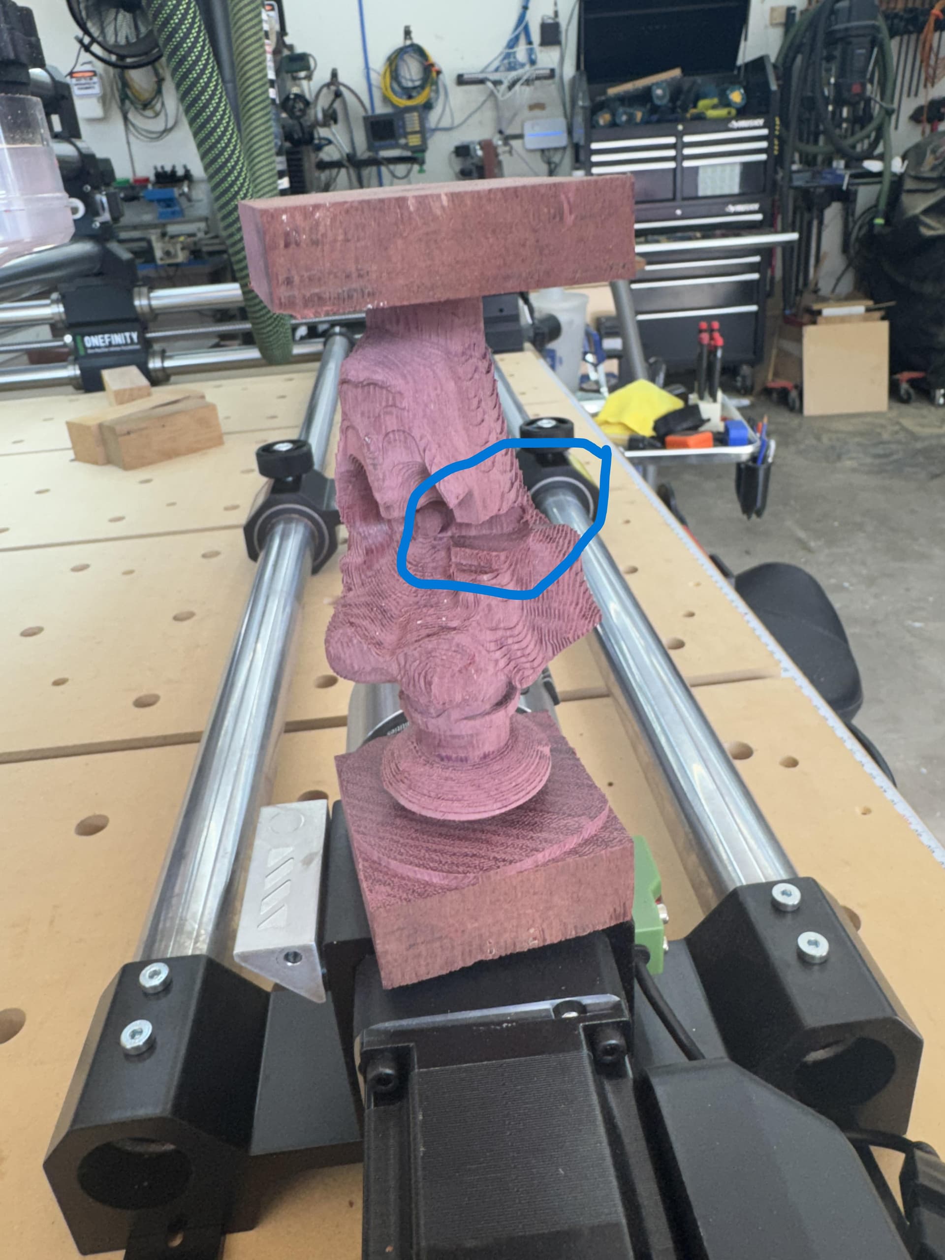

I initially tried to use Fusion 360 to set up a model with a bottom jutting cylinder and top cone for clearance, setting up model to use the space from 25 mm from chuck end of the stock to 11 mm to tail stock, or 117mm of usable stock for a 153mm long 2 ¼” square.
Now, fusion 360 has support for a fourth axis, but only if you pay ($$), as it will cost like 10 tokens/day at a cost of $30 for the 10 tokens, bit negative. Also, I had to pull an older postprocessor from blagistein?? that had 4th axis support to get it to work. I was able to use the 14-day trial to get a test, and glad I did, as I did have luck on a smaller test model of rounding the square, roughing it down with a ¼” bit, then using a 1/32” ball nose taper for finishing. It had some errors where the non-cut movements actually intersected prior done sections, but minorly. I then tried the scaled-up version for and that’s where things went wrong, as during the model roughing, it chewed through the model in several places during just movements, and also exceeded the tailstock boundary into the small section with a violent move into the remaining stock, violent enough that the A axis alarmed out, and the carve quit.
 ![IMG_0732](https://us1.discourse-cdn.com/flex022/uploads/onefinitycnc/original/3X/5/b/5b1ea2559c4f17612ff42d98b740bd4ac3f0e542.jpeg)
pics of mentioned scars from F360 output.
 ![IMG_0733](https://us1.discourse-cdn.com/flex022/uploads/onefinitycnc/original/3X/9/3/93d260519b0303e3be70b4f3ac5e387f6cf37906.jpeg)
Side note on F360, it will spin the model on a axis like crazy, so I ended up in some cases with the A degrees into the 10’s of thousand degrees. I had to modify the Masso setup to exceed the max A rotation to allow this, an unnatural ungodly act.

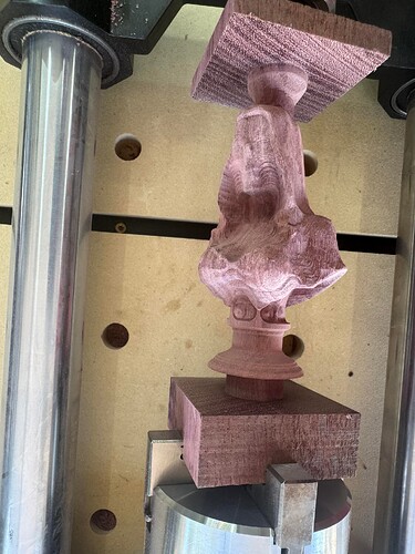

Did a sample air carve, and then just ran the job. Success on first try! Deskproto’s gcode breakdown looks very similar in action to a 3d printer, ie if it has separated islands of same depth to do while the A axis rotates, it breaks it into smaller areas, doing each separately, until the two merge again for full length passes, it is very orderly, and the simulations are spot on to actual action. It neatly stayed in its expected work area, never wandering, and gave great results.
 ![IMG_0724](https://us1.discourse-cdn.com/flex022/uploads/onefinitycnc/original/3X/1/2/1277663faebee7213bb06d5d530971fe01ff1031.jpeg)
 ![IMG_0728](https://us1.discourse-cdn.com/flex022/uploads/onefinitycnc/original/3X/3/f/3f695fe05266cc2d4141646a63dbac38a30f3aa2.jpeg)

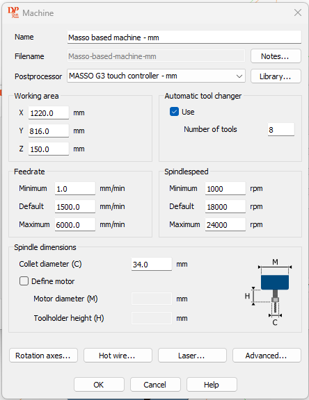

Next up is the Machine Lib. Note I’ll only show the tabs I changed over the default selection. Under Options→Library of Machines you should see this:
 ![Machine Lib 1](https://us1.discourse-cdn.com/flex022/uploads/onefinitycnc/original/3X/0/6/06f5b7dfbdefe967e6f12295a4bce7ecda58d0cb.png)
It should have your original choice of machine highlighted, I chose the metric version. Just choose Edit. Next up, the main page:
 ![Machine Lib 2](https://us1.discourse-cdn.com/flex022/uploads/onefinitycnc/original/3X/d/8/d8933139537296e9cbd9fb259e5fd24c14f3e60b.png)
I updated my working area items from defaults, and possibly feedrates. I definitly change spindlespeed and also updated collet to match the ones for my spindle.
 ![Machine Lib 3](https://us1.discourse-cdn.com/flex022/uploads/onefinitycnc/original/3X/f/4/f42735f666001c8e2b43a44e69132d12fb5c049f.png)
Lastly on advanced item, I only updated the correction factor. This gave me over 4 hours 1 min difference between the calculated times and actual.

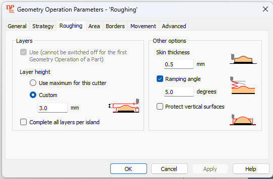

 ![rough3](https://us1.discourse-cdn.com/flex022/uploads/onefinitycnc/original/3X/e/a/ea82a802b24863aca9286a12590b721a6e0b91b2.png)
Under Layers, sub section, I chose custom 3mm. This sets the depth of cut for each roughing pass down to the remaining skin depth you choose. .5 or 1mm should do fine to leave most of the finishing done by the ball nose bit. I didn’t originally chose the ramping angle, but noticed that it will just plunge down your depth of cut to just start the pass, so I’ll be doing future with the ram set.

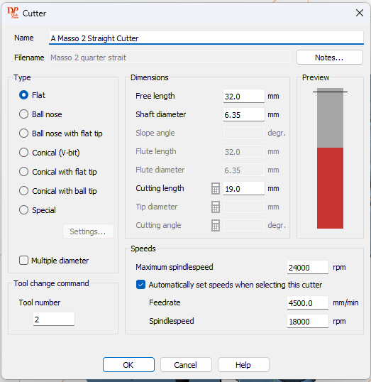

Just to quickly cover a cutter setup here is for my 1/4” downcut bit:
 ![ctr1](https://us1.discourse-cdn.com/flex022/uploads/onefinitycnc/original/3X/a/6/a61d994cc2ad91db4ee4642ffc5360bd221a27ed.png)
Important things to know for ATC is tool number, probably free length (the length extended beyond the spindle nut, and cutting length.

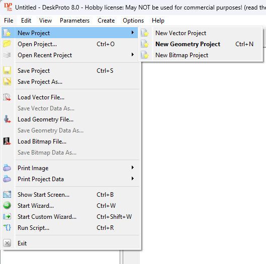

Lastly, I didn’t cover this first, to start a new project similar to mine, you would choose as below:
 ![image](https://us1.discourse-cdn.com/flex022/uploads/onefinitycnc/original/3X/b/e/be773def8b7bbd4e824f0f0aad01950d9012b833.png)
After that you can double click the Part to get the Part Paramaters, it is the second item in this list:

@greecher Thanks for the post man. I also want to carve statues and initially got VCarve and saw that Deskproto has the ability to index certain low areas on the same file. You mentioned under the veil needed more carving. I have the same interests for my carvings.
My question:
I carve along the Y, which VCarve is able to configure, but i haven’t figured out how to do this with Deskproto. I like to keep the rotary on the right side (along the Y) to still use the rest of the space next to home for other carvings.
Have you tried this out yet, or know how to go about it?
**Post date:** [April 15, 2026, 3:26am UTC](https://forum.onefinitycnc.com/t/software-hell-or-finding-what-works-for-revolution-long-post-deskproto/34896/14 "2026-04-15T03:26:24Z")
Have you looked at the DeskProto tutorial manual?
Straight from the manual:
The rotation axis on most machines is parallel to the X direction, and it is
officially called the A-axis. You can tell DeskProto that your machine has a
rotation axis by editing the machine definition in the Library of machines
(Options menu): Press button ”Rotation axes…” and in the Rotary machine
settings check “Has rotation axis”. On one side of the axis the rotary table’s
vise or chuck holds the block, often on the other side a tail-stock is available to
support its far end.
DeskProto also supports machines with the rotation axis parallel to Y. For such
machine you can check the option “Has 4th axis parallel to Y” in the Rotary
machine settings mentioned in the previous paragraph. This will make
DeskProto ‘swap’ the X and the Y on your machine. You will see a second
Orientator on your DeskProto screen, showing the orientation of the
coordinates on your ‘swapped’ machine. All user input needs to be done in the
DeskProto orientation, the NC output will be in your machine’s orientation.
This sounds complicated, however you will get used to it real soon. As always:
use the Help button for help
