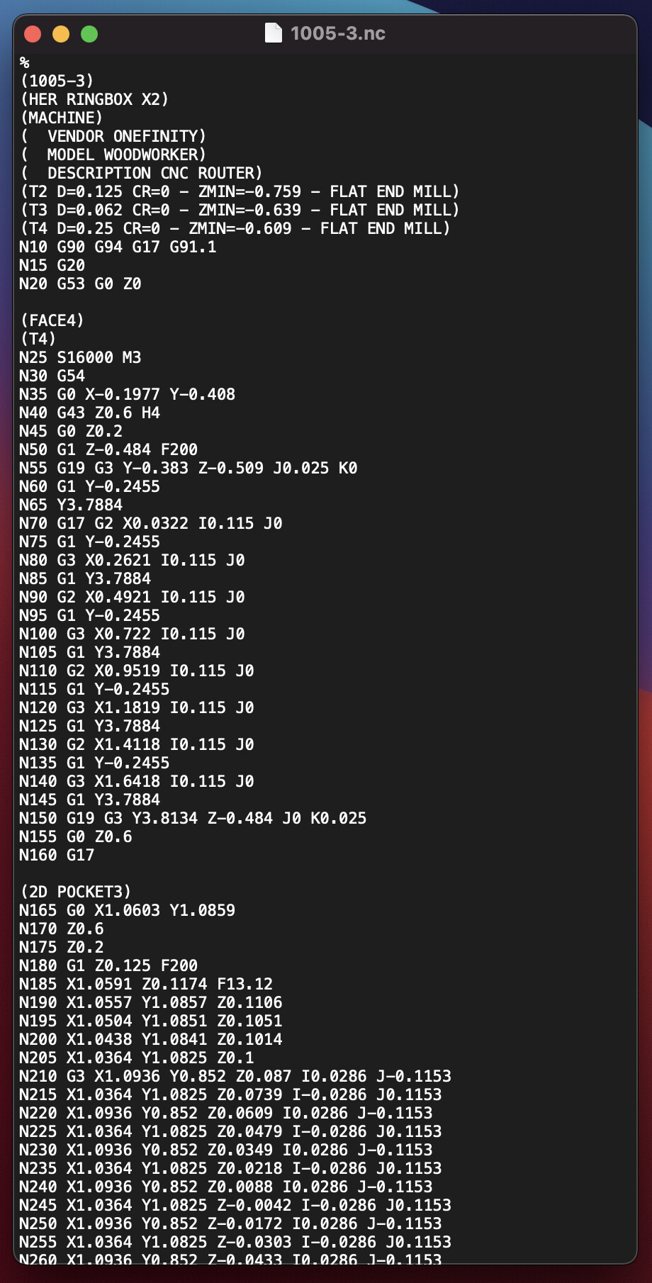

The thing that didn’t really sit right with me was that even though the controller indicates “under”, I still had more than enough travel in the z axis to complete the work… So I dug a little more. This lead me to find what I am calling “stacked” toolpaths.
It looks to me that path view (camotics?) is starting the Toolpaths for the next operation, after a tool change, at the horizontal plane of the previous operation. This is resulting in the unnecessary need for more Z depth. When I raise the workpiece, the correct product comes out, but again, the Z axis has the physical range to do operation.
 ![Screen Shot 2021-05-30 at 12.28.29 PM](https://us1.discourse-cdn.com/flex022/uploads/onefinitycnc/original/2X/1/17fcd6c88333933f957958b3460be7bfa61fb3f0.jpeg)
He is the setup: 2 parts in a single set-up, 4 operations, 3 tools, CNC controller v1.0.8. Below are screenshots of the parts and the first section of the G-code. I have included the G-code, because I suspect there is something I am doing wrong in Fusion 360.

You can see that though the tool is in contact with the wasteboard (bottom of project) the same status is not reflected in the path view.
What have I done in Fusion 360 to make Camotics and the Onefinity Controller space my toolpaths out vertically? Any thoughts?
Thank you for sticking with me until the end…
**Post date:** [May 30, 2021, 8:10pm UTC](https://forum.onefinitycnc.com/t/stacked-toolpaths-in-path-view-under/5843/2 "2021-05-30T20:10:42Z")
Separate the toolpaths into different files. It’s a bug/limitation in the software that adds each retract +
