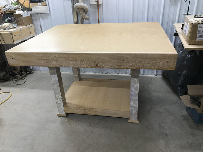

**Author:** ![Dustydave](https://sea2.discourse-cdn.com/flex022/user_avatar/forum.onefinitycnc.com/dustydave/32/1776_2.png) [@Dustydave](https://forum.onefinitycnc.com/u/Dustydave)\
**Post date:** [March 8, 2021, 4:38pm UTC](https://forum.onefinitycnc.com/t/the-table-basic/3787/52 "2021-03-08T16:38:18Z")
Some of you said no need to put a layer of marble in the table. So I put the table on marble columns😀. The table top is a torsion box with 1/2 ply on the bottom and 1.25 particle board with 1” mdf on top.
I am still thinking about adding something maybe a drawer (s) or a cabinet. Any ideas?
Can anyone guess what the wood wrapping the top and apron is ?
Table is 51” x62” and 39” high.
 ![image](https://us1.discourse-cdn.com/flex022/uploads/onefinitycnc/original/3X/b/2/b2775992f3a85ba50504d5e456013482d5bedfdf.jpeg) ![image](https://us1.discourse-cdn.com/flex022/uploads/onefinitycnc/original/3X/1/d/1d78ef7f450d1a49a71cc3f8dcb45c42505e6df1.jpeg)
