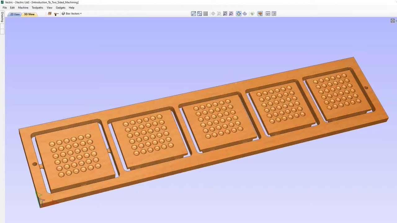

I do not use Vcarve but found a video from Vetric on the setup, looks like you need to use the same Z location for both sides based on your job setup of either material surface or machine bed.

**Post date:** [March 21, 2023, 5:08pm UTC](https://forum.onefinitycnc.com/t/two-sided-problem/19544/9 "2023-03-21T17:08:07Z")
ok so i viewed the tutorial it talks about setting the zero to different surfaces and somewhat explains each but this did not work for me i tried each configuration wen i set it to each one I get the perfect depth for one side then i flip the handle to the other side with the same depth settings and i carves all the way through to the other side i have I believe tride this on all three settings it does it correctly for the first side then it on the second side it carves again but all the way through to the other side of the material I need to know what in the ^&\*\* the reason for this is.
