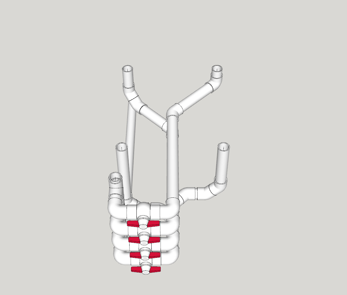

I’m going to go with 4 zones and I will be using the QCW with a vacuum hold down sealed plenum. The red is gasketing material. The yellow is the drilling pattern into the basic wasteboard (attach from above since we have accuracy). I’m going to use 2" schedule 40 pipe and fittings and vacuum gauges.
 ![image](https://us1.discourse-cdn.com/flex022/uploads/onefinitycnc/original/3X/a/b/ab47e4f1085c161617a3860dab9d10dfb667c3e1.png)
The standard sized wasteboards will have additional holes to attach the vacuum plenum (yellow areas) and there will be holes for the vacuum pipe and an area to do vertical milling on parts.
 ![image](https://us1.discourse-cdn.com/flex022/uploads/onefinitycnc/original/3X/5/c/5c8f6efbe2e9757faea426996c577244530851ed.png)
The plumbing uses 45 elbows where possible and are not glued to the wasteboards
 ![image](https://us1.discourse-cdn.com/flex022/uploads/onefinitycnc/original/3X/3/1/31c4905561d4f97d7618a5d850b134e1b231a506.png)
And here is the plumbing by itself
 ![image](https://us1.discourse-cdn.com/flex022/uploads/onefinitycnc/original/3X/e/6/e6064543d3efe68f9cf6d923240c72a94ca0ff1d.jpeg)
 ![image](https://us1.discourse-cdn.com/flex022/uploads/onefinitycnc/original/3X/5/a/5a2cdac3d47f38a501833eacb20fb9c4f0a3eb84.jpeg)
These are sketchup models that I made and I will provide users with them on request.

If you go with the Fein then you might consider 1.5" PVC pipe and fittings.
14 – 1.5" schedule 40 slip on 45 degree elbows - Eastman 48466
9 - 1.5" schedule 40 slip on 90 degree elbows - Eastman 48460
4 - 1.5" schedule 40 slip on Tees - Eastman 48451
4 – 1.5" schedule 40 slip ball valve - Eastman 20119
20 - feet schedule 40 straight pipe to fit - may be in 5 foot lengths (for easier shippping)
Also - make sure your connections are really well glued. Cycling full vacuum - no vacuum is hard on the glue joints.
Also do not starve the Fein vacuum with no air flow otherwise risk burning it out. The Fein comes with a twist valve on the hose connector - or provide a bleeder valve and use Vacuum gauges to watch vacuum values. We are about 1400 feet above sea level so we can’t get the hold down as you can at sea level. I’m just glad I’m not in the mile high city.

I’ve done some more research and I think I will try 1.5" pipe. It is much cleaner. I will try the Fein and purchase a second Fein vacuum if needed.
