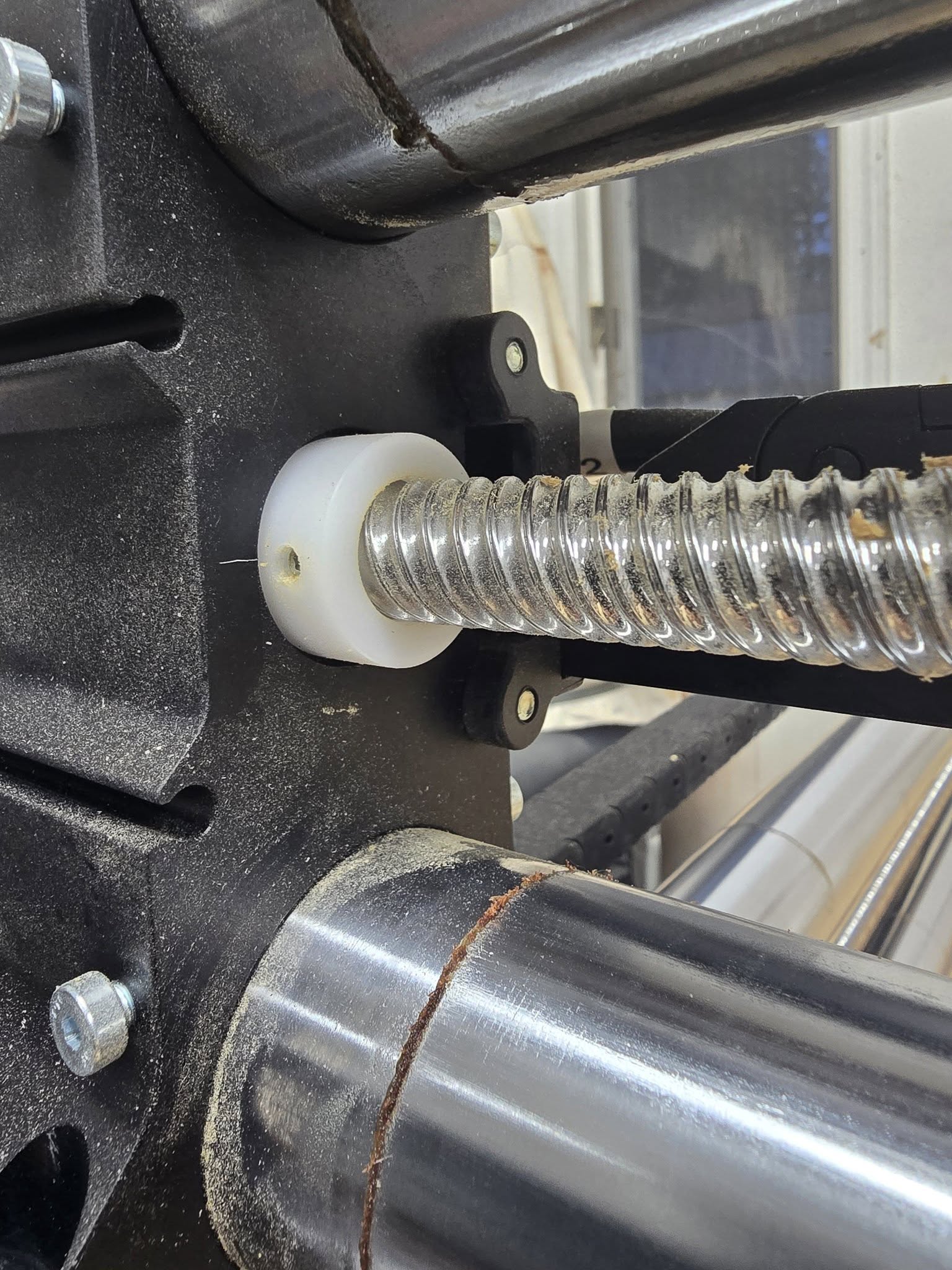

**Author:** ![Graffix](https://avatars.discourse-cdn.com/v4/letter/g/ecc23a/32.png) [@Graffix](https://forum.onefinitycnc.com/u/Graffix)\
**Post date:** [December 14, 2025, 3:16pm UTC](https://forum.onefinitycnc.com/t/vcarve-pocket-accuracy-for-inlays/36856/4 "2025-12-14T15:16:11Z")
![598581221_10232312393181078_3144001876832057861_n](https://us1.discourse-cdn.com/flex022/uploads/onefinitycnc/original/3X/f/c/fc9d17eef707343a4cd0349bd97f6f606cd198ae.jpeg)
I think you should home your machine. Load your file. Move to the center of your table. Try and stop where you can see the set screws clearly. Then zero X and Y, mark your x and y axis’s. Take a block of smooth hardwood and jog down to the top and zero your Z. then remove the wood. Make sure its just as thick or thicker than needed for the file you were cutting. Then run all of your files. Dont re-zero anything. After each file it should return x and y to zero. Check that theyre exactly where you marked them. Not even one click off. Send z to zero and check that with your block again. It should just slide under the bit again. If not you lost steps. Load the next file and let it run. Again it should go to zero when its done. Check them like before, then the last file. See if any of them are off. Again dont re zero once you start, dont change bits, dont cut material. Just let it cut air and go through the motions.

Thats what I have him checking essentially. That its moving exactly as intended. He already has a file that failed. Its good to use the same file at first to try a reproduce the error seen. Its a z axis error he mentioned. A pocket is not very z axis intensive operation he needs lots of up and down movements to test. So Id run that first. It may take a longer time but it changes the least amount from the first scenario. I made another file I could give him thats a pocket with v grooves in it. It takes 50min to run but its x y and z intensive.

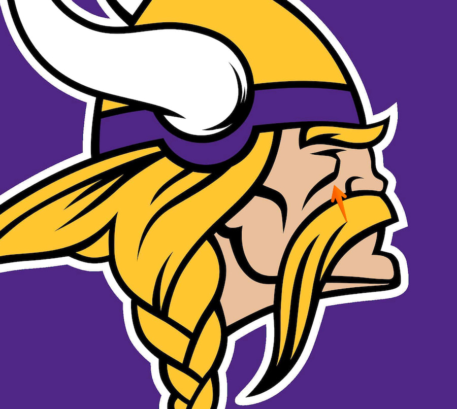

Thanks for the reply. TBH I haven’t used my machine as much as I’d like. I’ve had it set up for about 6 months but unfortunately there are other things in life that need to be done too ☹.
I’ll do the tests you suggest too.
The sharpest v-bit I have is 30 degree which should provide a good level of detail. That said there are parts of this logo that I don’t think event a 30 degree v-bit will be able to handle. Here’s the logo and part that I’m concerned about.
 ![Minnesota-Vikings](https://us1.discourse-cdn.com/flex022/uploads/onefinitycnc/original/3X/e/0/e059cf3f736de27cf57ec14872540ec4ecd7cc77.jpeg)
I will probably do some more testing with a 30 degree after this project and try to use the vcarve inlay toolpath for that.
