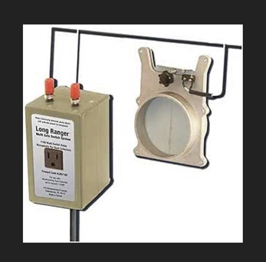

**Author:** ![RJensen](https://avatars.discourse-cdn.com/v4/letter/r/71e660/32.png) [@RJensen](https://forum.onefinitycnc.com/u/RJensen)\
**Post date:** [April 10, 2026, 9:28pm UTC](https://forum.onefinitycnc.com/t/want-ot-control-vacuums-pumps-and-other-things-with-your-redline/38052/21 "2026-04-10T21:28:16Z")
I currently have an old remote-control system from PSI Woodworking called the Long Ranger. It was designed for wired blast gates, which I have used in my shop for almost 15 years. It turned out I could connect it to Output 2 on the new IO port on the Redline controller, and I can toggle it with the M8 and M9 commands in my post-processor. I just ran two wires to the IO port and the two connections on the Long Ranger. Everything works great, but I want to upgrade to a 220v dust collector now PSI only sells a wireless version of the system, the Long Ranger III. I’d like to find a solution that supports my wired blast gates and the CNC controller. I guess PSI didn’t have much demand for a wired switch once they had a wireless version. This is the old unit I have:
 ![IMG_9524](https://us1.discourse-cdn.com/flex022/uploads/onefinitycnc/original/3X/1/0/10a1157c13c0a15619dfd0810cec9dfd6482d1bb.jpeg)
