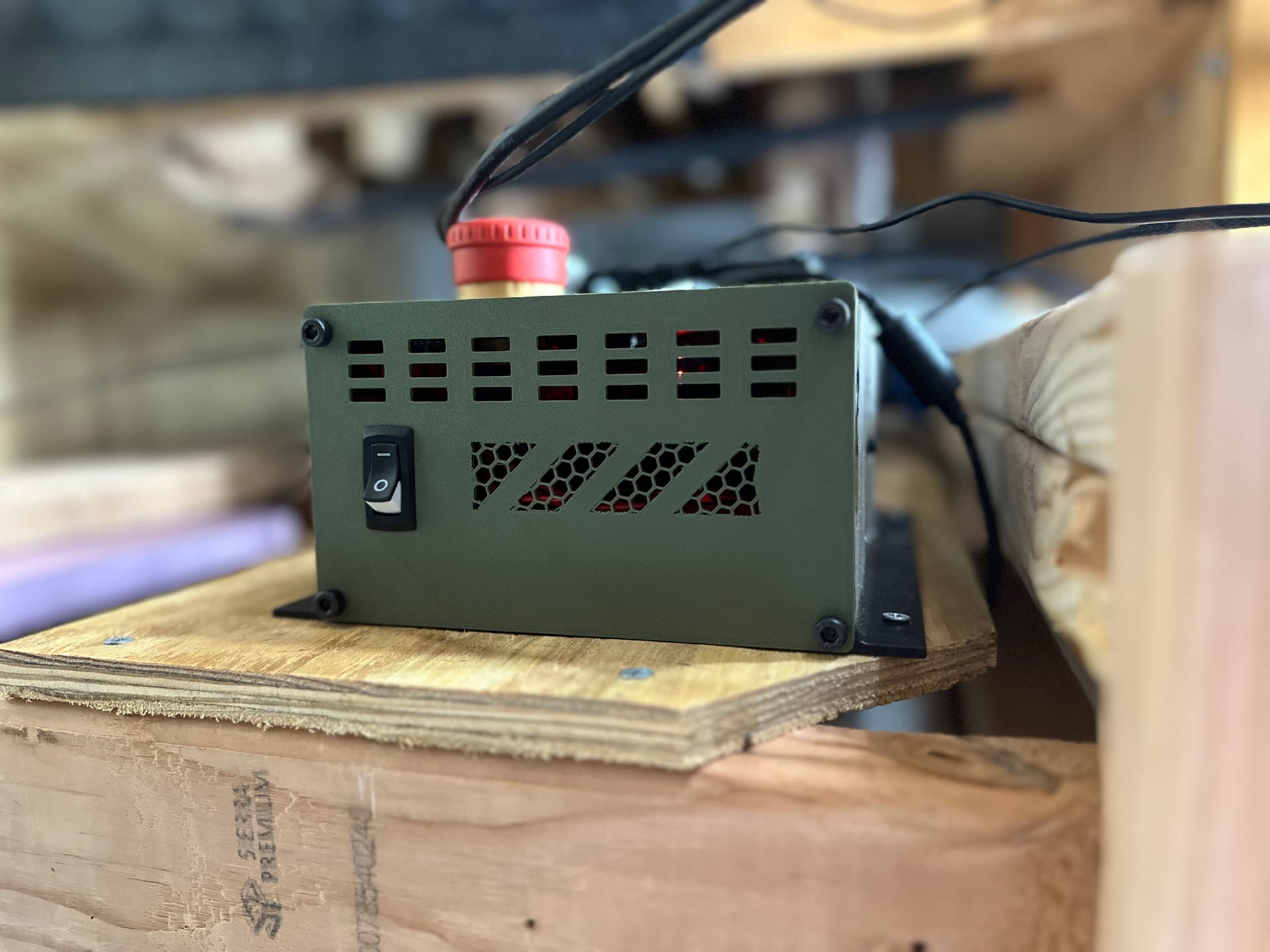

I also had this problem. Unable to get my WiFi to work even after bringing the control box into the house (known good WiFi).
I found a solution (Not for the faint of heart, nor long term).
First UNPLUG power. Then open the control box (aka faraday cage). I removed the 4 screws on the power switch side of the controller box. This allows the lid containing the emergency stop button, to slide out about 4 inches. Don’t pull too hard because of the wire connections to the E-Stop button. This exposes the Raspberry PI inside the controller box (#UnCageYourPI). Make sure the power switch leads are not touching anything metal before you plug the control box back in. When I powered mine back up, I was greeted with my SSID and a spanking new IP assigned to my Onefinity.
As I mentioned this is not a long term solution. However, I was able to use it to update my firmware over the web. I also will probably keep it open till I receive @garrett1812’s WiFi extender from Amazon. That will be a much better long term solution.
If you do this, you do it at your own risk without me being responsible. Please don’t use this advice to Fry your control box. Nor go touching the electronics inside. Remember when you plug it back in, electrical things will be exposed to damage and able to shock you and others by you. Not to mention that dust and other shop things can now get inside your control box.
I’m only sharing this to validate the root cause behind the problem. That plus for those of you who want a work around till you implement a better long term solution. So go ahead and order you an extender now … then get back out in the shop and play with your new Onefinity Toy.

**Post date:** [August 17, 2023, 4:44pm UTC](https://forum.onefinitycnc.com/t/wifi-connection-problems/1359/35 "2023-08-17T16:44:16Z")
I replaced the front metal cover with a plastic one, this was enough in my case to assure a stable Wi-Fi connection without using a USB dongle…

Care to share the 3d print file for that front plate?
**Author:** ![Tuvix72](https://sea2.discourse-cdn.com/flex022/user_avatar/forum.onefinitycnc.com/tuvix72/32/6176_2.png) [@Tuvix72](https://forum.onefinitycnc.com/u/Tuvix72)\
**Post date:** [November 25, 2025, 1:42am UTC](https://forum.onefinitycnc.com/t/wifi-connection-problems/1359/37 "2025-11-25T01:42:40Z")
Hey Ryan, it’s in the files section of the fb group or happy to email it to you.
