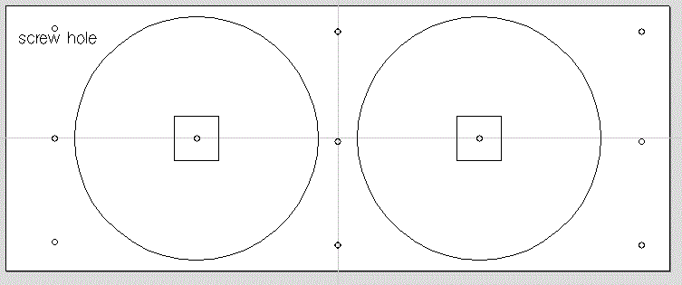

**Author:** ![ShamRocker](https://avatars.discourse-cdn.com/v4/letter/s/ea666f/32.png) [@ShamRocker](https://forum.onefinitycnc.com/u/ShamRocker)\
**Post date:** [February 7, 2021, 8:45pm UTC](https://forum.onefinitycnc.com/t/will-this-work/3346/6 "2021-02-07T20:45:59Z")
![clock](https://us1.discourse-cdn.com/flex022/uploads/onefinitycnc/original/2X/f/f59a26e998bb0c0c6ce288bf5d66186c3a3f04cd.gif)
I was thinking of something like this. Use cnc to make pilot holes where mounting screws go. Drill these on drill press. Screw workpiece to spoilboard. Use cnc to mill the pocket for the movement and the center hole. Flip the workpiece over and carve/laser the clock face.
**Author:** ![EdsCrafts](https://sea2.discourse-cdn.com/flex022/user_avatar/forum.onefinitycnc.com/edscrafts/32/1722_2.png) [@EdsCrafts](https://forum.onefinitycnc.com/u/EdsCrafts)\
**Post date:** [February 8, 2021, 2:19am UTC](https://forum.onefinitycnc.com/t/will-this-work/3346/7 "2021-02-08T02:19:17Z")
Ok how do I fill in the screw holes to where they are unseen for the finished product? The samples in my original image are the whole clock and drilling holes in their surface does not seem lit a quality product. Again sorry I am a very beginner wood worker with a lot to learn!

**Post date:** [February 8, 2021, 2:45am UTC](https://forum.onefinitycnc.com/t/will-this-work/3346/8 "2021-02-08T02:45:50Z")
What if you added extra material all around the edge then use @ShamRocker 's idea and put the screws in that perimeter material, then cut out the finished rectangle as a last step. You would not be able to put a screw in the middle with this method, but perhaps a tape/CA glue strip down the middle would take care of that. you could limit waste by choosing overall rectangle size carefully.
**Post date:** [February 8, 2021, 11:56am UTC](https://forum.onefinitycnc.com/t/will-this-work/3346/9 "2021-02-08T11:56:55Z")
Oh, I misunderstood. I didn’t realise there were multiple clock faces in a rectangle. I thought they were going to be cutout.
**Post date:** [February 8, 2021, 3:30pm UTC](https://forum.onefinitycnc.com/t/will-this-work/3346/10 "2021-02-08T15:30:34Z")
No worries, I did not explain well enough but thank you for your input.
